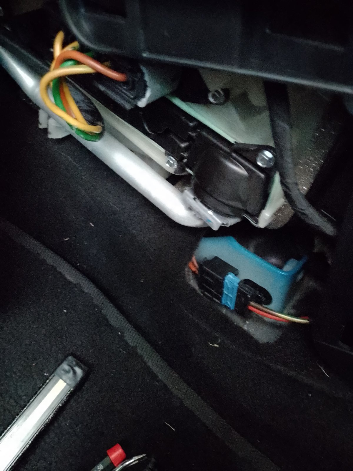

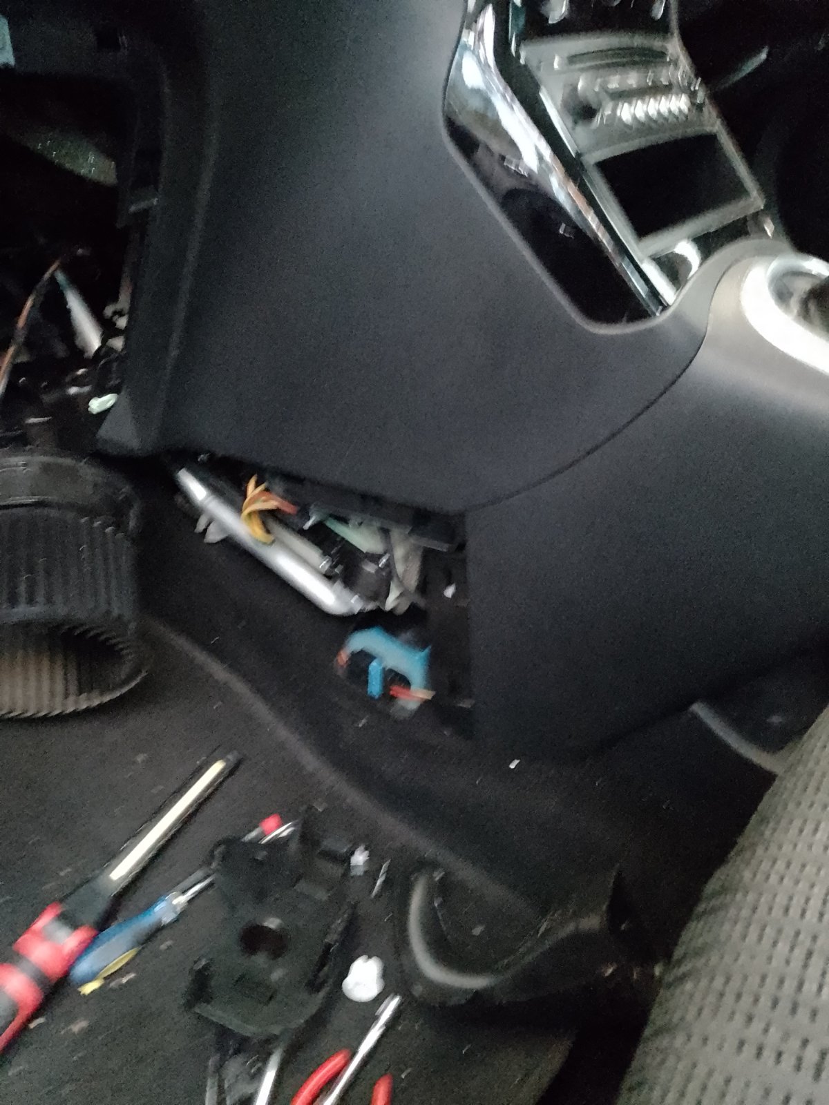

Hi,Blower Motor inside car went off.
Turned out wiring at side of heater box melted.
Try this first before you take glove box out etc to get to motor.
If you take passenger side heater box plastic cover off,2 trim clips holding it on,you will see a block connector with red&brown wire just above carpet.
Flick clip out& turn plug round to face you & undo.It will be burnt inside.
Either clean up or hard wire(cut plug&solder together)for good connection.
Just wanted to put this on here as forum has helped me a lot.Thanks :-D

Thank you, your solution saved me many hours of work and was exactly for the same problem.

Could anyone tell me how the plug and socket come apart please? Does the blue bit it the middle come off? Thanks
