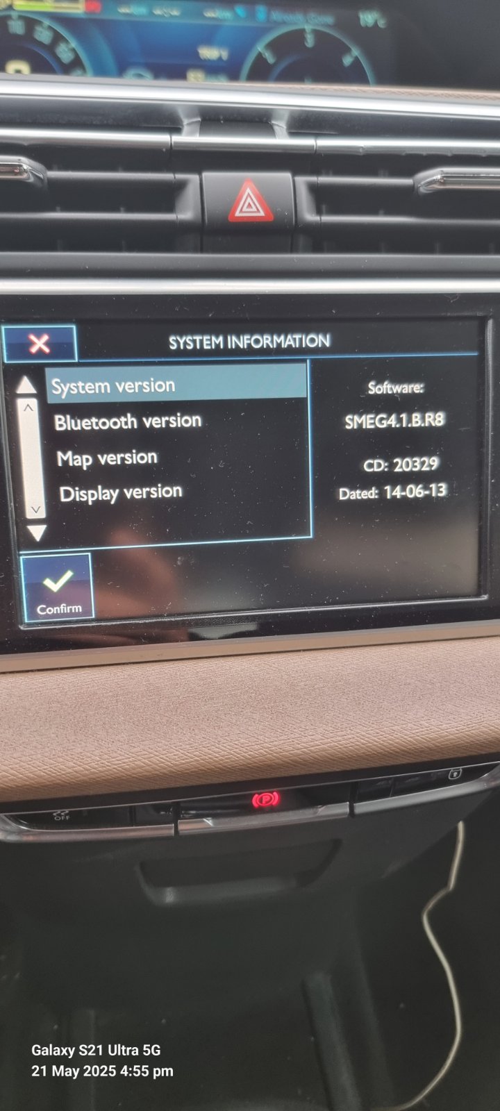

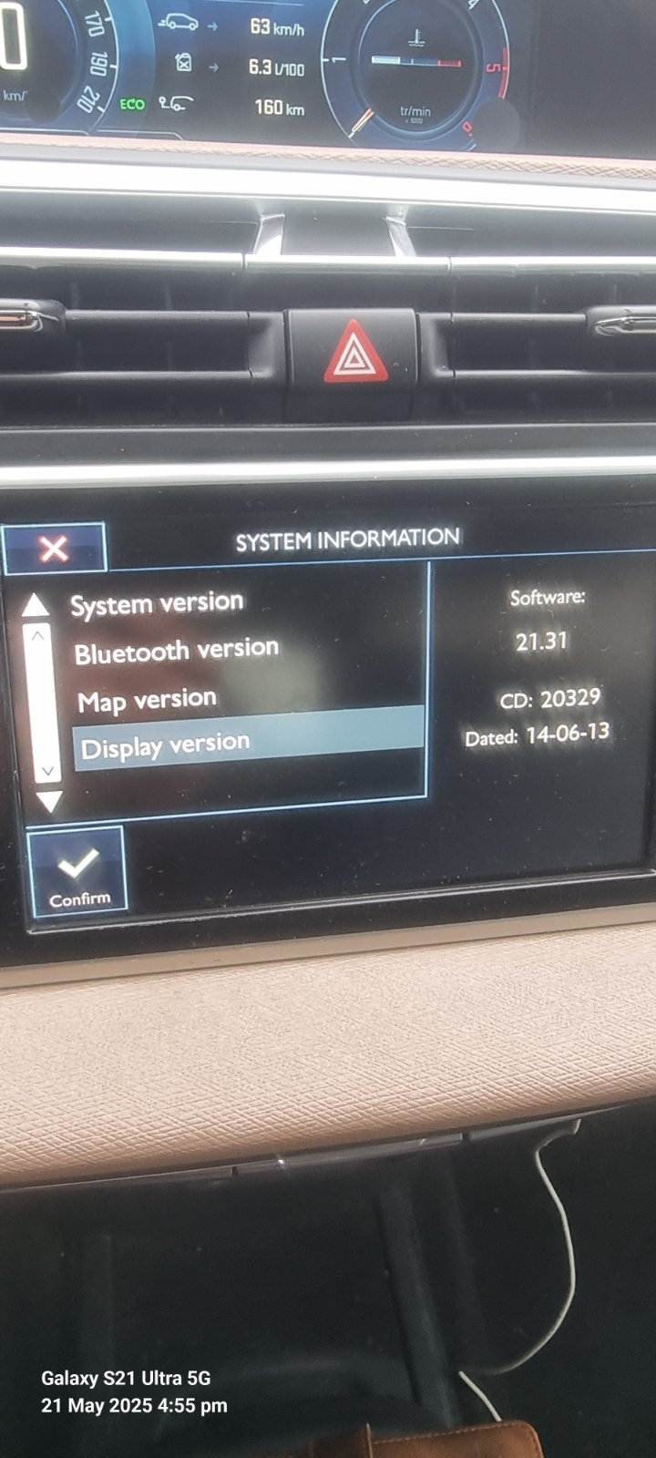

Hi all, Please help. No matter what I seam to do, my picasso 2 2013 will not read the usb pen drive with software/firmware upgrade, the sat nav says no files for this route, i live in france and it is a french car, how can't it have france maps? Also it reboots at least once every trip, and it's driving me crazy, closest it has come to loading is, no music found on drive. Car has original software/firmware. Pictures attached.

Hi, Thanks for reply. I've tried 3 different pen drives I'm now on a 4gb, it is fat32 ,yes I'm using windows computer, I want to update firmware and maps, it looks like 2013 original setup, it's very slow, but can't navigate anywhere at all, the only thing it has done is say there are no music files on this drive, which is kind of progress but not what I need.

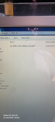

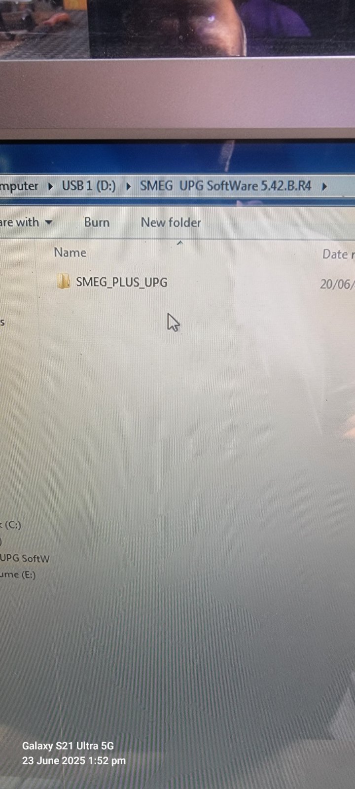

Sorry missed the contents of pen drive, ive have had every combination of contents i can think of, full zipped download, unzipped download showing folder of contents, then folder saying smeg upg

Screen shot really needed.

Anyway, back to your problem. As I said above the rebooting may be a sign of the unit failing. You didn't say whether it's worse in the summer compared to winter.

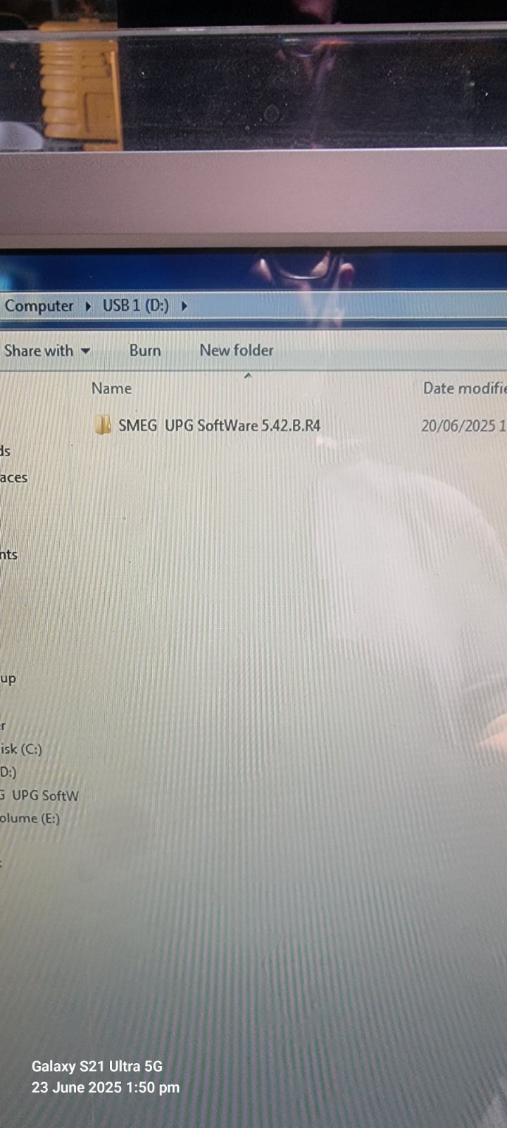

Looking at the two photos you posted it looks to me like you copied the firmware folder over including the folder it was within. I haven't done any updating of firmware but I think that the folder SMEG_PLUS_UPG should be in the root of the pen drive. However...
You're updating from a very early version indeed. Unless you're having any problems I would suggest updating your maps first to see how that goes and then update the firmware later if need be. And I wouldn't go for the most modern firmware first either, I think I would go to to the earliest available which is SMEG_5.4.B.R6.
I will send you a PM soon with a link to a post with both map and firmware updates. As the first post says, do NOT follow the links in the PDF, they are out of date. It's not my PDF and I can't update it so follow the links in the post itself. The PDF is still valid for the process involved though.
Don't try to update both maps and firmware at the same time. It will not work.

Thanks paul, very much appreciated, as for the car being worse in summer, I wouldn't know ive only owned it for 2 months, everything to do with the unit is incredibly slow, it plays the radio OK, it plays music via iPhone ok, but switching between say the radio and satnav is sometimes 2 mins before it happens, the satnav does not do anything anyway other than think about it, so everything other than satnav works, when it loads. Thank you.
