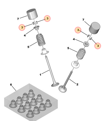

If anyone is able to point me to the part number for the collets I'd appreciate it. I can't find that one that I dropped.
- x 6955
Re: 208 1.2 petrol wont rev over idle
Guys - if you are requesting parts, please use the official thread as I may not see your request elsewhere unless I read through every post - and I don't have time for that:
Official Parts Request Thread
(3) Valve Half Cone, part: 9816171280, £3.48
