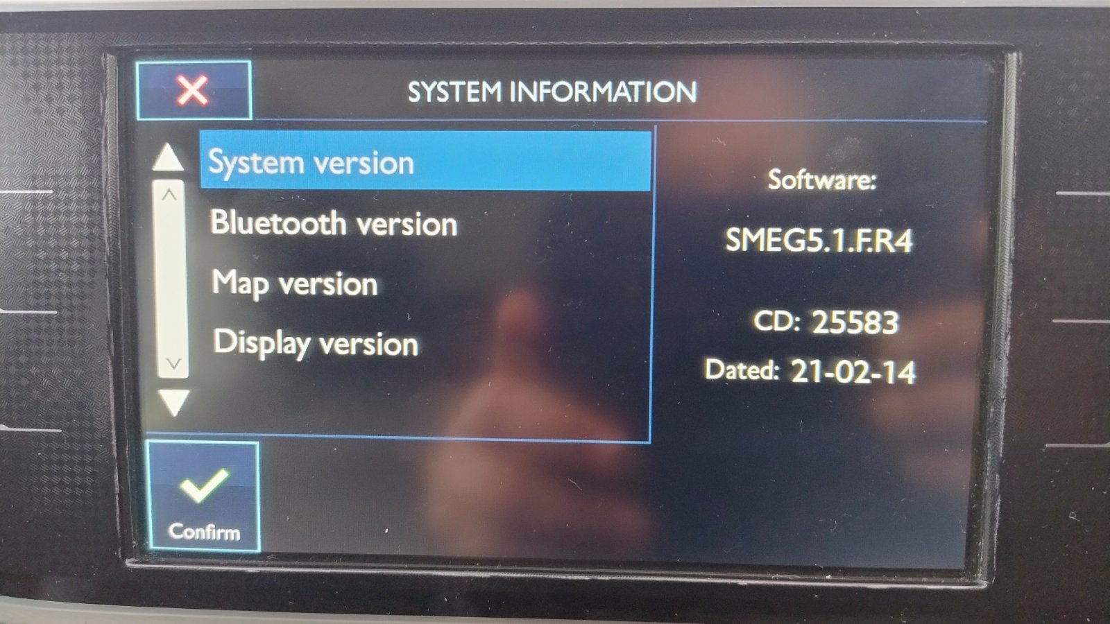

Software update of what? You probably mean for the head unit (radio/satnav) but could you confirm? Also, photos of the screen would help immensely.

Yes the heat unit software. Here are pics I took off the software versions installed.

Yes, it looks like both the firmware and the maps are original. Unless you're having problems I would caution against updating the firmware as there is a risk, albeit slight, of bricking the system. I will send you a PM regarding the maps. It may be tomorrow as I might not have time tonight.

Re: 2014 C4 grand picasso software updates
You want to look for the SMEG+ 5.43r2 firmware update. It's a simple download and unzip on a USB, for free, fast and easy. I actually very recommend updating to it as it's improving responses time and reliability quite the bit.
