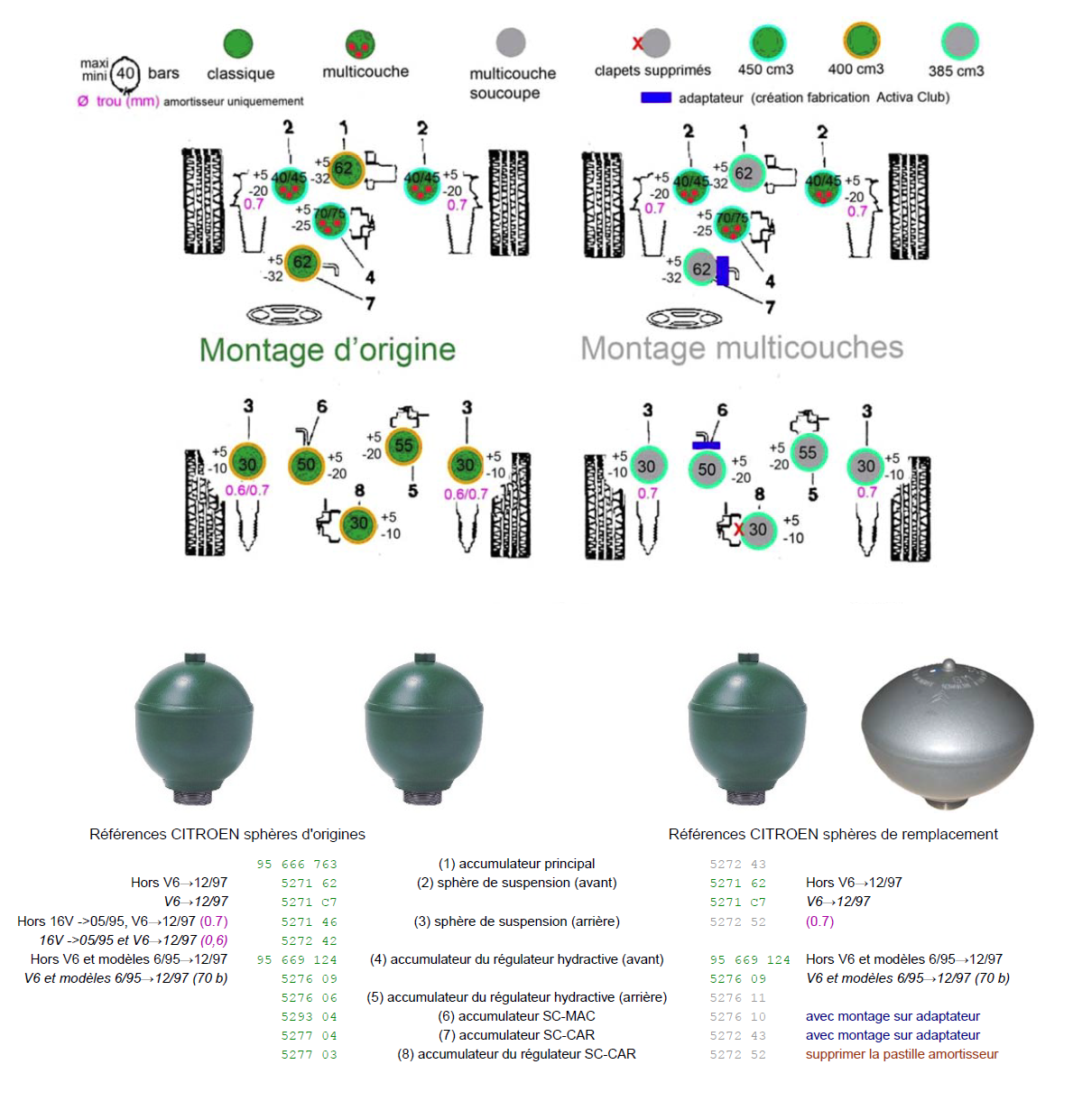

You can just use a C5 or C6 sphere like the 70 bar center sphere from C5 or the 60 bar from a, C6 Amvar.
- Posts: 54804
- x 8202
Re: Activa sinking left side after a right turn at speed
You can substitute an 'Anti-Sink' sphere for the Activa Accumulator Fernando - they are a little down on pressure (45 bars) but will work well enough.
- Posts: 10869
- Joined: 09 Nov 2005, 22:03
- x 1423
Do those have the female threaded hole for the hydraulic pipe?Kees wrote: 28 May 2025, 21:07 You can just use a C5 or C6 sphere like the 70 bar center sphere from C5 or the 60 bar from a, C6 Amvar.
Sorry, no.
I was thinking just about a accumulator.
- Posts: 54804
- x 8202
I'm wondering if there's space for a C5 mushroom. It's all a bit tight down there in a TCT...
- Posts: 11769
- Joined: 28 Mar 2013, 21:05
- x 1983
[/quote]
Where they can and cannot be used.....dark purple shows where the adaptors are needed.
