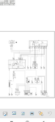

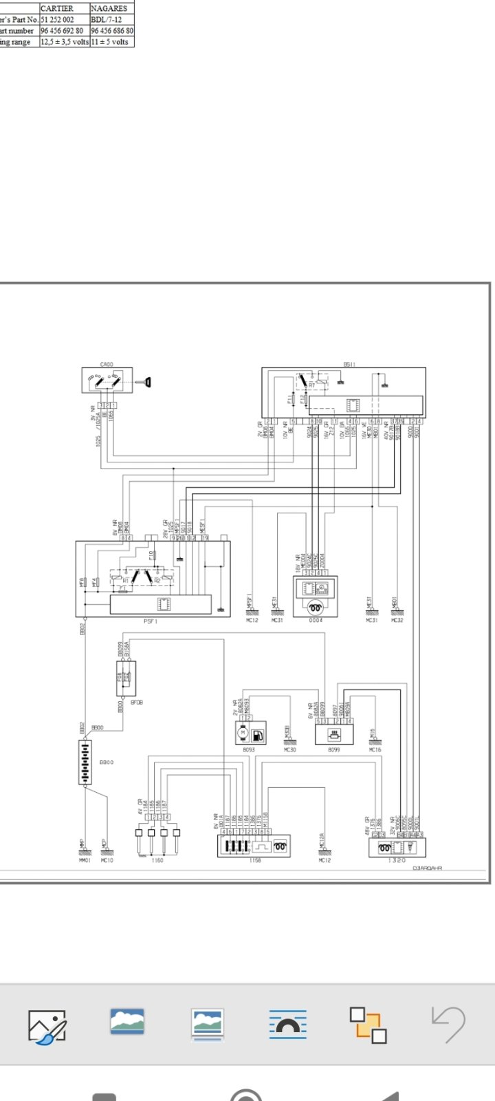

darbuck wrote: 24 May 2025, 09:35 Has anyone any tips on testing the relays themselves
Yes, have a look at the wiring diagram and if you can replicate the control signal(s) and any other needed conditions then a bench test is potentially possible...
Do you have the relevant wiring diagrams Darren? If you do, if I could see them it may help me answer the above question a bit more fully...

Hi Jim I will root them out for you

Hi Jim, I think this is what you are after.

Thanks Darren, I'll take a look in a bit :)
