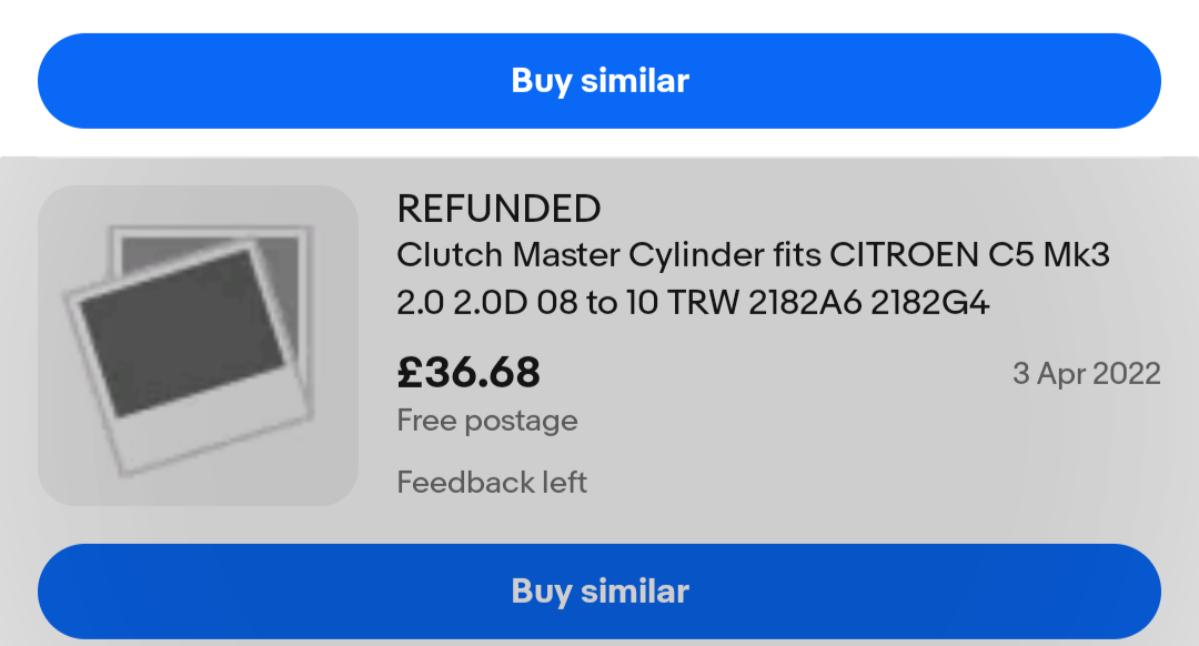

First one I bought was TRW, but never fitted as had the 90° connection issue:
90° wrong
90° wrong

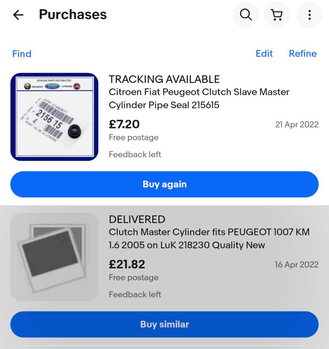

This is the one I bought that "looked right" and as it turned out fitted and functioned fine:
Also captured: the silly seal I lost
