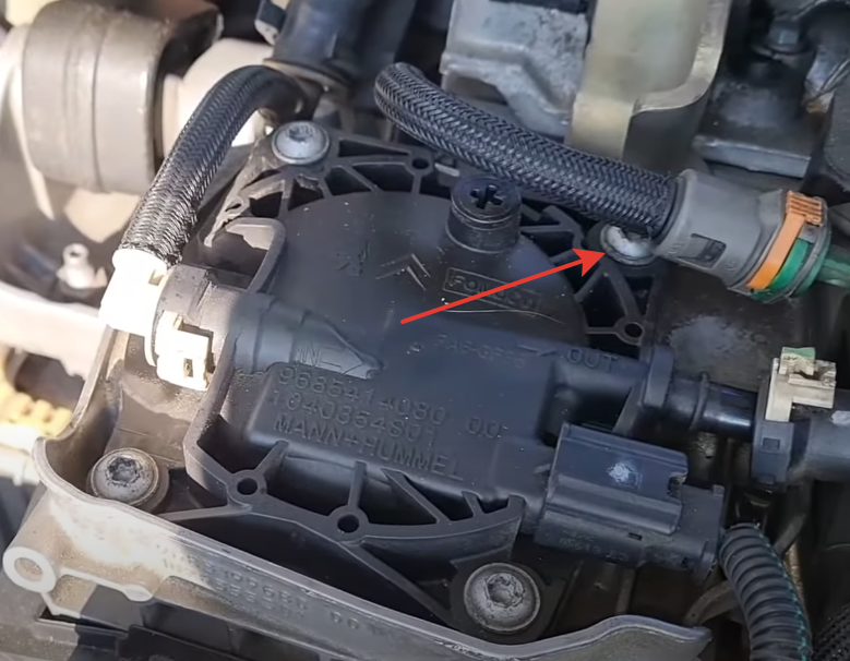

Re: Sudden Stop
Ok guys we had a loosen screw problem. One of the screw could not be tightened into the screw slot. I didn't think it would be such a problem. The problem seems to be solved, at least for now.
wurlycorner
- Posts: 2194
- Joined: 30 Oct 2012, 22:37
- x 272
Re: Sudden Stop
Glad to hear it’s sorted. Screw into where?
