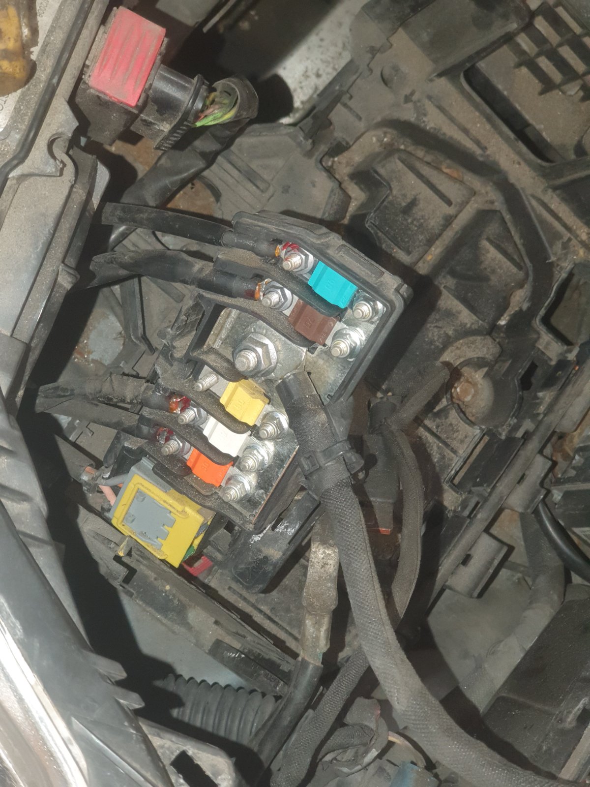

I'm also wondering if the engine ecu is getting too hot. The radiator fan is not working. I've actually just removed it to look and it's quite rusty on the motor housing.
I was not sure which one is the fuse for the fan. The yellow midi fuse 60A in the extra fuse box beside the battery as far as I can find but this looks like it is the only one without a connection to anything.

This yellow fuse is supposedly the fan?
I see no terminal connection from it

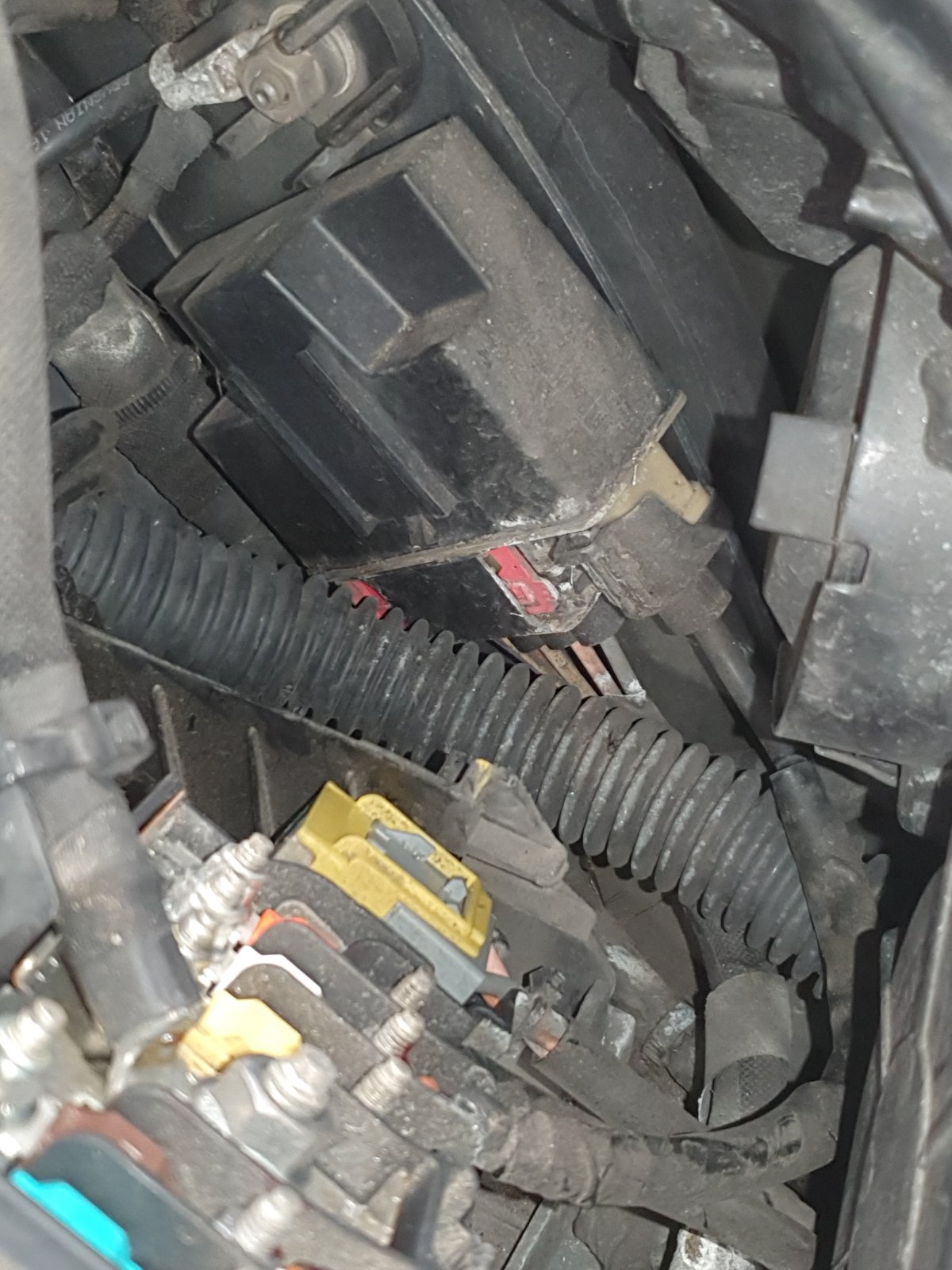

Oh, anyone know what this large relay is for? It appears to have a damaged cover exposing the relay.
It's supplied from the white 80A fuse, it's on the inner wing next to the battery

If that big relay is to do with the fuel pump I doubt it would enjoy getting damp.

Big relay box:
On older Peugeot/Citroen that sort of size housed the glow plug relay - not sure if the C5 uses the same or it's done differently on a more modern HDI. But would not expect to the lead to konking out at idle , on a warm day, either.

Big relay box:

I've seen this referred to as 'protection relays' but not sure exactly what they are. 80A is quite a large current to deal with.aerodynamica wrote: 16 May 2025, 17:52 Oh, anyone know what this large relay is for? It appears to have a damaged cover exposing the relay.
