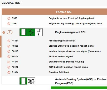

I performed as many actuator tests as I could find using Diagbox and everything is sounding out, although the electronic whir from the EGR doesn't sound great, it does click (I am in process of removing this for a visual check of actuator moving.

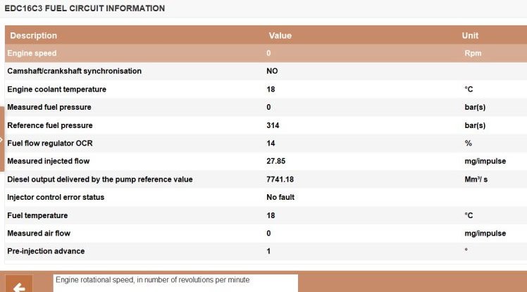

Without being able to get it to idling I haven't been able to collect any good data about the fueling, the cam and crank sensors synchronise, the fuel pressure while in ignition seems ok.

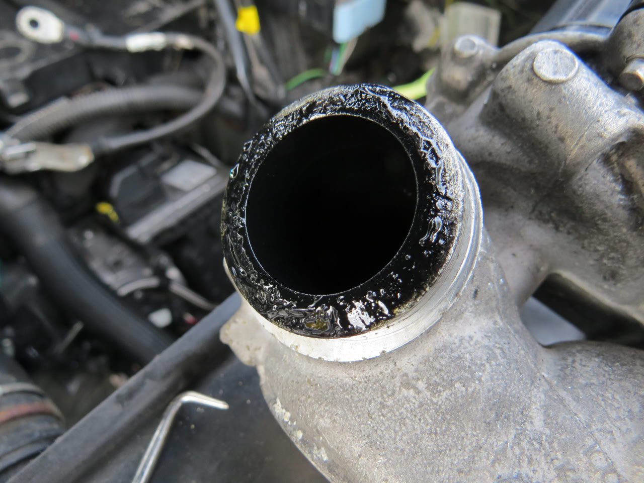

Re: Citroen C4GP 1.6 HDi: Crank > rough start, choppy revs > white smoke from engine bay > cuts out
New part that I had just installed already coated in sludge from the few attempts at starting. I am going to start dismantling the EGR system to see if the cooler is damaged.

I've also noticed that while I have been using Diagbox, what I suspect to be the fuel injection pump continues to make a buzzy whir, unlike I have noticed before. I thought it only would run for a moment upon ignition on and after stopping the vehicle. While I was connected to Diagbox it ran continuously which I thought might be odd.

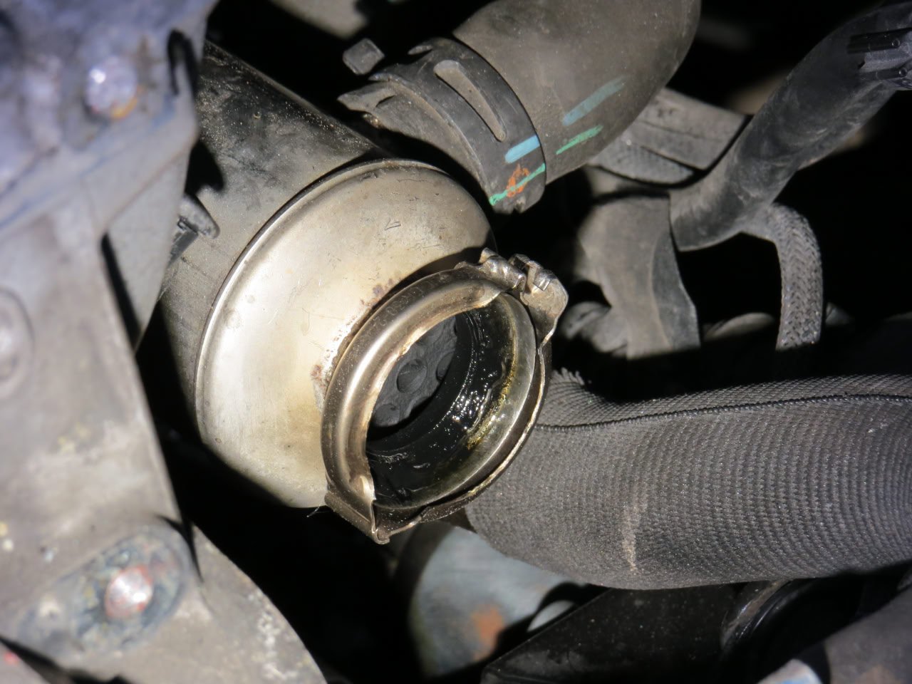

Does anyone know what this port connects to? Does it connect with the EGR somehow? It is a fifth port on the exhaust manifold, I had oil coming out of the bolt holes.

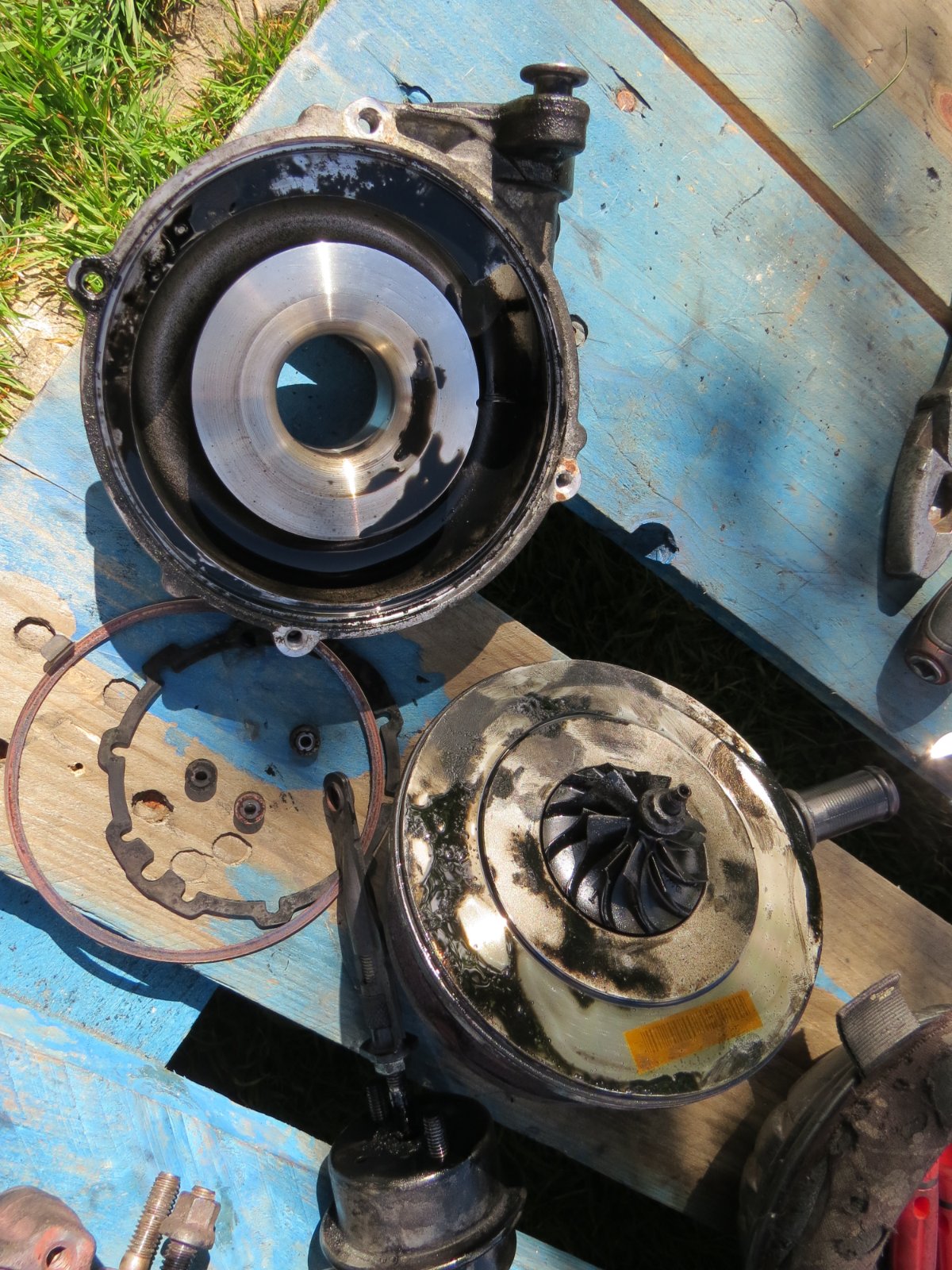

Dismantled turbo today to find completely dry oil return line. The banjo bolt at the top looks normal, although there was quite a bit of play in the feed pipe even when tightened up. I assumed this was normal. Will be dismantling turbo for a inspection/rebuild.

To try to answer my own question, I think that port might connect to the EGR port on the backside of the motor. Why I have so much oil in those threads is still a mystery.
Upon pulling apart the turbo, I see why my oil drain pipe is dry. Bear in mind this system had been checked by myself and two mechanics and the trace amounts of oil in the intake system were being blamed on the PCV (which needed replacing along with the O ring on the turbo pipe). Unfortunately my oil dip stick broke last November and I have been holding in good faith that the oil has been good since having the oil changed out in December. Now I am wondering what the inside of the sump looks like, I found chunks of gunk mixed with the oil inside the turbo housing. The screens had been removed from the banjo bolts but it looks like the seals gone on the cartridge.
