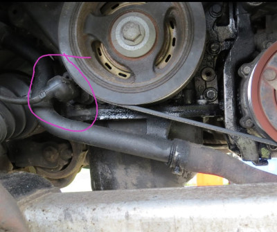

You could check the camshaft sensor (on backside behind the inlet side of the manifold, it was hard to get to on mine I had to remove wipers ans scuttles), crankshaft sensor (beside crank pulley, see image), I inspected my fuel rail sensor as well because I had the gearbox removed and thought it might be damaged. So far none of these seem to be the cause of my problem, I am messing with the EGR now since it is a pretty crappy knock off.
Crank sensor:
Crank sensor:
