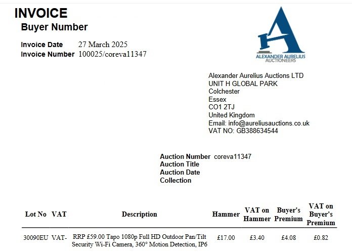

Up until now I don't think I have mentioned a saga that has been unwinding for a few weeks!! So here's my chance to bore you all completely!! :-D
At the end of March I spotted a decent quality Pan and Tilt camera in an auction. I know they retail in the £50-70 bracket and it had a £15 bid on it. I threw a £17 bid on and lo and behold I won it!!:
MTMO - the purchase invoice
The camera arrived with a couple of other lots I had won and I set about configuring it. As ever with auctions you always buy blind with no comeback and sometimes you win and sometimes you don't - it's part of the fun!!
On this occasion the other two lots, the primary reason for me bidding in this sale, both were perfect so my total expenditure of £52 was well rewarded with those combined RRPs of £140ish so when I discovered the camera was faulty I was not unduly concerned.
