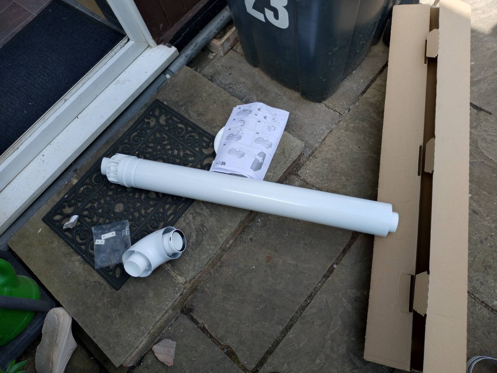

After a while he came to tell me that there was a CO leak from the flue which appeared to be the 'through the wall' pipe corroded so I immediately said we'll replace it. A trip to A10 Boiler Spares in Cheshunt followed to collect a new flue:
We swapped out the entire flue to remove that problem:
Having finished with the boiler my man then serviced the gas hob and gas fire as well as checking flow rates and pressures throughout our system. The gas fire flue, the original chimney, has excellent draught and all was pronounced fully fit for purpose!!
After completion I went upstairs to test the new hot flow and I was delighted to find, as expected, the hot tap on full remained hot and filled the bath in a few minutes as opposed to the 10-15 it had been taking. SWMBO even found she had to add cold last night for the first time in months!!

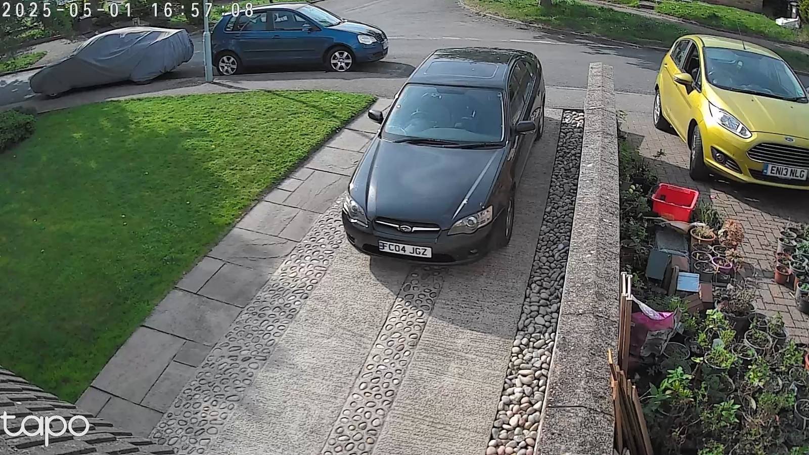

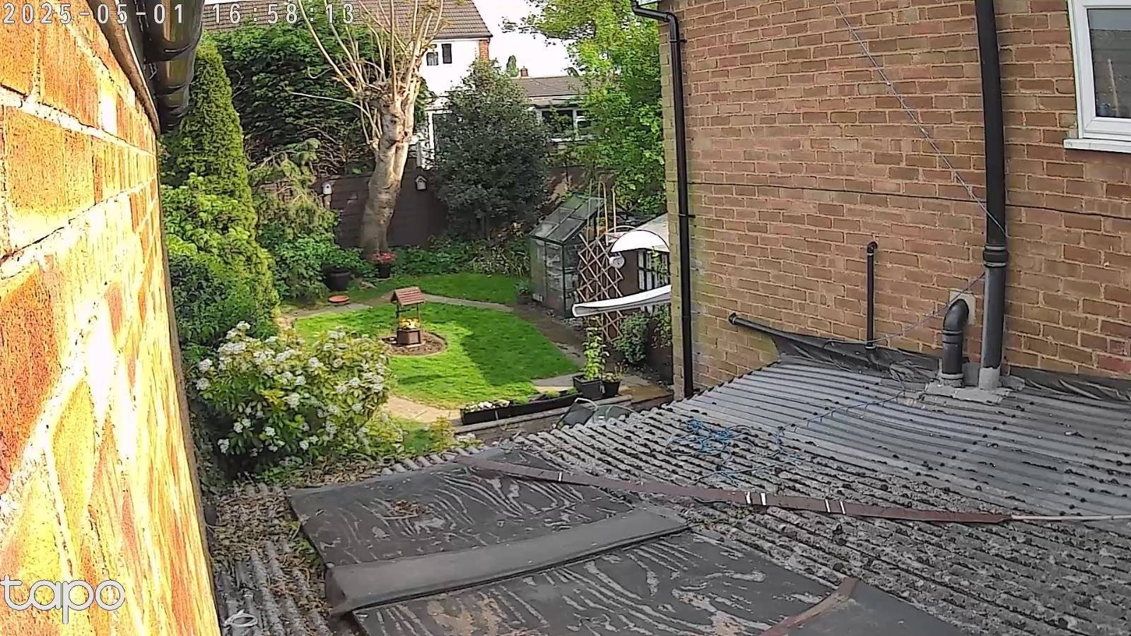

The reason I wanted another camera was to see if I could confirm my theory that our foxes were gaining access to our garden over the garage roof and down our waterfall. Our existing cameras tend to indicate that from the directions of their arrivals and departures but I wanted proof.
So the next issue was where would be the best place to mount my new cheapie to cover that area?
I decided that the best place would be on the top corner of our neighbour's garage circled in yellow in the picture above.
So last night, having cleared it with our neighbour, I installed the camera and checked out the available views:
All looks good so this morning I had a look to see what I had captured:
Worth checking out my videos I thought:
So proof for SWMBO who simply didn't believe me!! (Now you know why I did it
