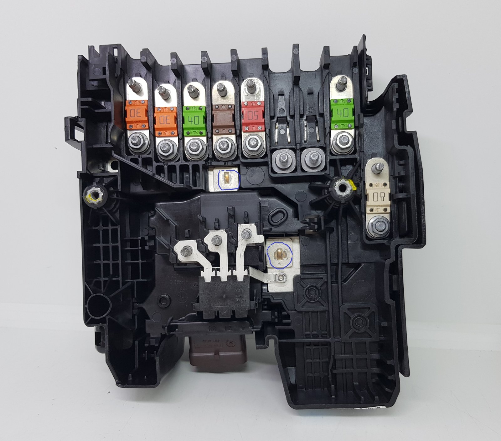

I would like to add about BPGA. It's an assembly that mostly doesn't have electronics, but they mostly fail due to a factory design error. In the attached picture there is one correct new part but these framed parts are potentially destined to be damaged. There is a transition between the two sides that should have been the same with a screw that makes a permanent connection. When the contact breaks over time due to vibrations and other things, then the whole part has to be changed.
