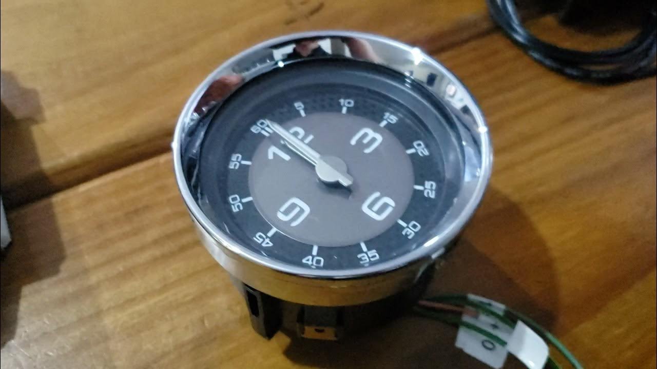

wheeler wrote: 26 Apr 2025, 13:13 Seems a bit overkill for a clock that only tells the time? Do you have a link to the item to see what you have?
You can generally tap into the CAN anywhere at any of the ECU's connected to it.
I agree but it looks "classy"
It has 4 wires, battery + and - . Can high and low.
I have taken the connections from the head unit side of the stereo Fakra connection.
Getting .5v on the low and 4.5v on the high (don't know the significance of that)
The clock is receiving something on the CAN bus, as the lighting dims when the lights come on.
Ta
Mike
wheeler
Posts: 7930
Joined: 21 Sep 2002, 19:07
x 1055
Re: CAN bus Tap In
Unread post by wheeler »
Sounds OK, the theoretical value of the CAN should be 2.5v each but as long as both add up to 5v it should be fine.
The fact that the lights on it dim when the lights are switched on suggest it probable has a good connection to the CAN.
Are you sure there is no way to set the time? what do the instructions say?
