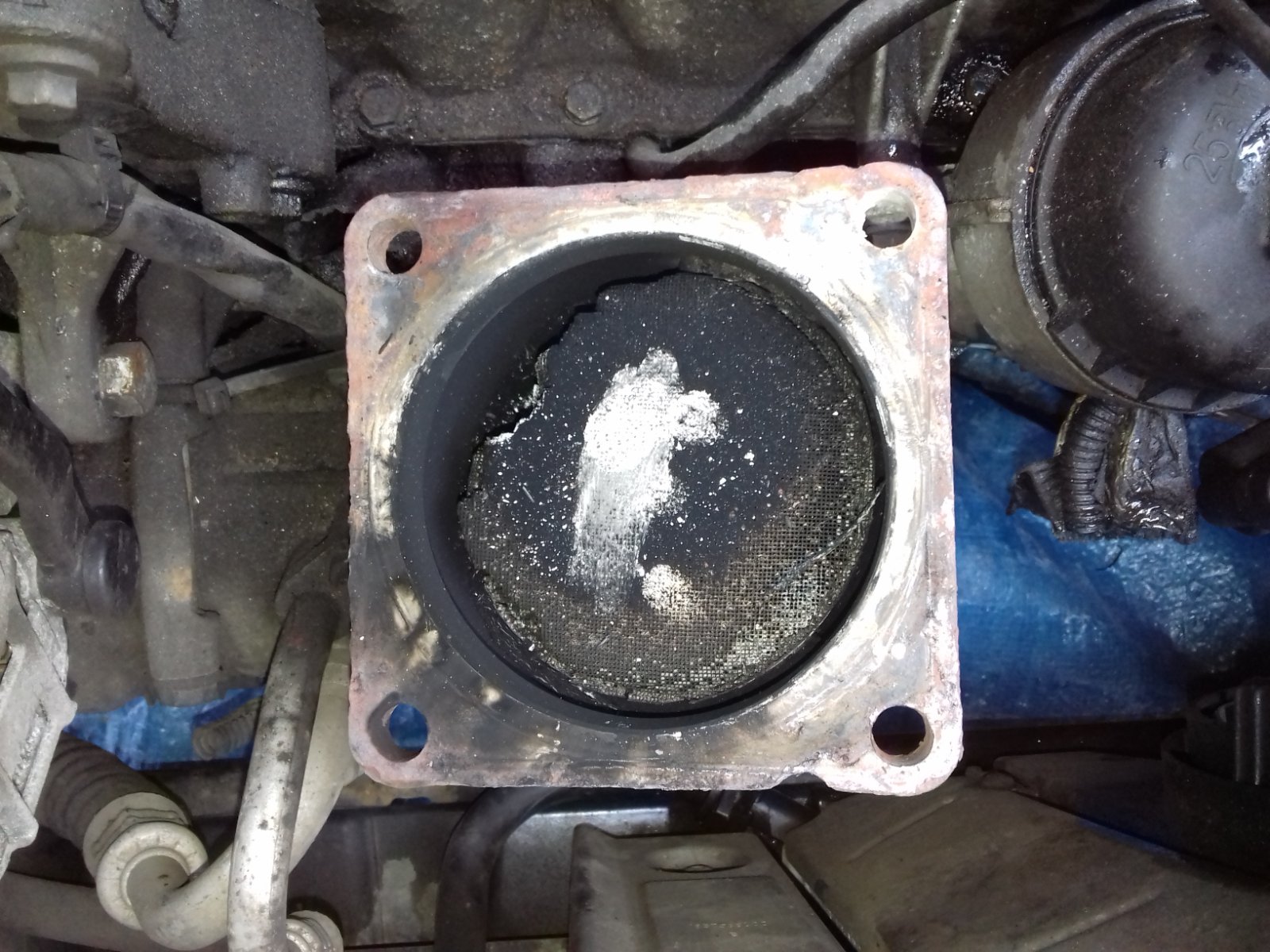

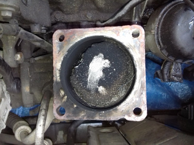

This is the blocked catalytic converter. You can see where it was blowing in the upper right hand corner. I managed to clean this one by removing the catalytic converter and then soaking it in a bucket of soapy water over night and it came out lovely and clean.

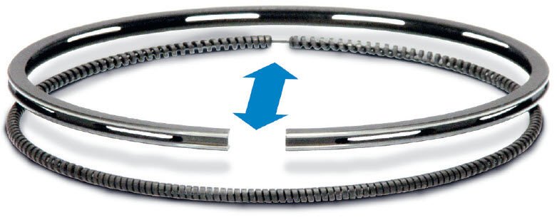

This is what the rings look like on these engines,
They are a 2-piece oil control ring which has a spring type metal expander in the middle. The rings were not stuck solid in the piston ring grooves but there was a lot of crud in the grooves. The main problem was that the spring type expander was blocked up solid with carbon and so there was nowhere for the oil to flow through the slots in the ring and back into the sump.

Thank you for the pictures. Have to say I am surprised that catalyst lives to fight another day (looks fit for scrap pile in that picture - glad to be proved wrong based on appearances!)

The catalytic converter looks terminal. But good job in getting it working again. Seems like it was blowing past the gasket in the bottom left hand corner.
