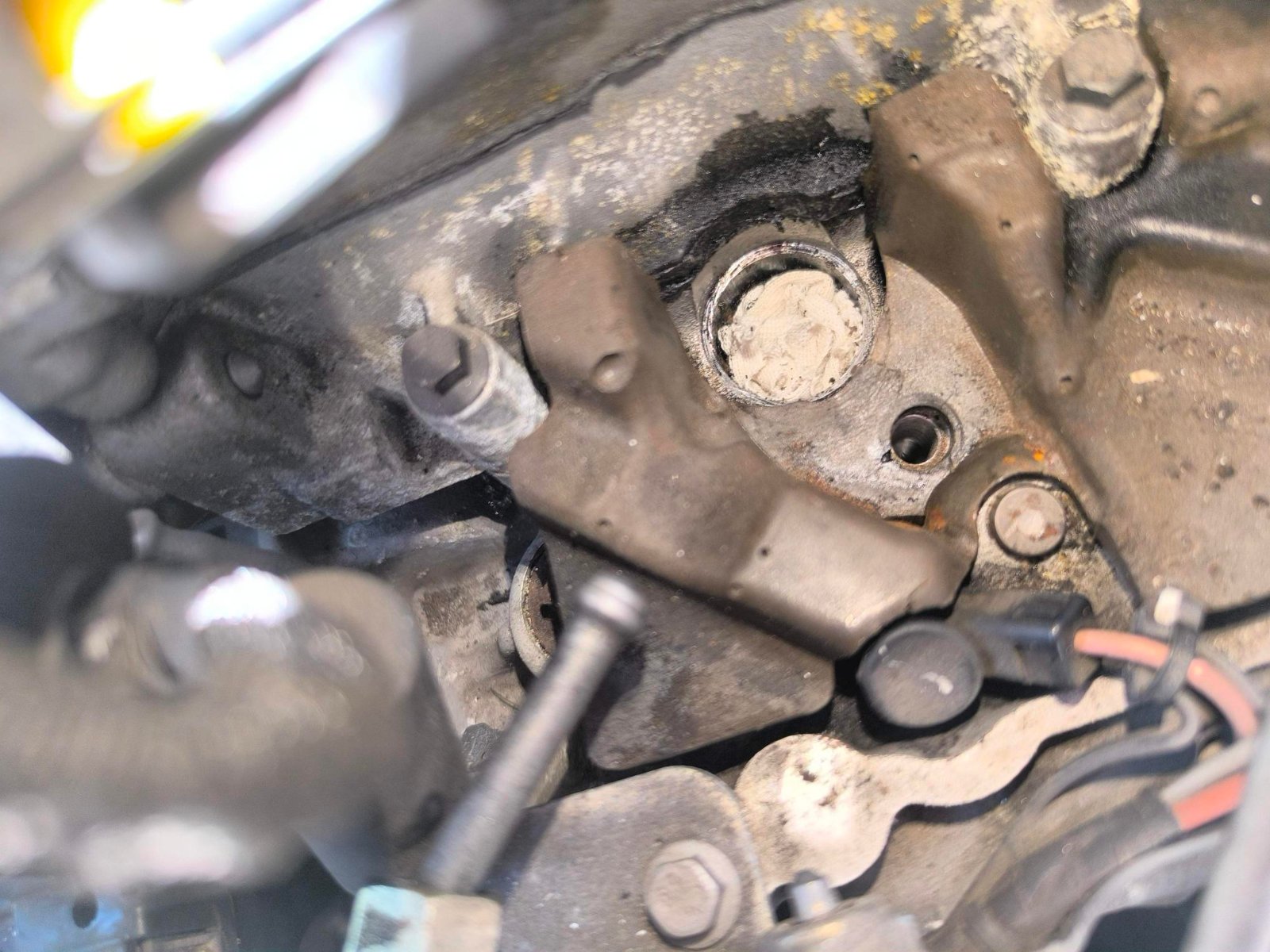

Right, I have my injector. New leak off tubing, and seals. I head back to the engine bay with my new injector and notice my old one has a plastic collar.
1. No injector I have seen on Youtube has this.
2. I get my pick to remove the black seal and there is no black seal!
3. My engine only has one stud to hold the injector in place.
Does my engine not have the top seal? There seems to be no place for it to locate.
Is it a taper seal?
One bolt/stud fastening? Have I got a later/earlier engine? Is this an upgraded design, or is the two bolt fastening the upgrade?
What is the plastic ring on the injector for. I can't see a reason for it.
I have photos that I can't work out how to load.
I think I have loaded them as files, below.
Cheers John.
2012 207 CC 1.6 Hdi Roland Garros with a replacement engine>

Re: Peugeot 207 cc Hdi engine malfunction
My injectors have a foam moulding above and below the injectors too.
- Posts: 12593
- x 1488
Yours is the layer 8V DV6C engine if it has single bolt clamps. I think the plastic sleeve should be transferred across (or replaced) I can't remember about the top seal, but if it wasn't there on the original that indicates it's not needed.

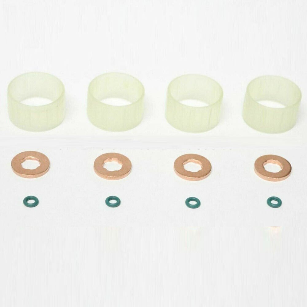

If anyone knows what the plastic collar is called I'd like to know (in case I break it!)
Also if anyone can confirm the presence or not of a seal at the top. (the black one on the 16 valve engine. Or for that matter the white spacer piece, in the now redundant seal kit) I would be incredibly grateful.
Found them!!!!! And no top seal.
