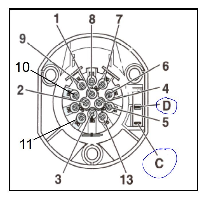

Hello.
My towbar electronics was ripped off.
I have the factory towbar + electronics module and I need to know how to connect wires from the tow electronics to the 13-pin socket.
Can anyone help?

Not sure if this will work but the towbar fitting instructions should be attached.

Hello.
Many thanks for that, seems to be very close. I am missing two wire colors, the brown and the pink, but maybe those are part of the harness and not the connector? i will check.
Thanks!

What the heck are those C and D references???

I would guess they are for a little microswitch that detects when a trailer is connected so it can cut off the read fog lamps on the car & adjust ESP.
Looks like the pink wire is meant to connect to D
