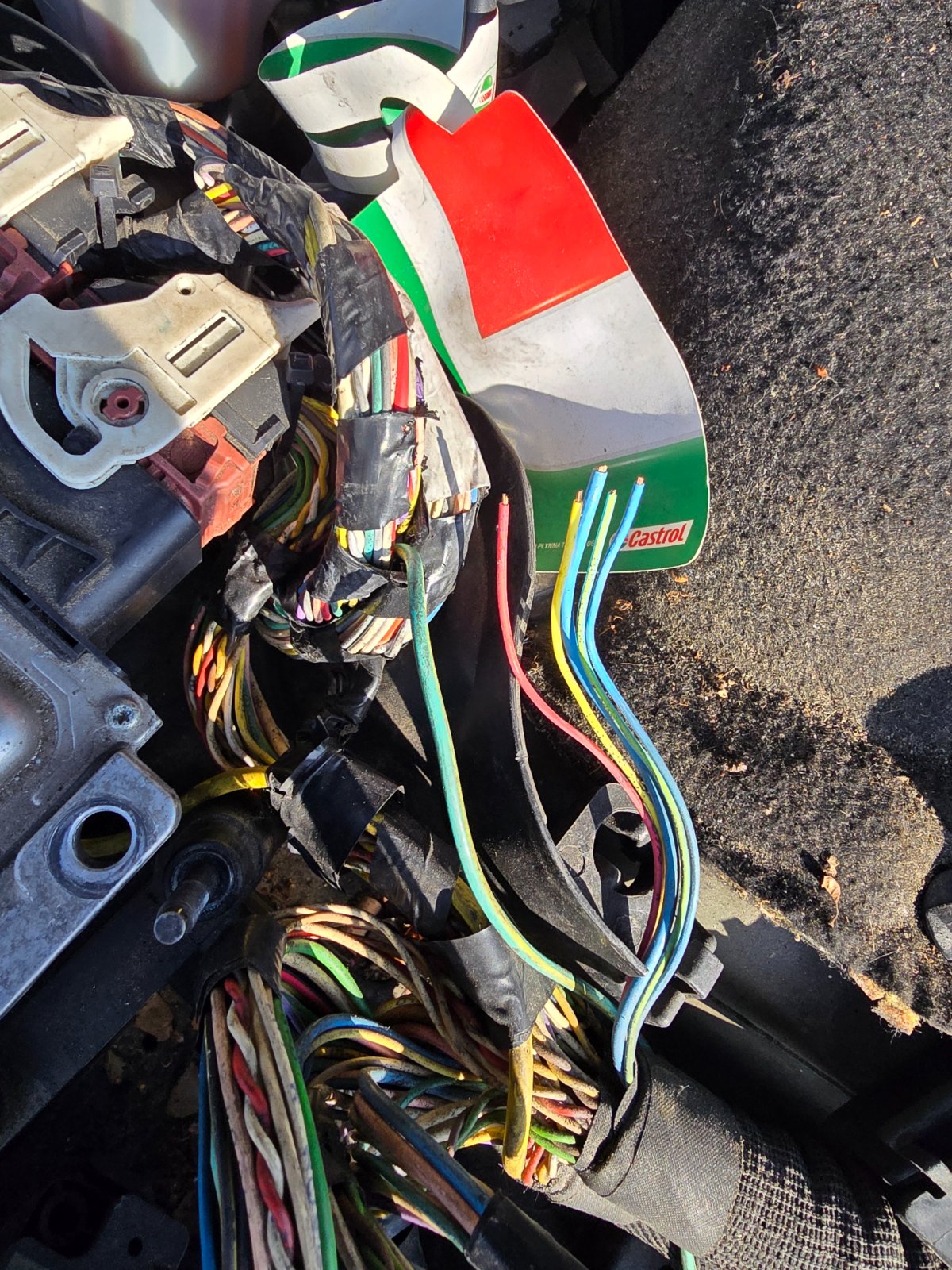

Re: Peugeot 508 Hybrid4 2012 CAN mess
photo attached, cables are near to BSI and ECU. On the photo you can see 3rd connector of ECU and cover of shock absorber - driver side (RHD).
OK, looks too neat to be attempted theft, i suspect these may be spare 'repair' wires. Im not familiar with the 508 but many Citroen & Peugoet vehicles have these
See here> viewtopic.php?p=700290&hilit=repair+wires#p700290
