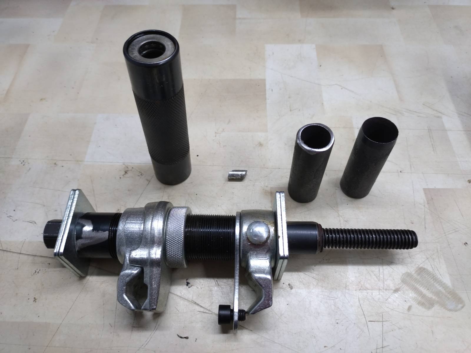

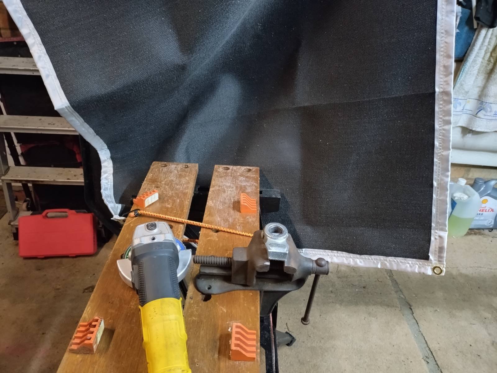

Anyone foolish enough to follow my antics on the DIY Motoring thread will remember my plan to overcome the problem with the dangerous 'push fit' joint in the spring compressor. I posted a sketch of my plan to remake them with a far safer design.
Today after completing my headlight polishing I set about the necessary work. First job was to erect a safe grinding bench using my welding blanket to catch all the sparks:
Firstly I cut the handle off the lower hook bar to give me more bolt length at the top.
Then I had to cut the upper tube as I was moving the failed receptor boss from the bottom end to the top. I actually cut too short a piece the first time so I made a second cut which gives the two waste tubes in the picture further down:

Then it was a matter of cleaning up the edges and assembling the unit in its new arrangement:
Laid alongside the original so the lack of inset tension joints is clear:
Having completed the job on the failed unit I repeated the procedure, but cutting the upper pipe just once, on the other unit to eliminate any chance of a similar failure in the future:
