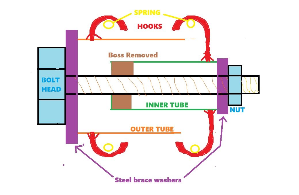

I think using the existing parts and adding a couple of thick steel brace washers I can make it work like this rather crude drawing:
Comments welcome?
Comments welcome?

Expanding on that idea Gibbo I wonder if I could grind the right hand side into a castellated finish, insert the left and then seam weld right round?Gibbo2286 wrote: 14 Feb 2025, 18:44 Can you not just grind off some of the chamfer on the bit to the right on your picture put them together and get someone to do a MIG or TIG weld all round?
It looks like a poor copy of a Sykes Pickavant tool.
Having said that I do think eliminating that joint altogether as in my sketch is a safer way to go

The only reason for the end that broke off is to give the tube a thread as far as I can see. I see 2 ways of repairing it.
Clamp the 2 parts together (once cleaned) with a threaded bar, re-champher and seam weld (as Gibbo said)
Or modify a nut, press the nut into the non threaded section then weld it in place.
I would also seam weld the not yet broken one.
If trying the 2nd option, get a copper bolt or cut a thread on a copper rod and screw it into the nut to protect the thread.

Thanks for those thoughts Pete, the situation has changed somewhat now and I am sending the entire tool to Trading Standards in order for them to hopefully get them recalled and possibly prevent someone else having a serious accident as a result of the same problem. If I get it back I may use some parts to rebuild a useable tool, but I will not have any joints which may be subjected to tension in the design. Thus I will probably go along similar lines to my sketch above. It will really just be an exercise in welding for me as I am somewhat rusty !! Boom boom

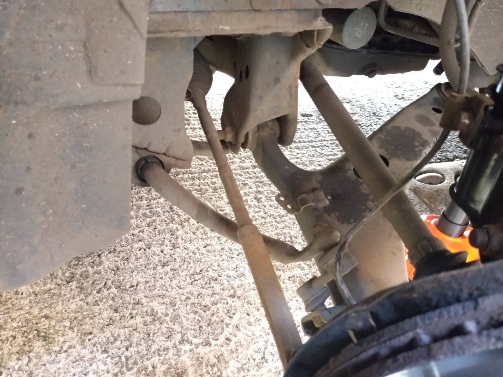

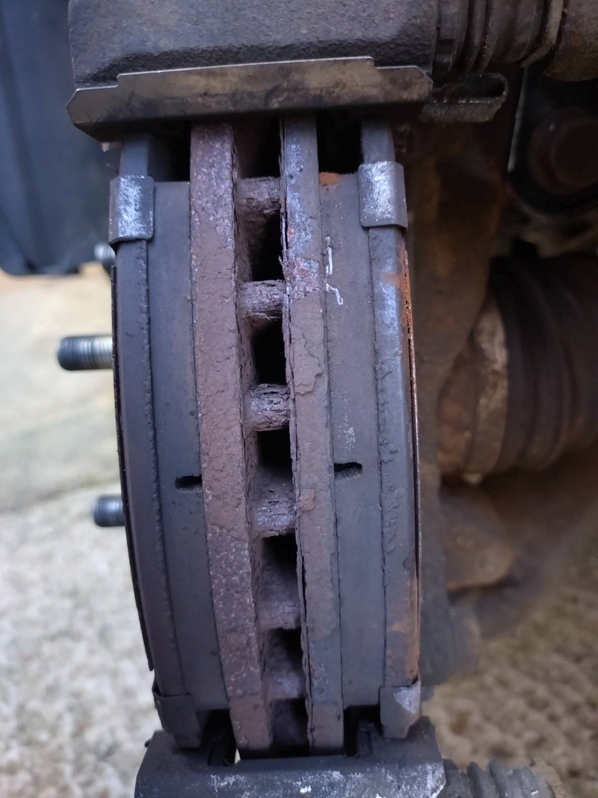

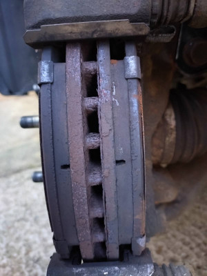

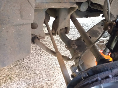

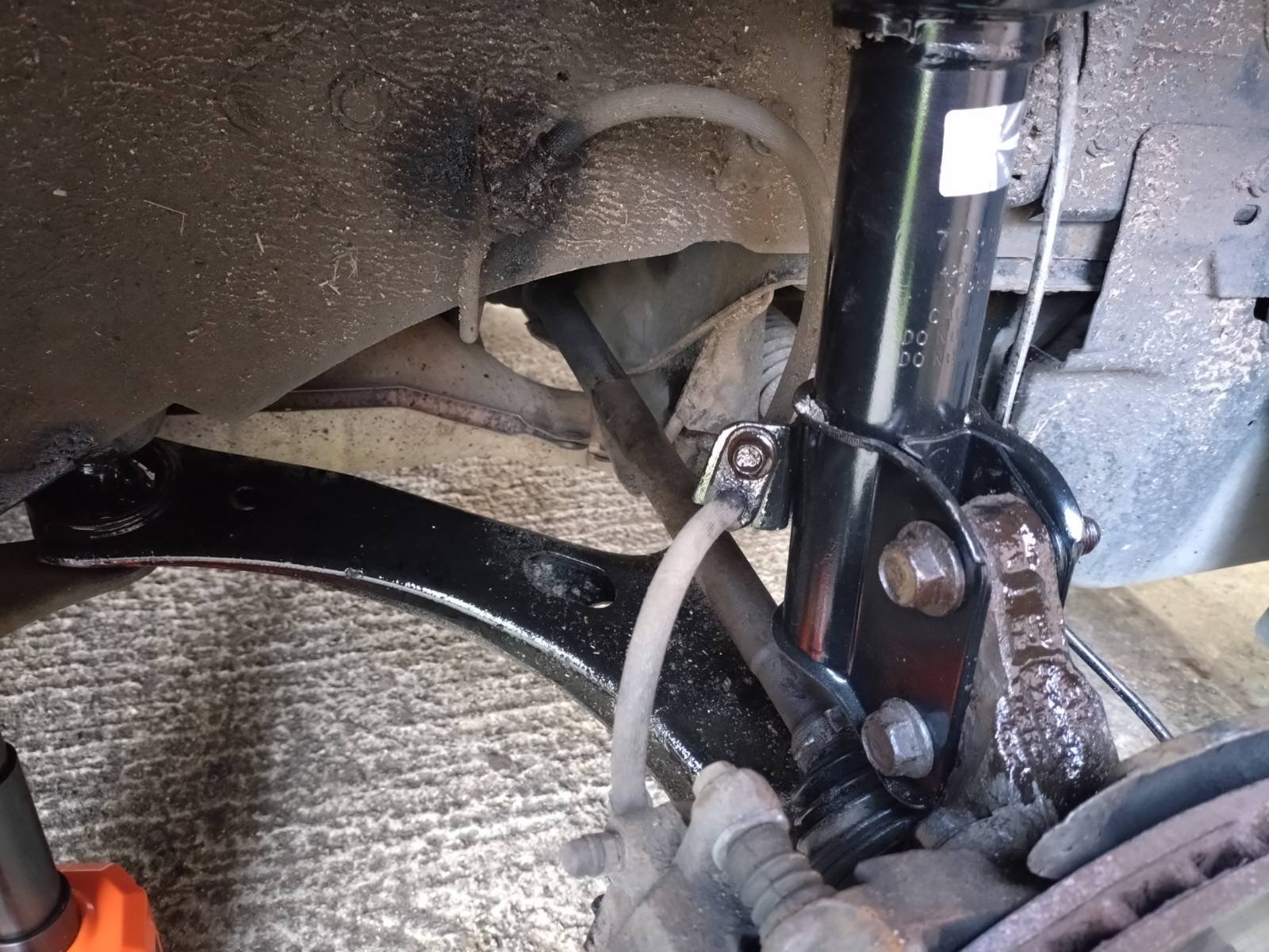

It was a bit warmer this morning so I did manage some pictures for confirmation. I got the last part of the running gear overhaul done with an inspection of the front calipers and pads:
which still have some life and a cleanup of the sliders.
Then it was time to treat the metal and I got a before picture:
of the nearside and an after picture:
of the offside.
Just the engine service to go as I swapped out the cabin filter yesterday and forgot to mention it!!
