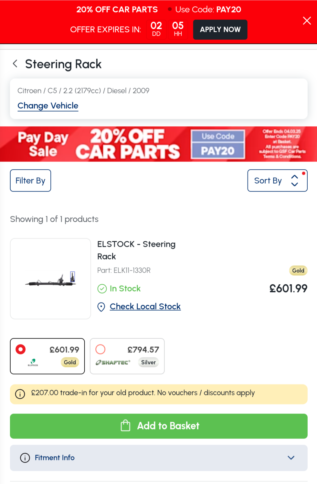

In terms of parts supply, believe it or not... GSFCarParts list reconditioned racks for X7's!
Iain
CX DTR T2 Safari (silver)
Posts: 4948
Joined: 25 Apr 2022, 09:03
x 2154
Re: C5x7 3rd time steering leaking
Unread post by MattBLancs »
wurlycorner wrote: 02 Mar 2025, 18:06 In terms of parts supply, believe it or not... GSFCarParts list reconditioned racks for X7's!
Interesting!
https://www.gsfcarparts.com/parts/steer ... ering-rack
£601.99 -current 20% discount code (brings down to £481.59)
And reckons £207 back for the old rack.
Seems cheap!?

Unread post by wurlycorner »
Yep! Worth a shot I reckon.
I stuck an Elstock alternator on my other C5 a year ago and it's been absolutely fine - so there's nothing ringing alarm bells about them for me.
