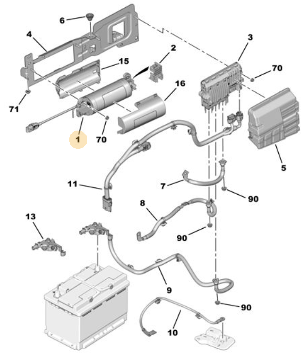

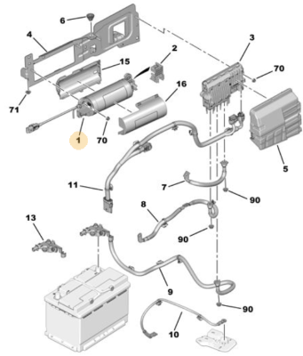

I've mentioned this elsewhere, but on your vehicle, it does not rely solely on the main battery for stop start! You have a separate system as shown below. This is all buried behind the front left wheel arch. Caution though, do not attempt to remove this yourself without properly discharging it! Best left to a dealer to sort that have the training.
This system uses an ultracapacitor or energy accumulator shown at (1) and a converter unit (2) for this particular system, whereas later systems have done away with this to save money and rely on the main car battery which is less effective. But as your vehicle is approaching 10 years of age, it may need replacement.
