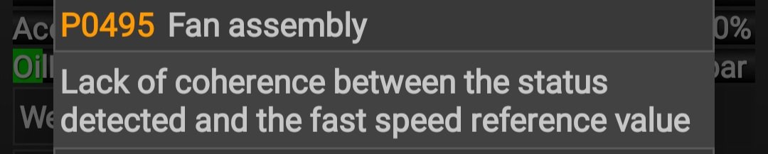

Hello everyone, I have another P error while driving. It is error P0495. I was able to delete the error, but I think it's a matter of time before it comes back. Where should I start my search? Replace relay or fan?

Ohms test both , then pop your readings up , but ... I'd change the relay (if it was my car) there not to badly priced.

Is this the correct part?
https://www.ebay.de/itm/363204389941?_s ... BM1riD-KRl
According to the VIN number it is. But is it also the solution to my problem if I just want to change the relay?

That looks the right one

Once replaced test it with lexia. Normally these parts are just like plug & play.

Change issue deleted all good
