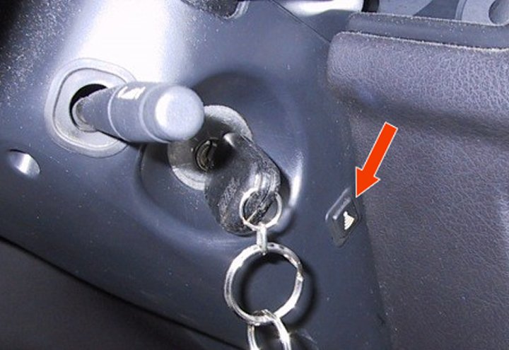

Has your 306 got one of these small buttons on the steering column housing.
If so turn on the ignition while holding the button in. The 4 way indicators should flicker.

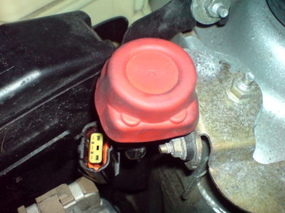

Has the 306 got a accident fuel pump killer red button in the engine bay by the bulk head? If so just press it.
