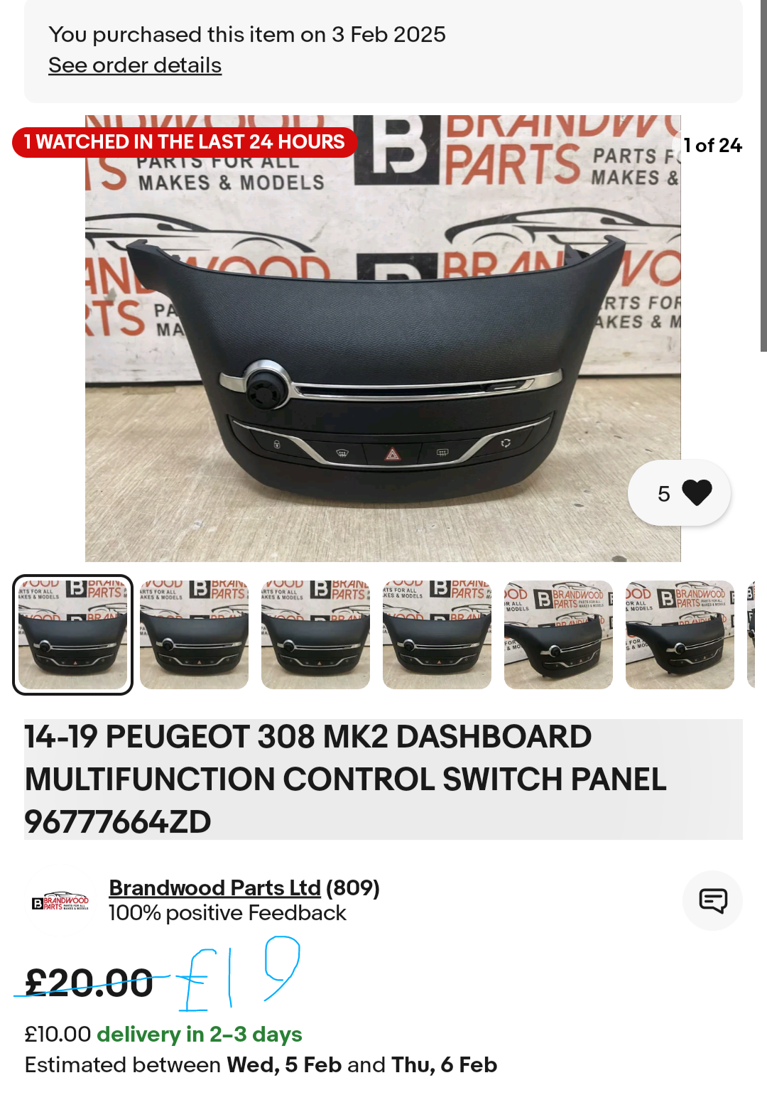

MattBLancs wrote: 03 Feb 2025, 07:27 For the potential blue 308 CD upgrade idea,
Dashboard panel (which has connection covering both volume knob, heater controls and additionally the CD's eject button) I think part number is 96777664ZD
Err, whoops my finger slipped :rofl2:
Spoiler: show
Buy it now - done!
Buy it now - done!
x 3565
Oh dear, what a shame, never mind - eh ? :-D

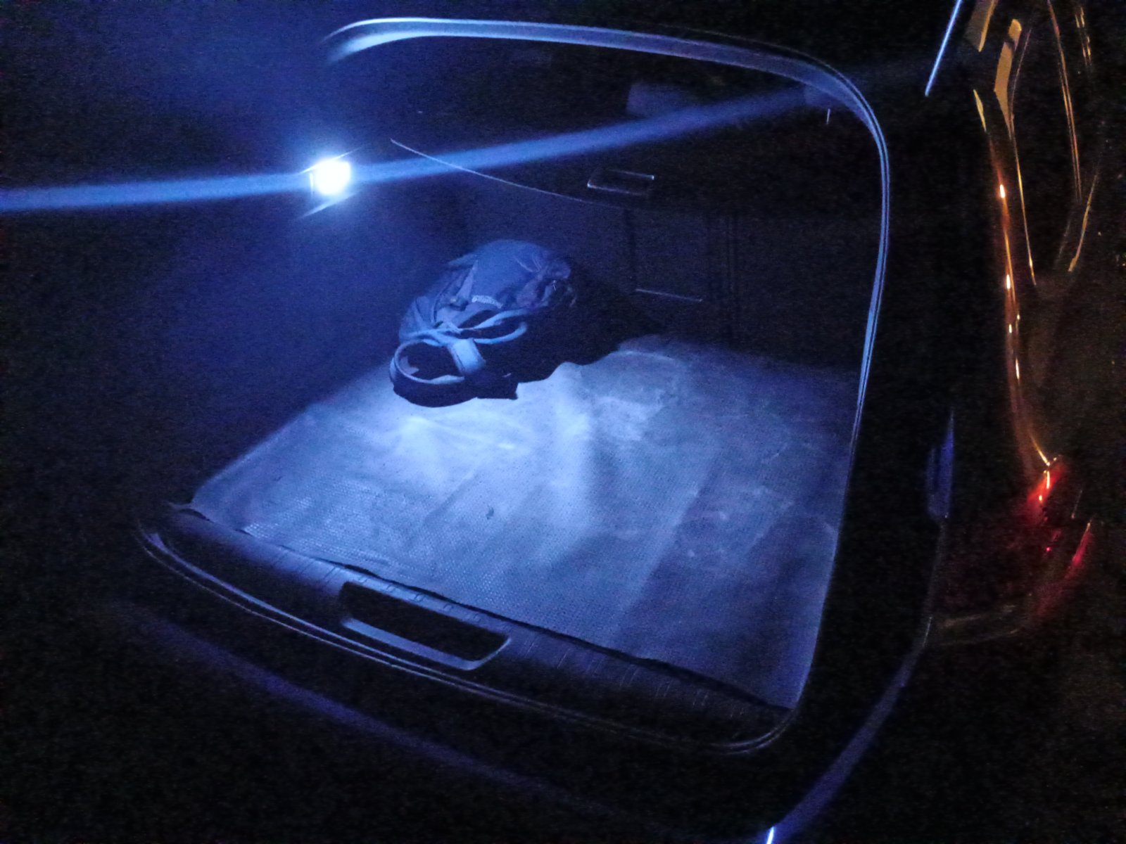

Blue 308, LED boot light is miles better!

mickthemaverick wrote: 03 Feb 2025, 19:53 Do you mean it automatically tidies the boot then Matt? :-D
Haha, no, very manual job done first, then I could sit in there and get at the bulb holder!
You'll have to do without a photo of the front footwell lighting as it's a little too akin to "floodlit car mats that need a good hoover" for public viewing as yet! :-D

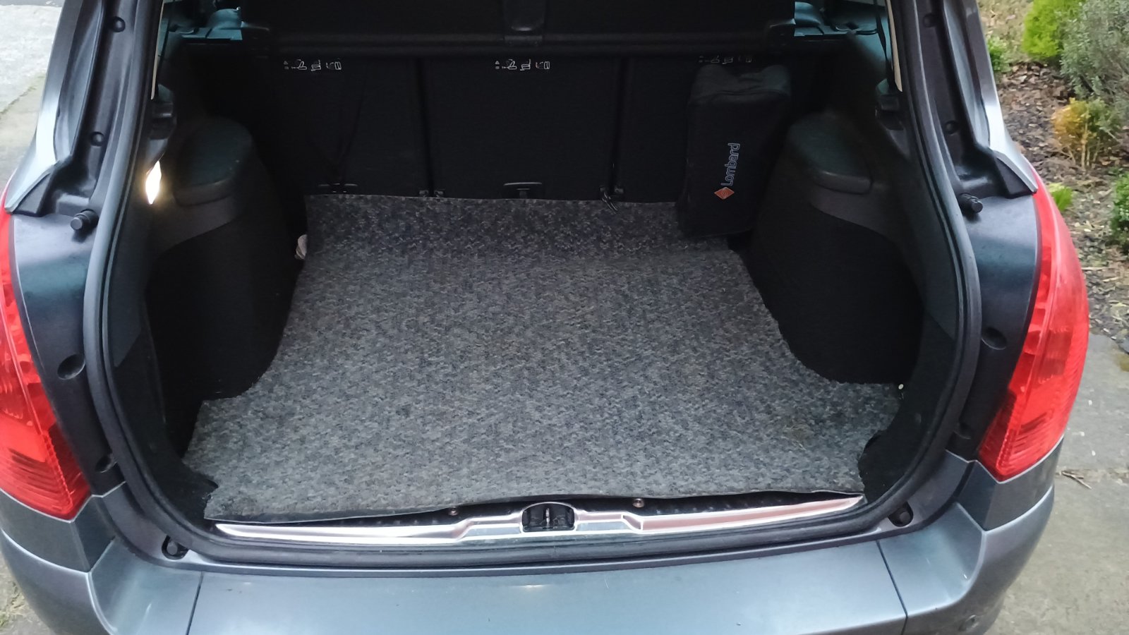

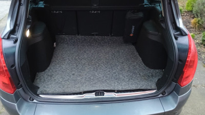

The other 308 also, briefly has a tidy boot as it foo was emptied - so I could cut a piece of chunky doormat material roughly to size.
A five minute job that's been on my To Do for a good while!
As above, bought for £29, think will arrive tomorrow.

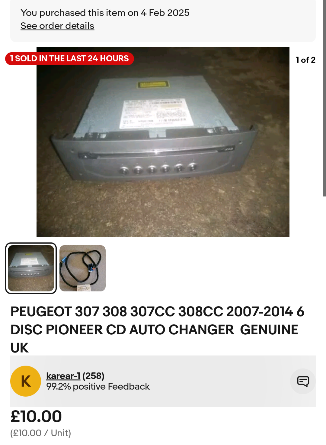

Stumbled across something and if all goes well BOTH 308s will be getting an audio upgrade!
Spoiler: show
£10+£3.39 postage

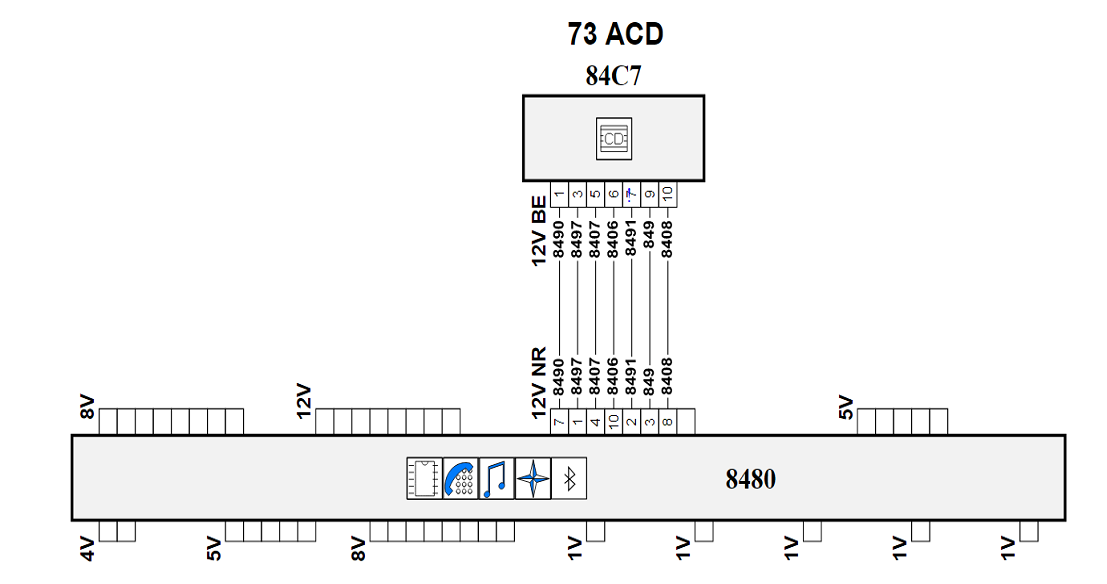

Pasting answers here for easy reference:
GiveMeABreak wrote: 05 Feb 2025, 10:21 Only just picked this up via the parts thread Matt (always best to request parts there so they're not missed anywhere else).

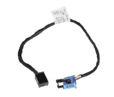

As for CD, took me a while as there is no CD specified in parts for your vehicle, however I can confirm the Fascia part is correct and also the harness will be needed: So yes you need a specific harness to connect this to the main unit and of course it will need telecoding in the BSI. They deemed these not necessary, with Audio Streaming via Bluetooth and the ability to play media via USB. Please also note that connecting a CD will not allow copying of media to the internal 'Jukebox' storage according to info I have.
CD Harness for SMEG units, part: 6571QY, £78.13
The CD is not coming up against your vehicle, and the only one I can see that is compatible with the electronic architecture and build date is part: 1629118180, £328.02

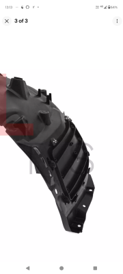

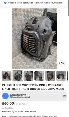

Arch liner first
My current one looks like this:
Solid (eBay image)
Solid (eBay image)
Solid panel.
But as per the parts diagram, it should look like this!
Vented (eBay)
Vented (eBay)
