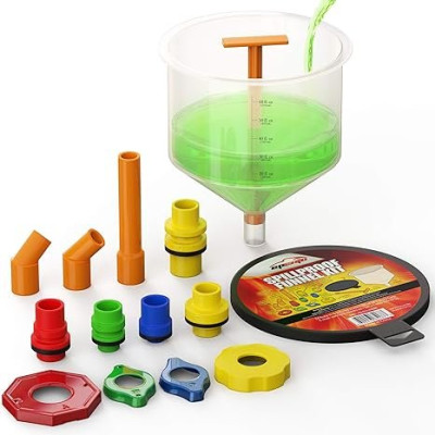

I did some more research last night and it seems that airlocks are a very common problem with this engine. I watched a fair number of videos and came to the conclusion that this device is my best bet when used in the bleeding process, it also has the advantage of fitting various other cars so will be generally useful I feel. Anyway it's on the way and due here later today.

Funnel kit looks a good gizmo, though anyone claiming
"spill proof" clearly hasn't seen me at work!

Seriously, that funnel looks a seriously useful bit of kit...
- Posts: 6846
- x 3566
Re: DIY Car Maintenance with function over finesse!!
Like most things, you could do the job cheaper if you're resourceful - a coke bottle could be utilised for filling..... but the proper kit doesn't half make the job easier, slicker, and just better in the end. I've got the Sealey equivalent of that kit and have used it in the past - and it just works
- Posts: 21053
- x 8085
I've used the bottle method in the past but you always end up pouring coolant everywhere when its time to lift the bottle off. The thing I like particularly about this kit is the stopper you insert through the coolant into the neck of the funnel when you are ready to take it off. Then you just pour the excess coolant back into its container!!

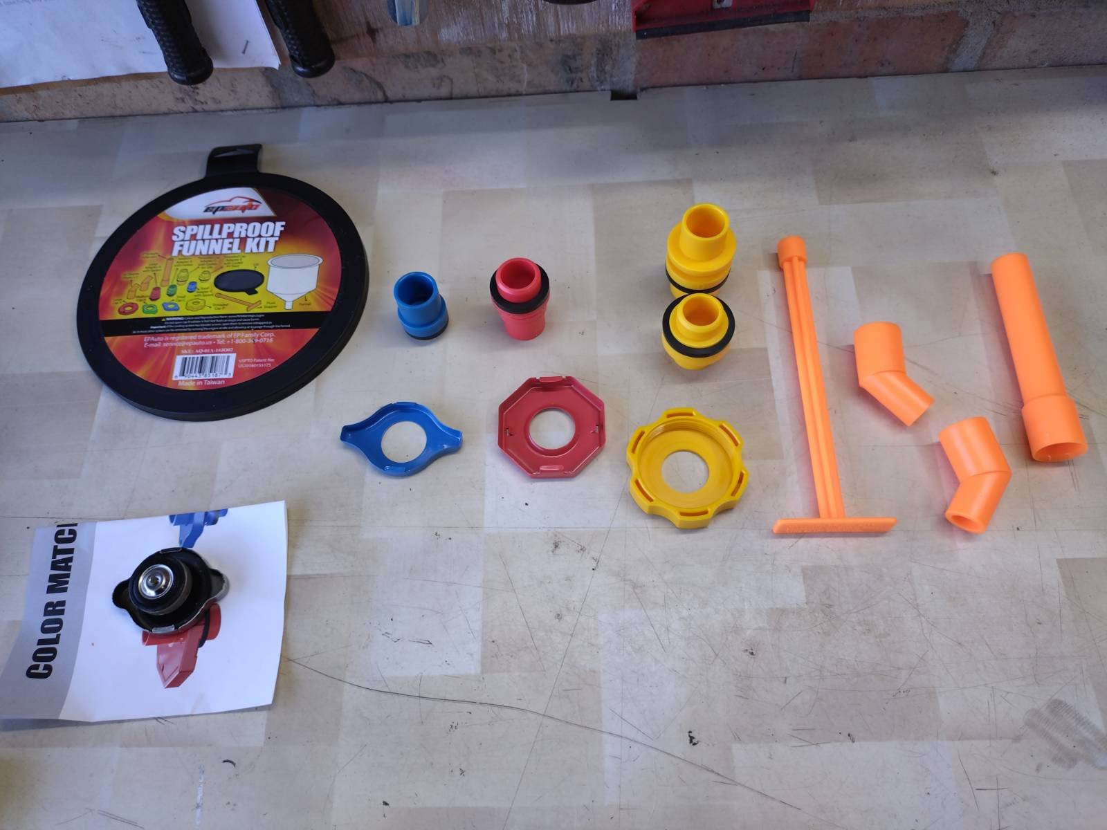

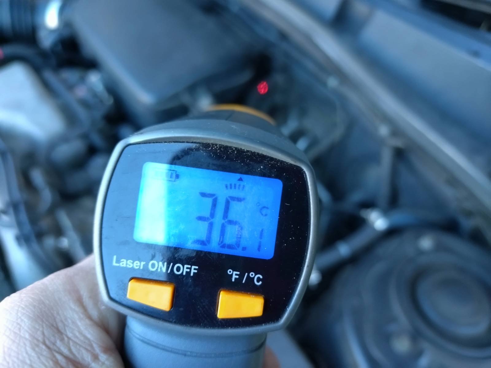

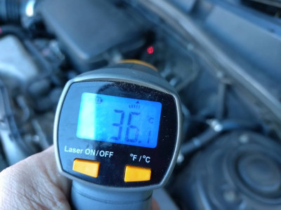

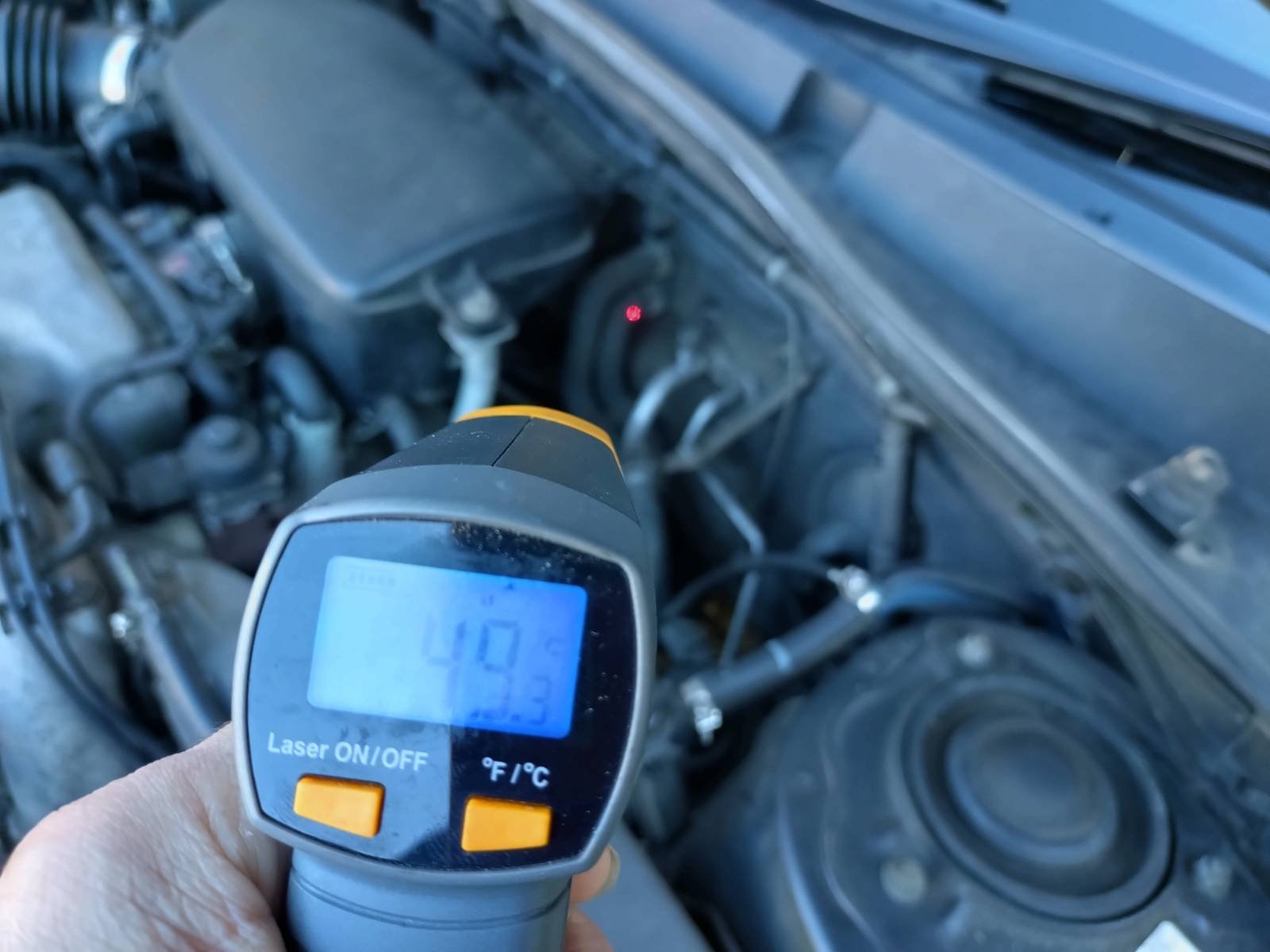

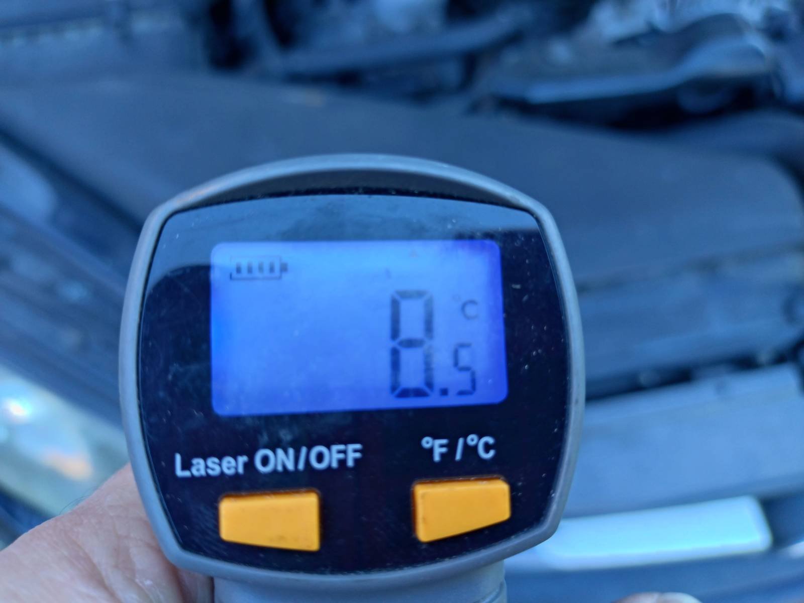

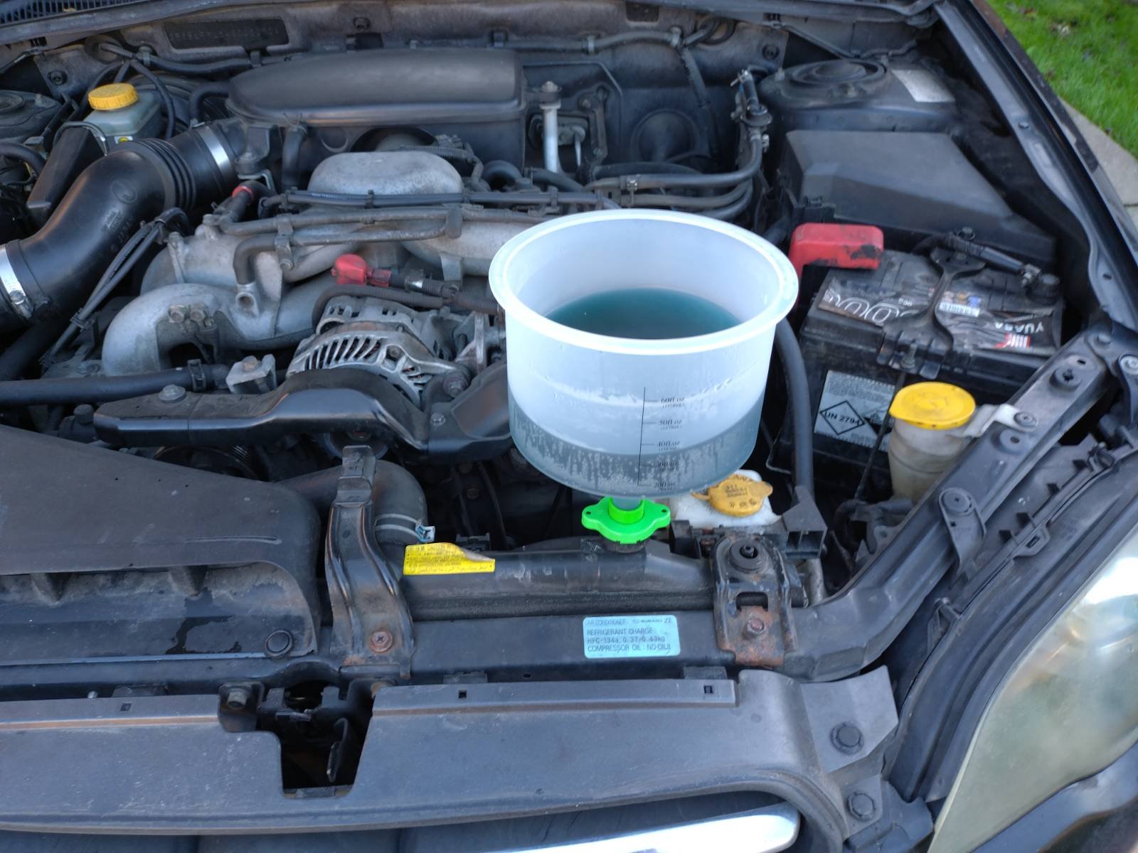

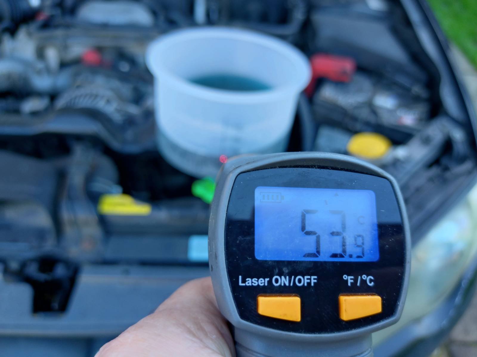

So this morning I set about the bleeding, beginning by laying out the necessary and useful things:
I set up the funnel which fits perfectly:
Then started the engine to be greeted by loads of big bubbles coming up at start up!

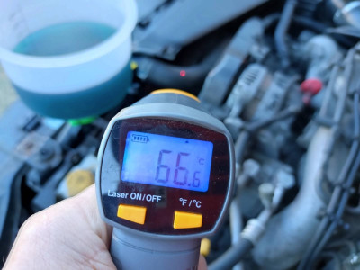

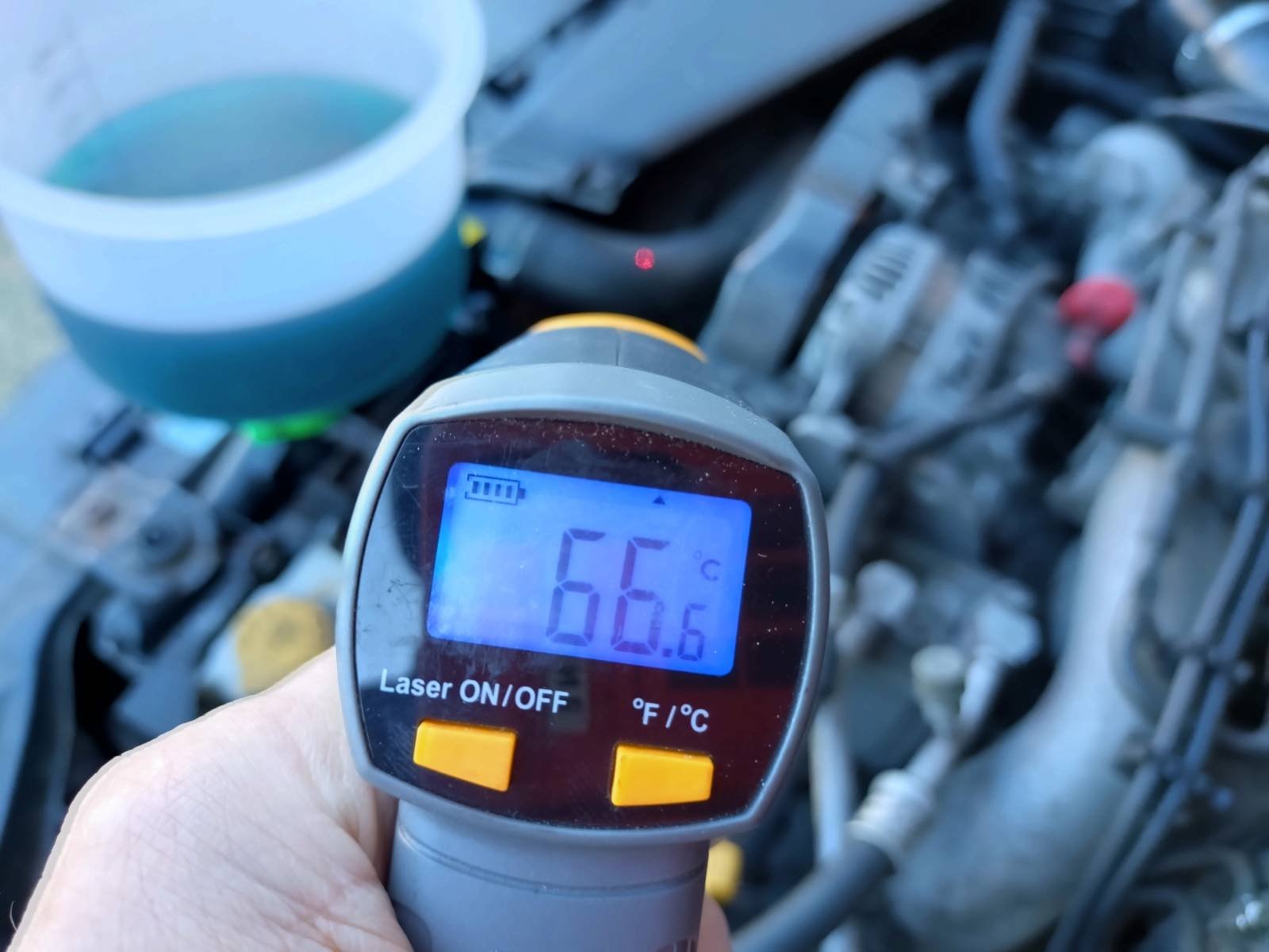

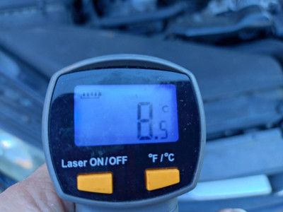

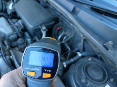

I ran the engine until the temperature gauge read normal and watched the bubbles gradually diminishing. Pumping both the bottom and top hoses initially caused bubbling but after three cycles of hold it at 4000 rpm for 1 minute and back to idle the bubbles no longer appeared on pumping the hoses. The next phase was to leave it idling for five minutes watching for bubbles - None!! So I left it to cool for 30 minutes and took some temperature readings, which I had forgotten to do while running at 4k
, which you can see below
So now I just have to wait for it to cool enough to dismantle, refit the cap and drive it around. I will keep a close eye on the levels until I'm happy it is sorted!!

Summing up on the coolant bleeding, both cars have now got excellent heaters and are free from any bubbling when pumping the hoses. I didn't spill any coolant at all or have any splash anywhere. A good day's work methinks so time for a Guinness 0
