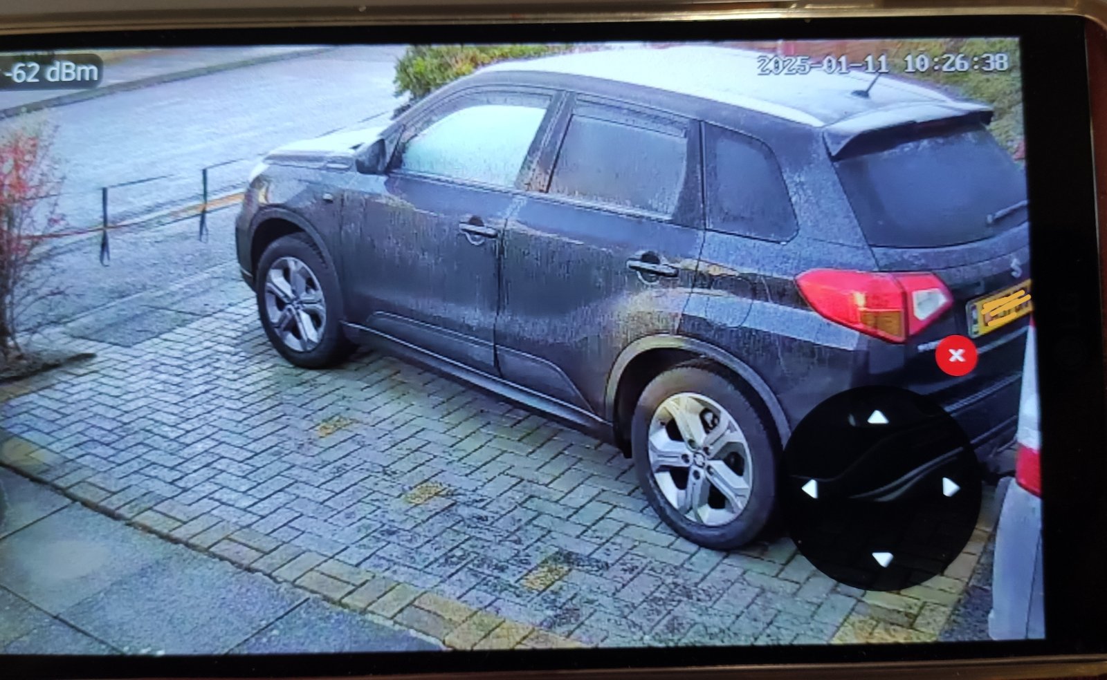

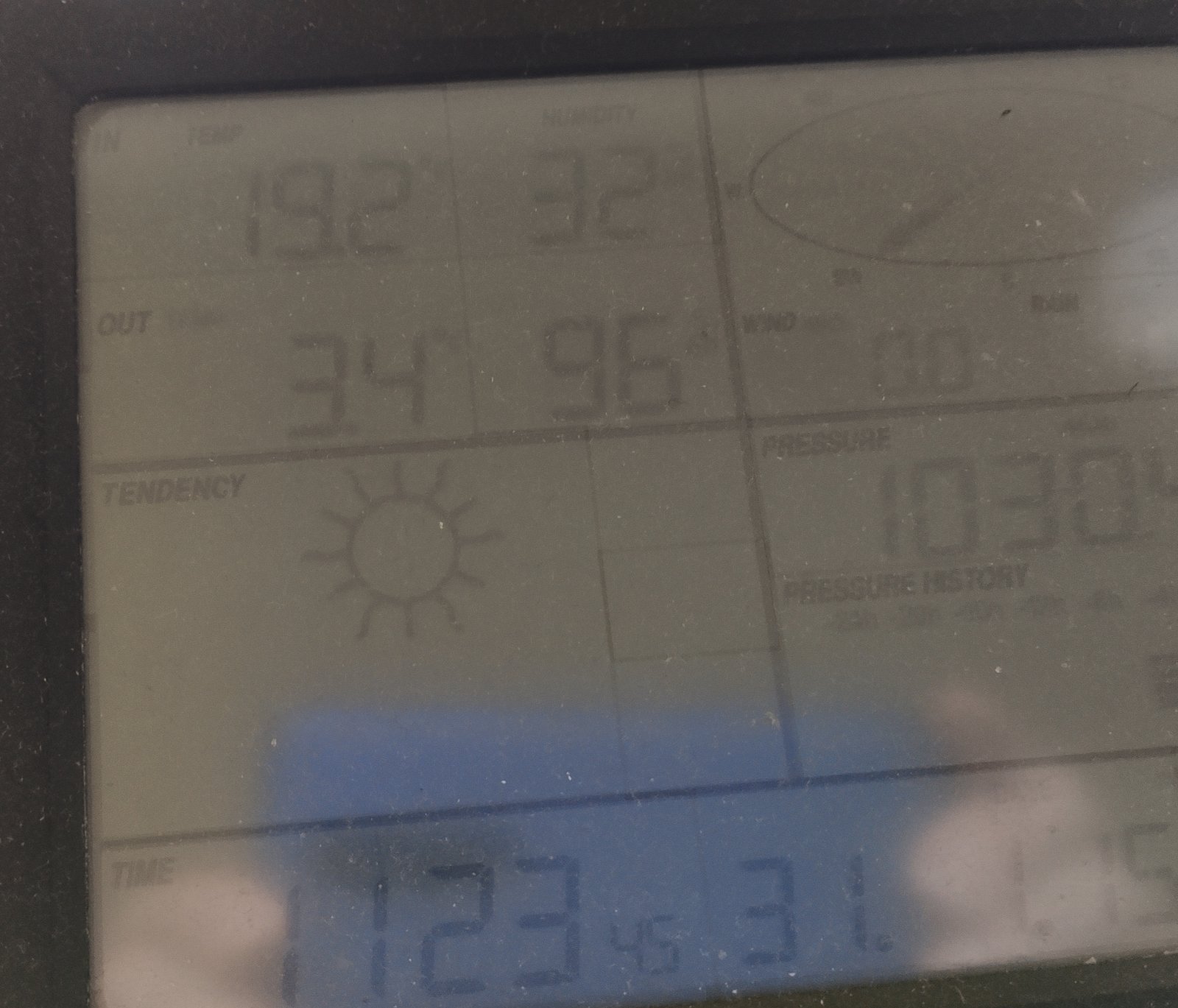

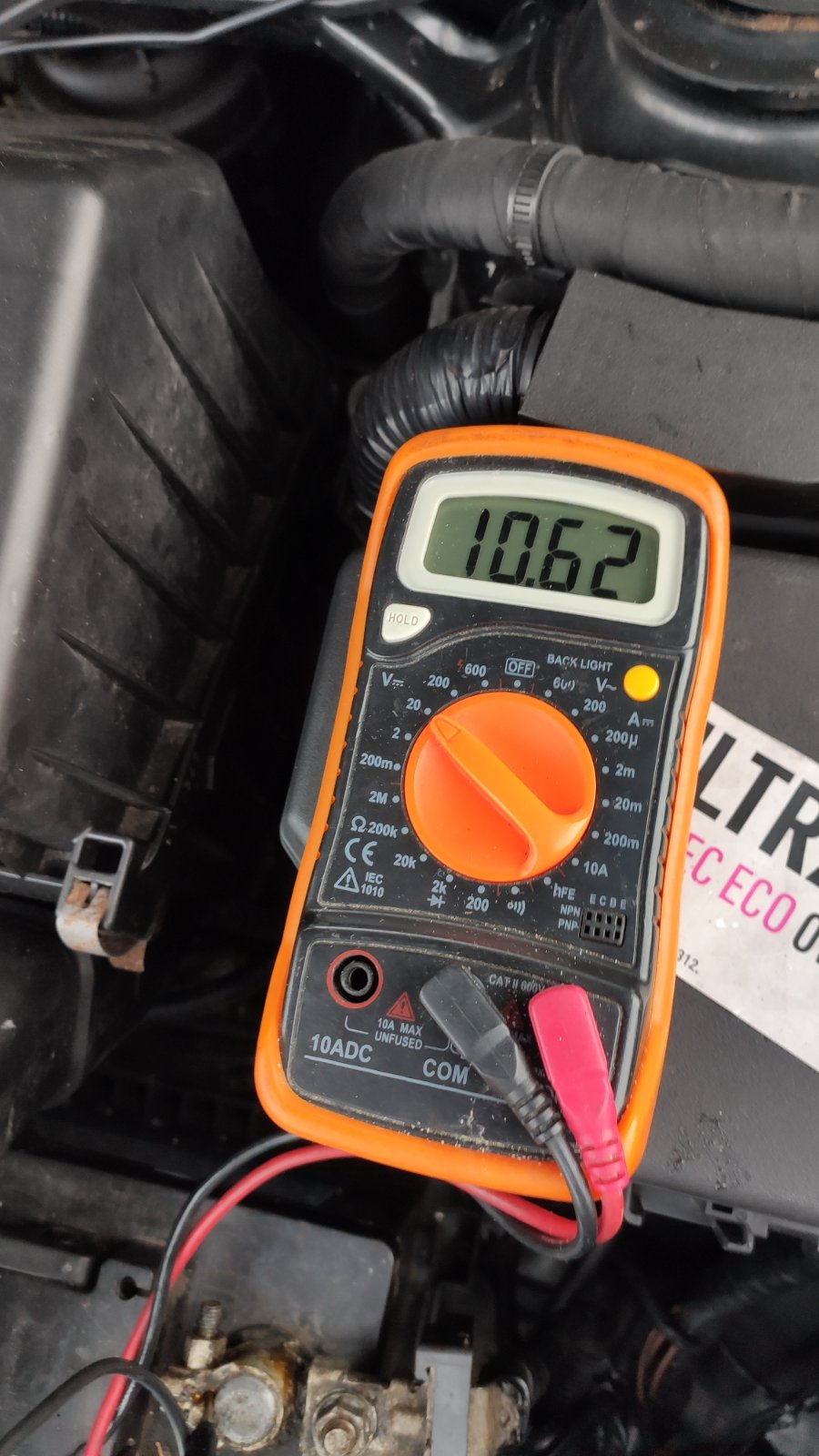

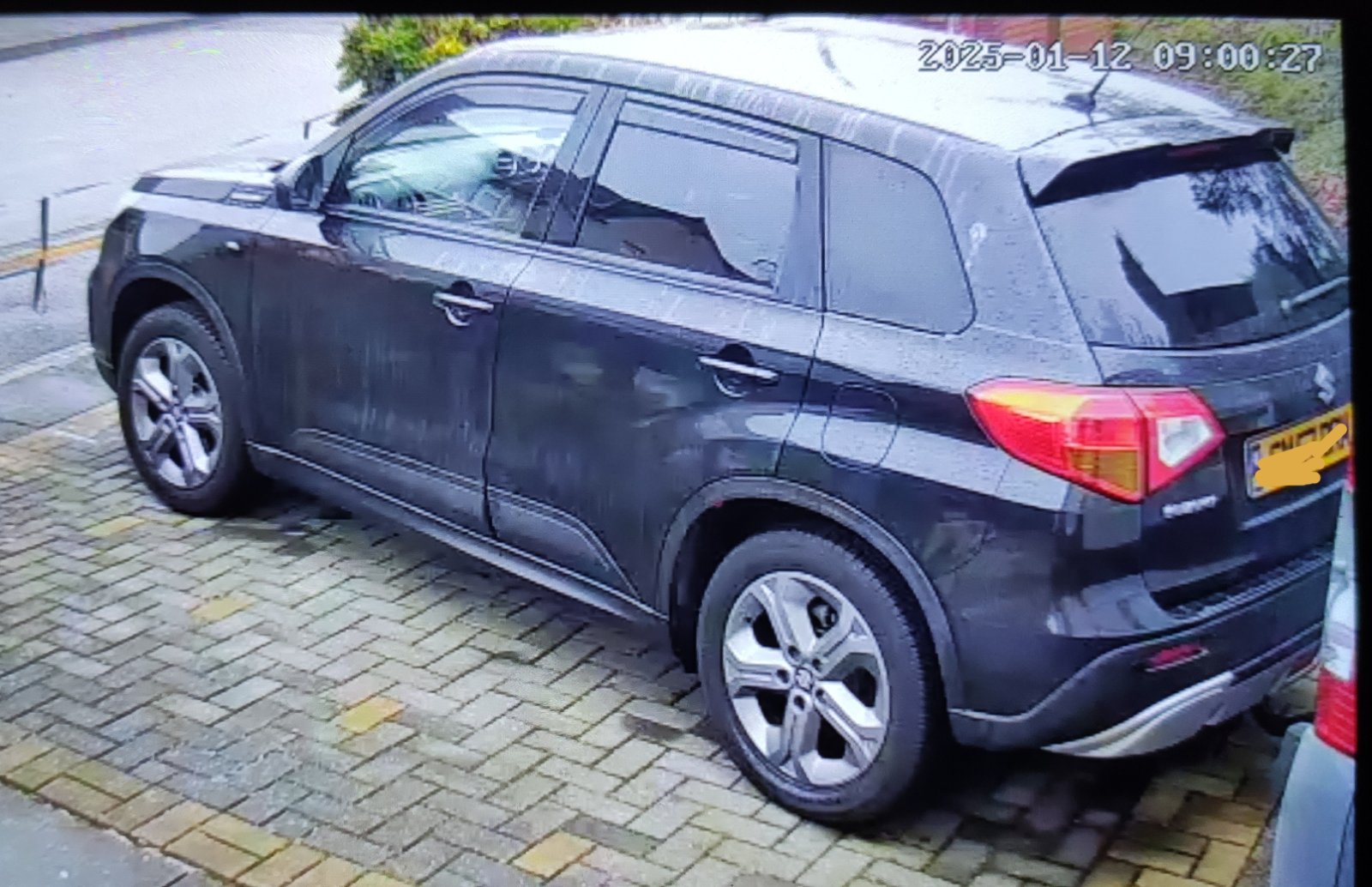

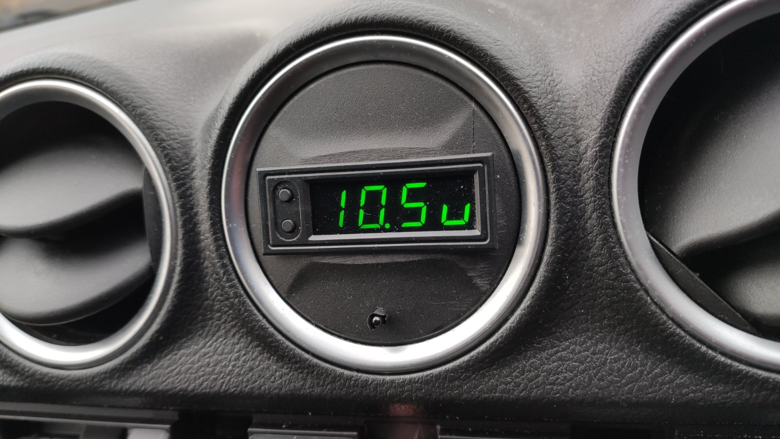

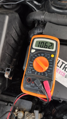

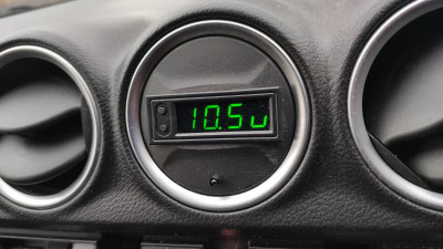

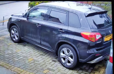

Well, what a difference a day makes.
For those who are interested, the weather station screen grab shows we are +6/7'c compared to yesterday and the really eagle eyed among can confirm that the car is in exactly the same spot and has not moved since yesterday (check the wheels/valve positions and the patterns on the drive )

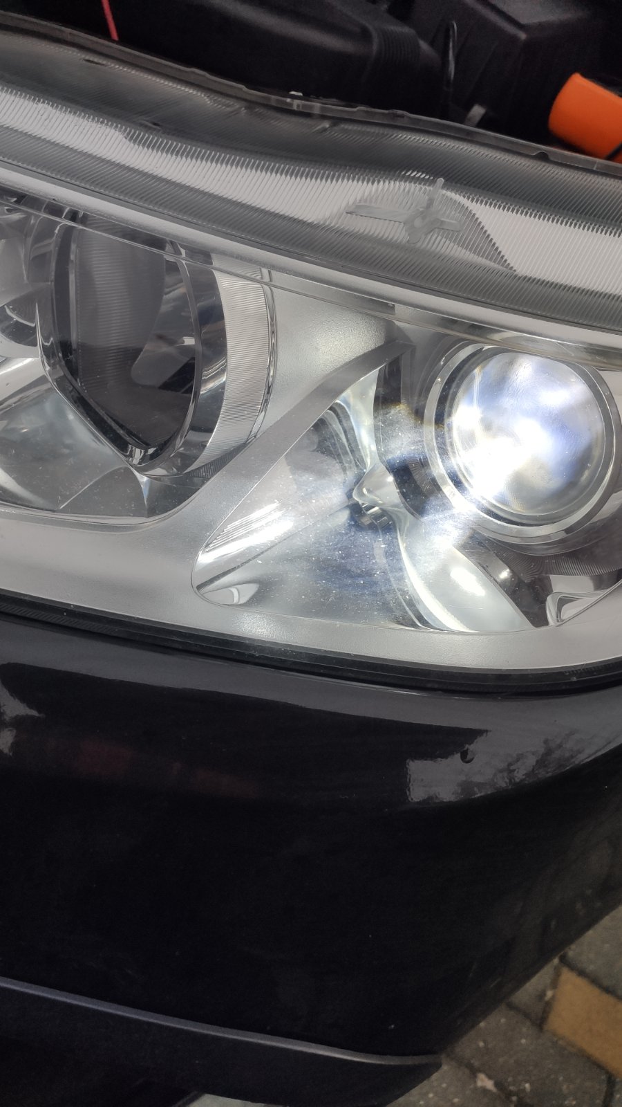

I had to lower the battery voltage with the headlights.
Admittedly, the conditions are warmer and the battery got a bit of a warm up by drawing some current through it, so, not exactly the same conditions as yesterday. Probably slightly better.

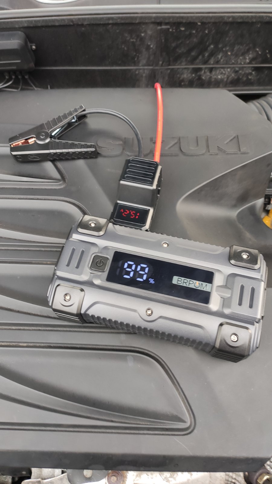

I attached the Hilldow, pressed the boost button until the unit clicked on "Boost" and went to start the car.
The Hilldow did spin the engine this time but not enough to start it. Drats!
The battery is even more depleted. So, reattached the BRPOM, sat in the car, engine started immediately. Hurrah!
It expended a whole 1% of it's charge.
The Hilldow was down to 75% again and took the same hour and a half to recharge as yesterday.
I don't have access to a small petrol car so I am not going to be able to try it on a small engine. Looks like I have a £21 torch and phone power pack.
I have to say, though, the BRPOM is impressive - more so when you find out that it actually cost me under £30.
You win some. You lose some.
