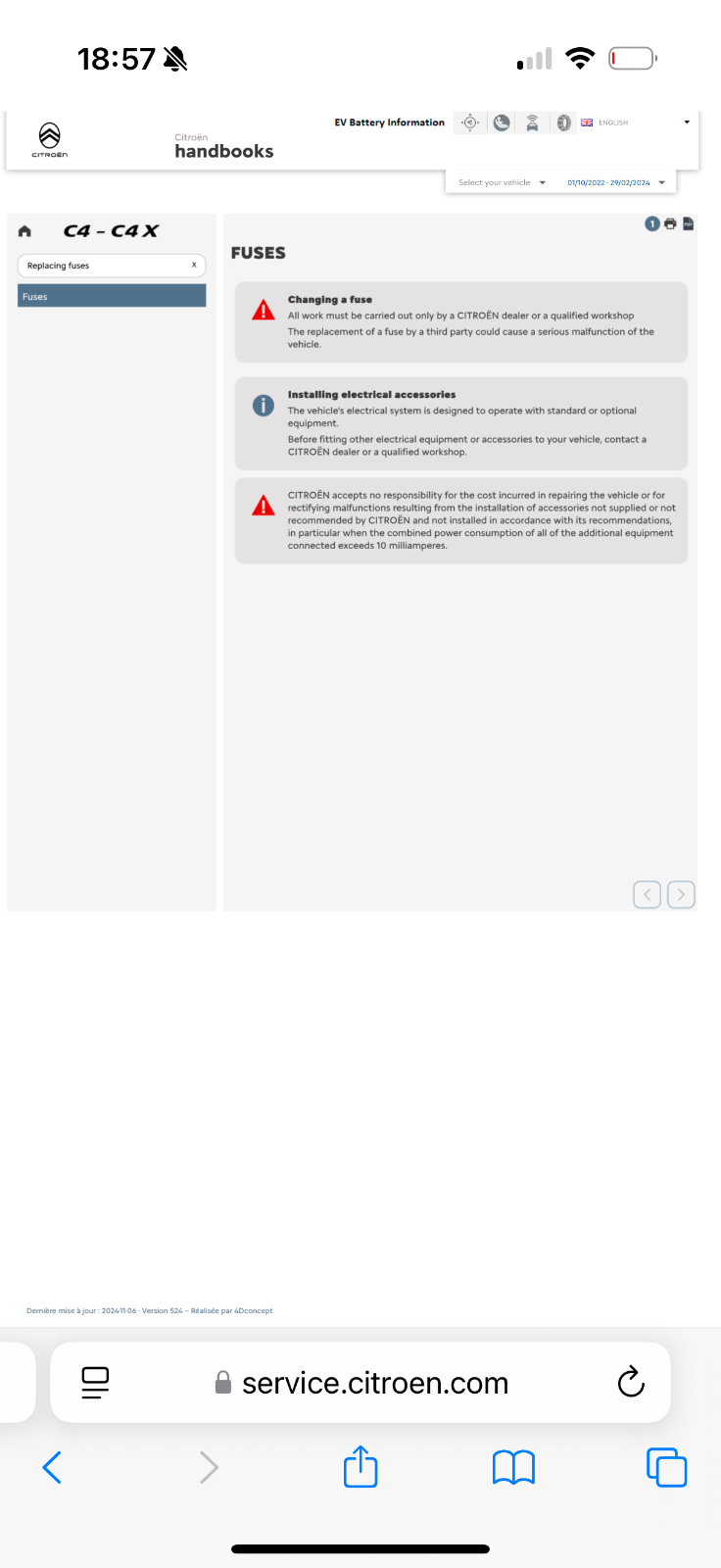

Re: Car won’t display anything
I’ve attached from the electronic manual. Just says this unfortunately. This is from the link kindly supplied and also matches the wording in the manual I received electronically.
Gosh, that's absolutely ridiculous. I'm shocked, to be honest with you.
How different is a C4 to a C4/C4X, I wonder? That manual does include info on the fuse boxes.
