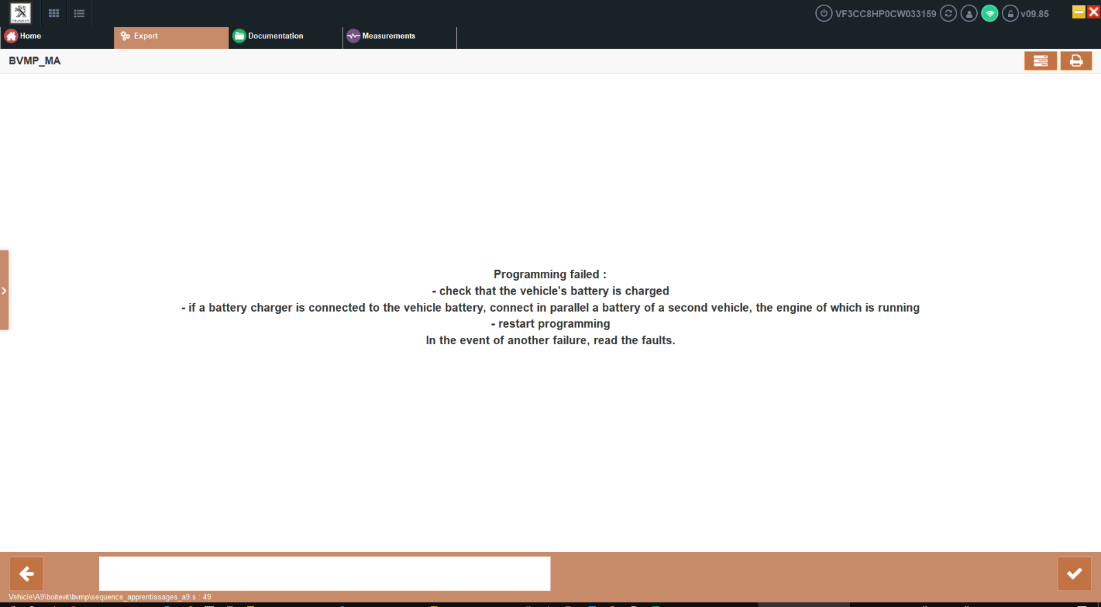

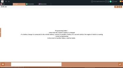

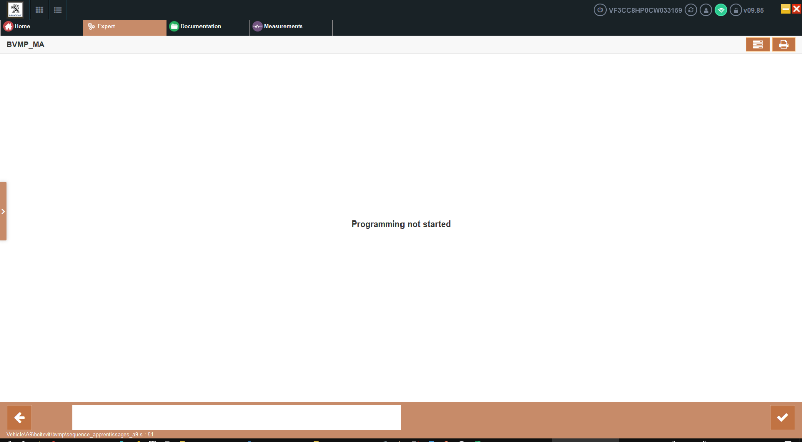

Clutch actuator seems to pass the adaptation but the gearbox does not. Does few movements and then stops with either "programming not started" or "check battery".
During gearbox actuator adaptation it first moves from neutral to the reverse gear, then up, down, few fast and short movements left-right, then back to neutral and stops.

Tried programming using Thinkdiag (full version, like Launch) and simple Chinese Diagbox (9.85) - same effect.
Tried to do it from parts replacement section and from programming - same effect.

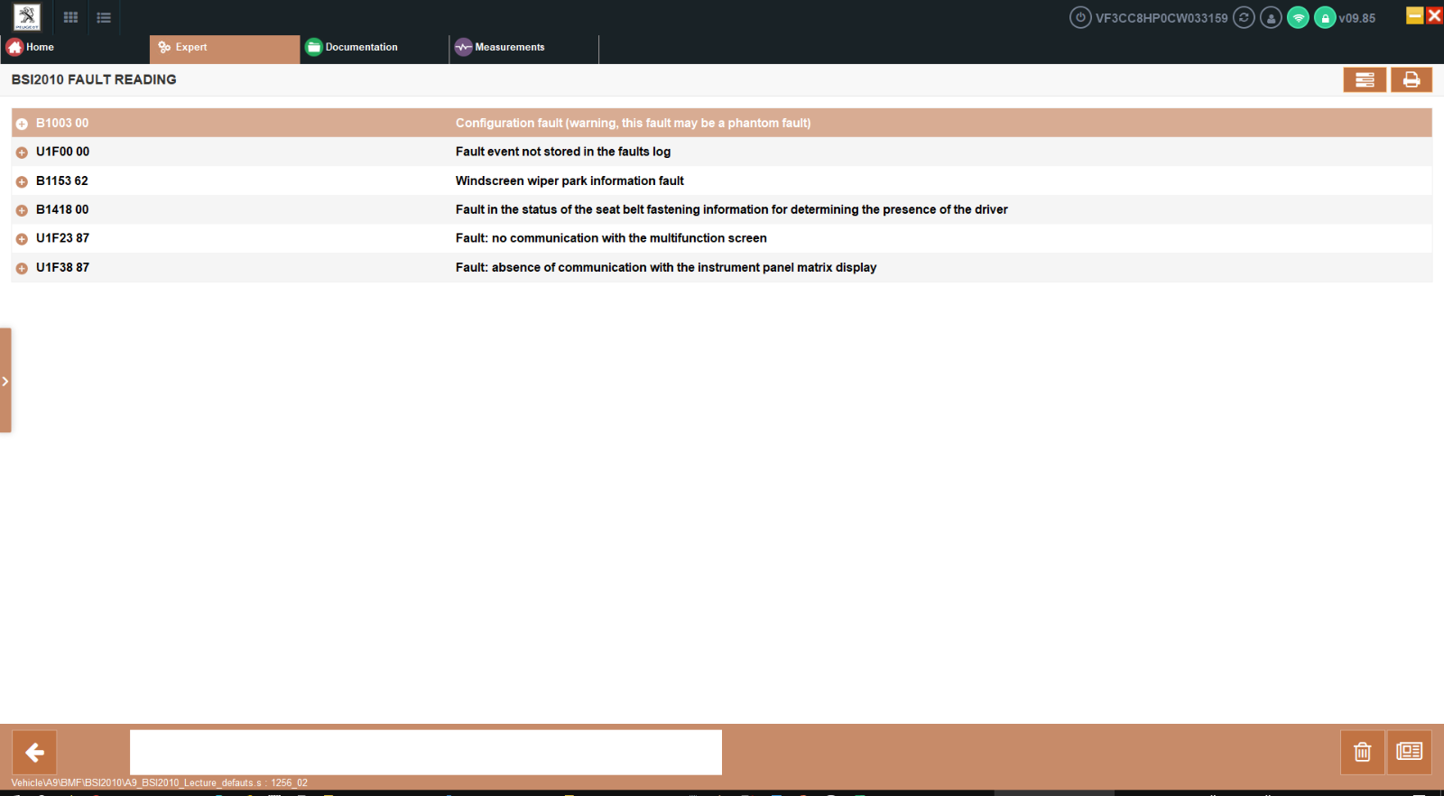

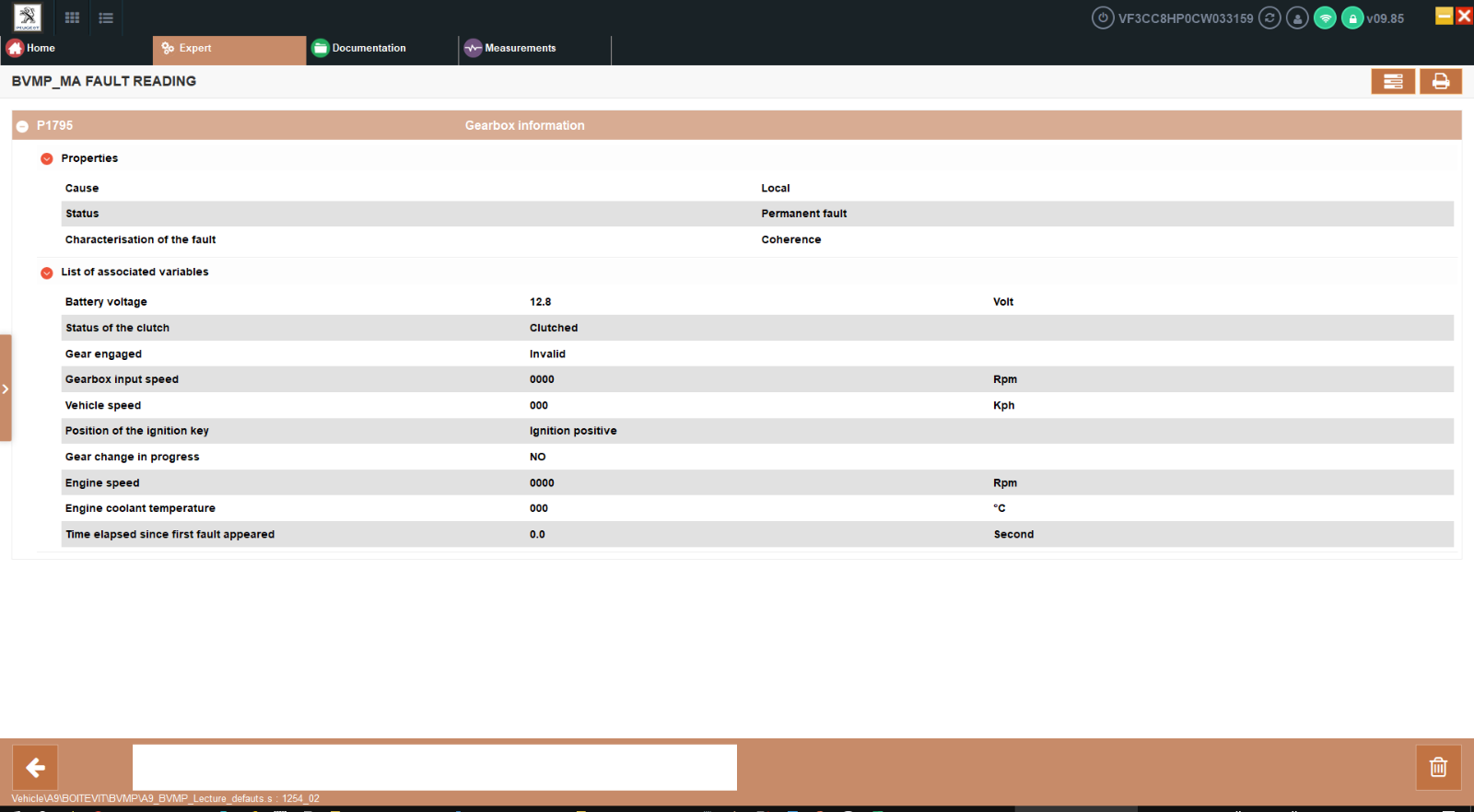

Car does not have any major faults, few from BSI and one from radio. From gearbox - only coherence.
