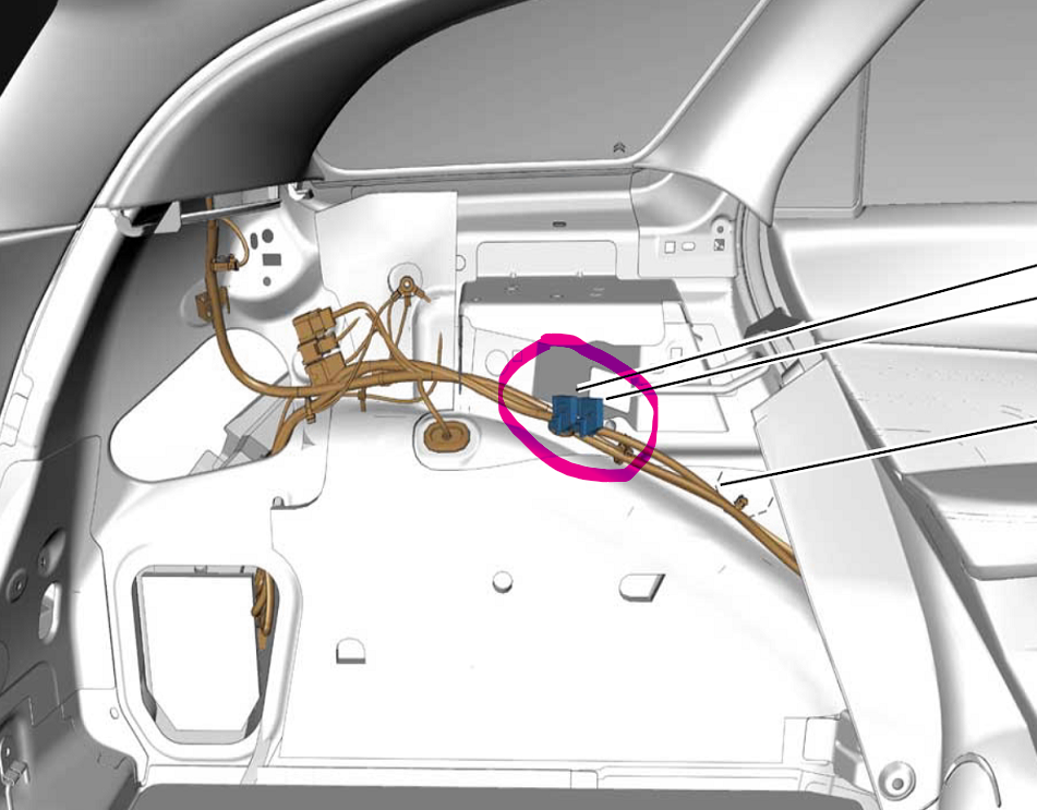

Posts: 42019
x 6919
Re: Ds5 diagnostic machine
Ok, so on a 2012 DS5, the parking assistance ECU is located in the rear left wing boot cavity area, so you can probably rule out water ingress from spillages - but maybe worht checking in there to see if stowing away anything has trapped or damaged a wire in the harness or the connector - doesn't cost anything to check this first:
Located here where I have circled:
Ds5 airdream
Posts: 26
Joined: 08 Oct 2022, 16:49
Unread post by Ds5 airdream »
Ok than you but I don't suppose you could tell me how to get the cover panel off ? I have taken 2 plastic plugs off but it's still secure and I can't see anymore plugs or screws. Peter
