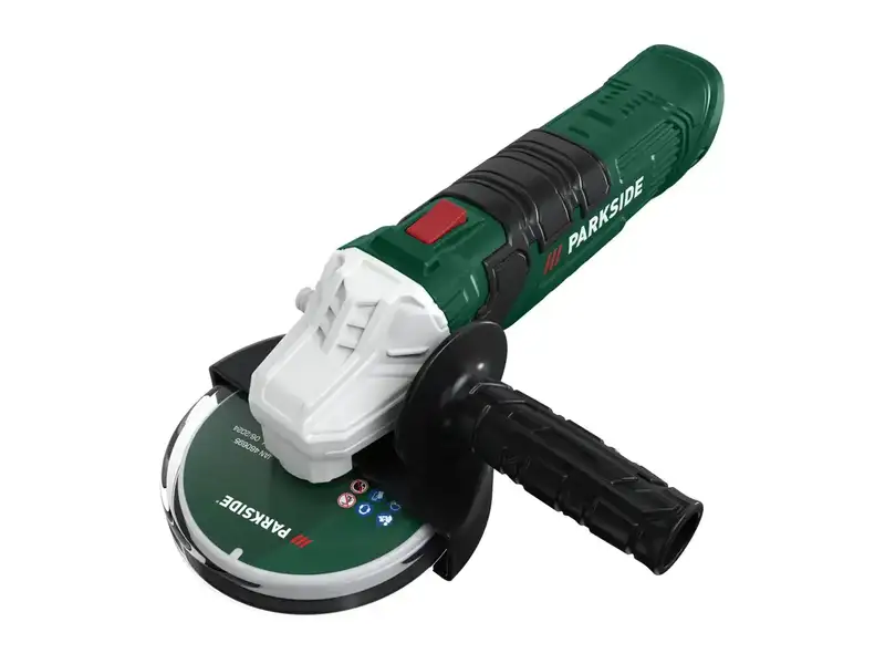

I still have a parkside one I bought before Covid that's been well abused and still works fine

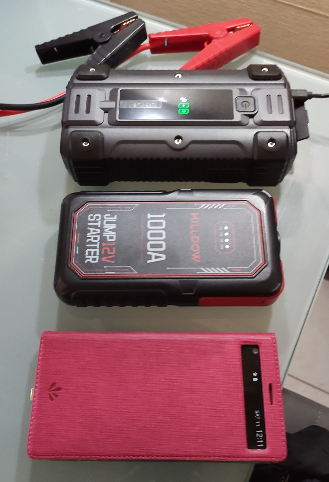

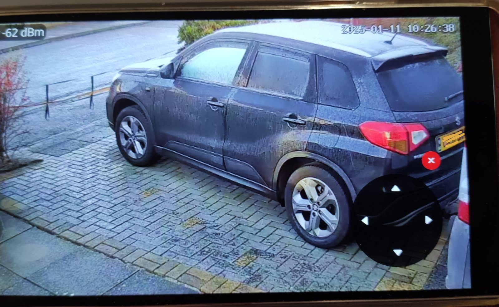

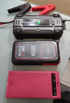

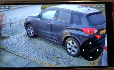

I am torn between elation and dispair. It was -2.5'c at 11.00 today and I finally got to try out my booster packs in earnest. Elation! My car battery is probably old and past it now. Dispair!
A bit of context - the car is fitted with a 3 camera cctv that works 24/7. So there is a small constant drain on the battery. It was showing 11.4v on a separate clock/voltmeter guage that similarly is wired to work 24/7 so I can see the gauge from outside the car ( assuming the windows aren't frosted ) This dropped to 10.5v after my first 2 tries with the Hilldow booster. The car would not start. More Dispair!
I changed the boosters over and used the BRPOM on the 1.6 DDiS diesel and it started first time. More Elation!
The Hilldow claimed to be able to start diesels this size and had a claimed 500a/1000a peak output. It dropped to 75% capacity after 2 attempts.
The BRPOM claimed to be able to start diesels well above this size with a claimed 600a/3000a peak output. It dropped to 93% capacity after one attempt.
When you try to get facts about these online you enter into the realms of gobbledegook and cherry picked "facts"
The first thing I noticed is that the BRPOM is larger and a lot heavier suggesting it had a larger battery since plastic and electronics don't weigh that much. So, bigger seems to be better.
So the review I saw in Project Farm suggesting the BRPOM was the best of the cheap boosters tested seems to be correct.

The Hilldow has a forced start/flat battery selector switch to increase the output but I did not use it. The blurb on Amazon claims it is suitable for 5.5l petrol and 3.5l diesel engines with 12000 mAh capacity and a weight of 380g. On Amazon as well, the BRPOM weighs in at 680g and 26800 mAh with claimed engine sizes of 10l petrol and 8l diesel. But hop around the web and you get different claims and specs.
I won't get a chance to try the boost button on the Hilldow today and the weather forecast is for improving temperatures so doubtful anytime soon, but I do suspect that the boost selector would give a significant increase in power but shuts off all the electronic safeguards built into the battery clamp leads. It would be a last resort thing anyway as unchecked power out of the small battery is not going to be good for it's longevity.
