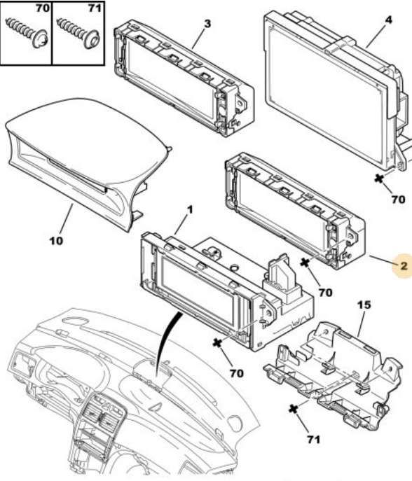

If you need any official parts, just ask for them on the official parts thread.
(2) MFD, EMF-C, part: 9821852480, £440.92
