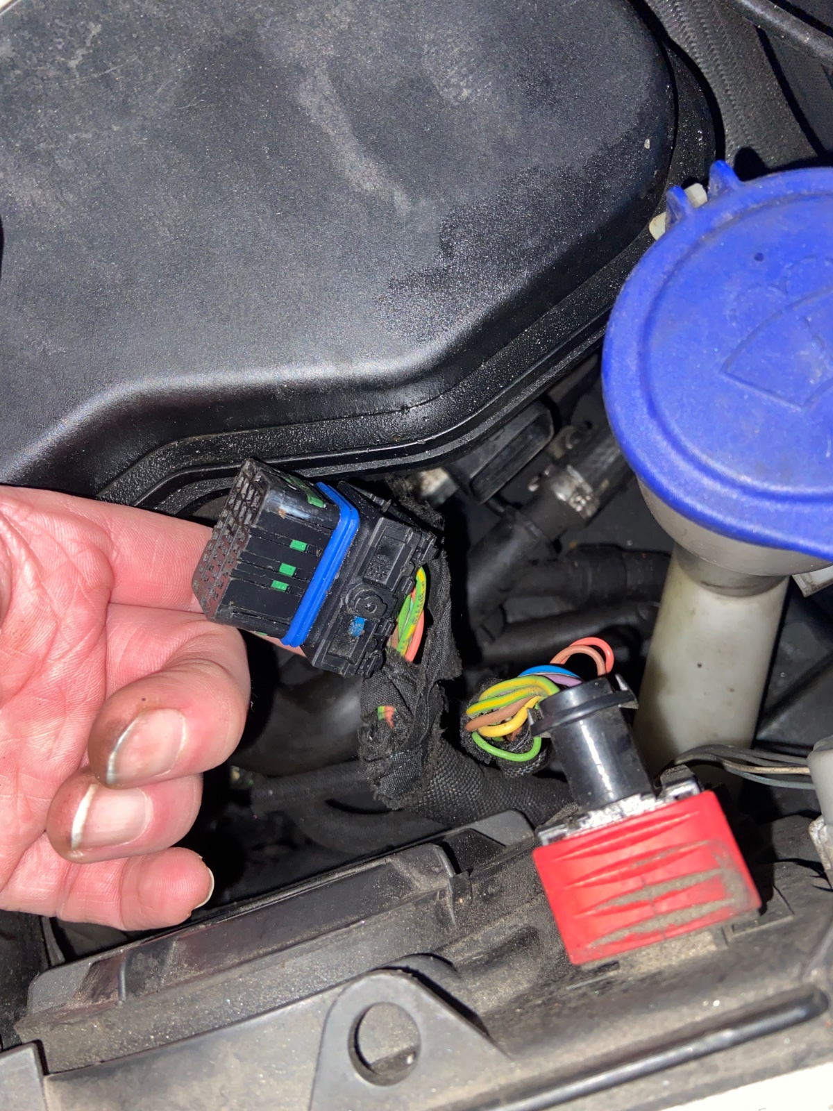

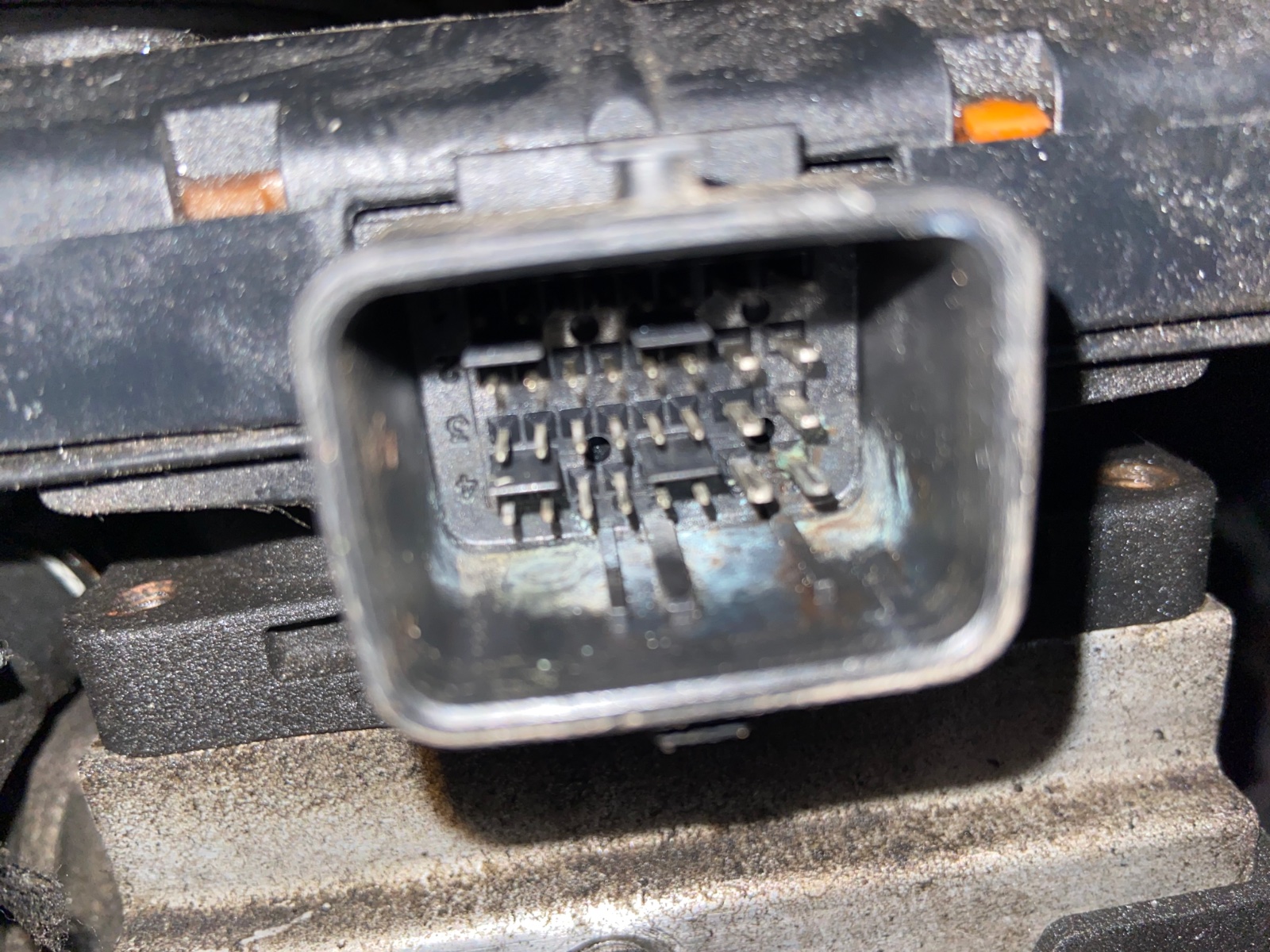

Many greetings.
We have now localised next issue at hand.
If the connector to the pump are half in and wiggled slightly, the pump runs. If the connector are inserted as it should be, it dies. Anyone with a good suggestion to which one to take apart first.
Have a great evening.
/A
x 6945
Re: BHI replacement
It can be either the pins, or the wiring connections to those pins or on the female plug. So make sure you use some good electrical contact spray (not WD 40) and check that none of the pins are loose.

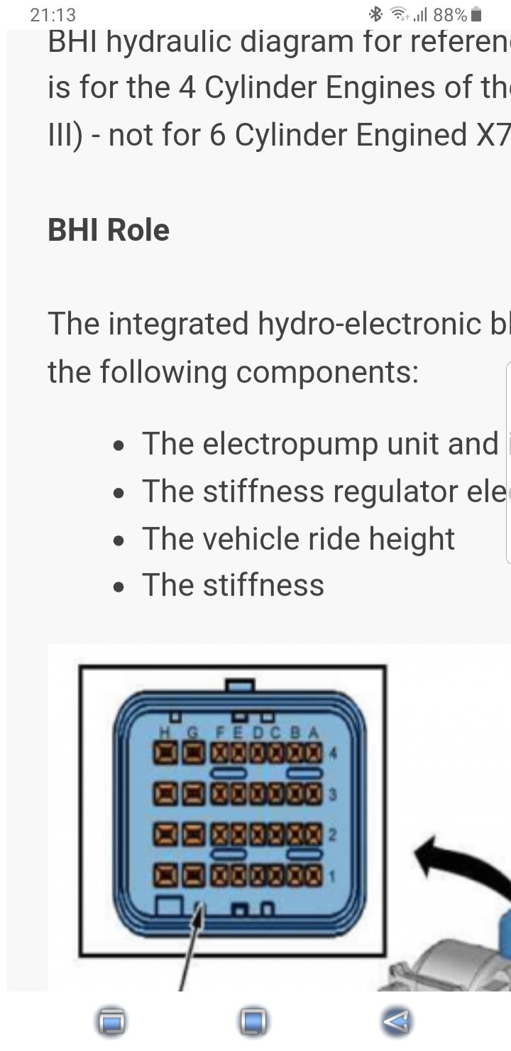

You have to check the brown wire from the pomp motor,
It's above the main connector with the 2 thick wires.
This one goes to the plug on place F2, this is the motor contol signal.
Greetings,
