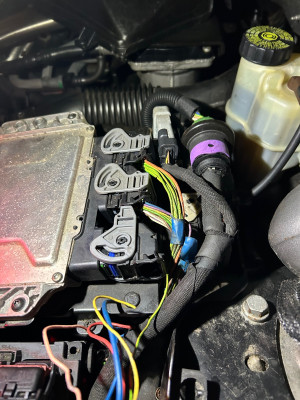

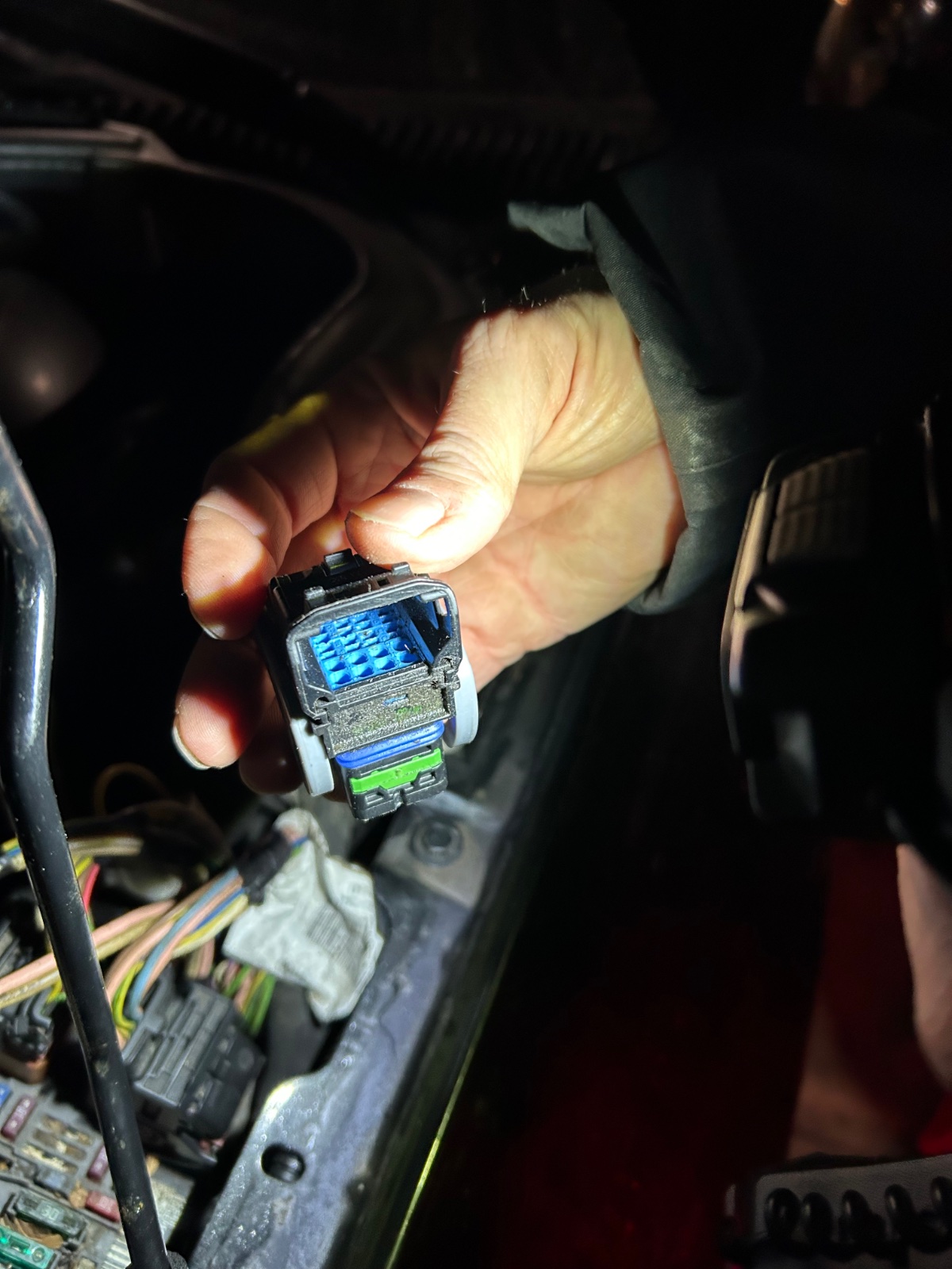

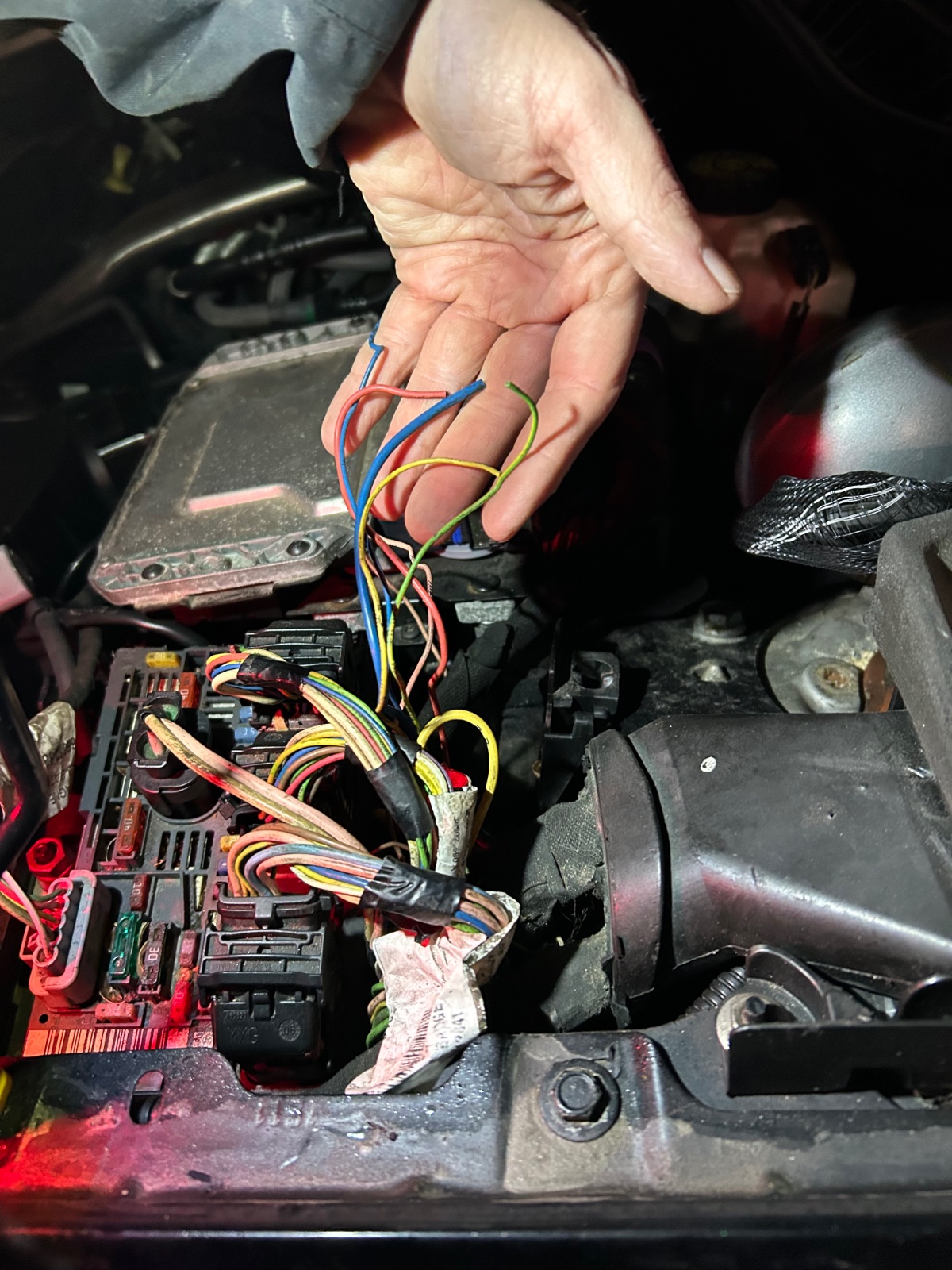

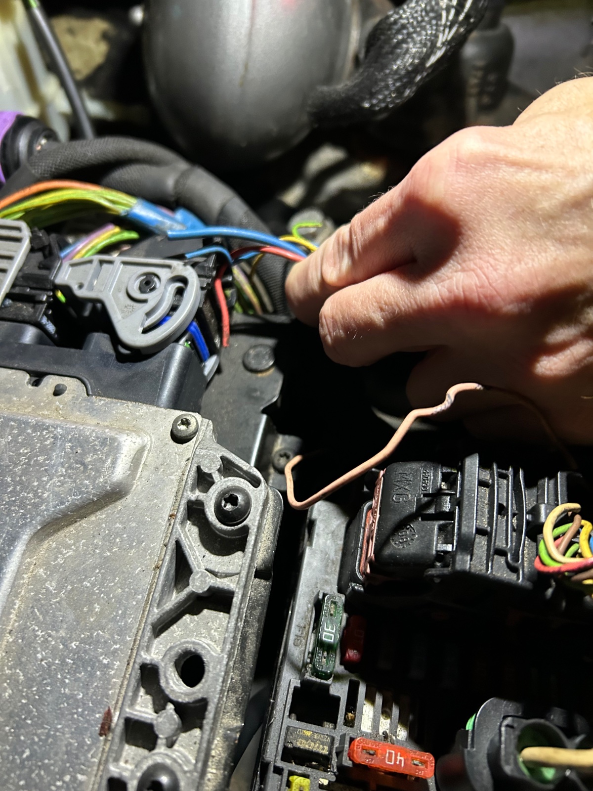

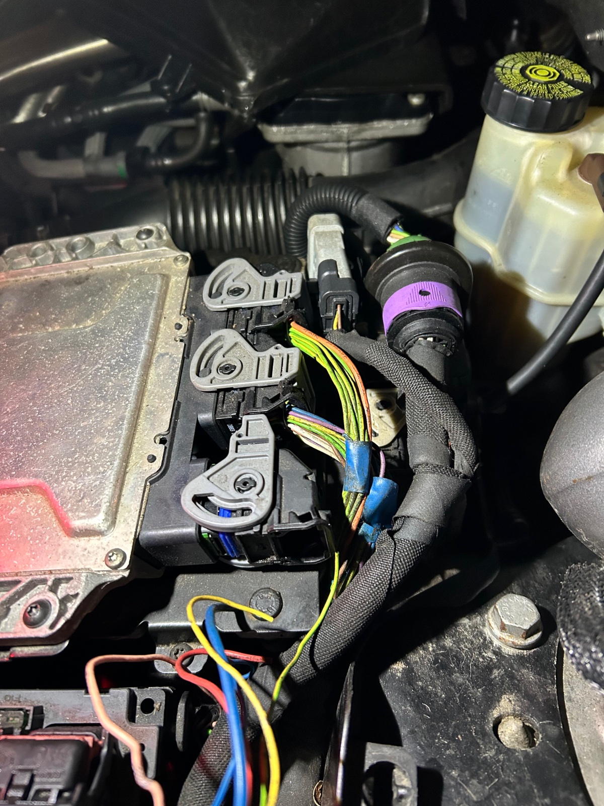

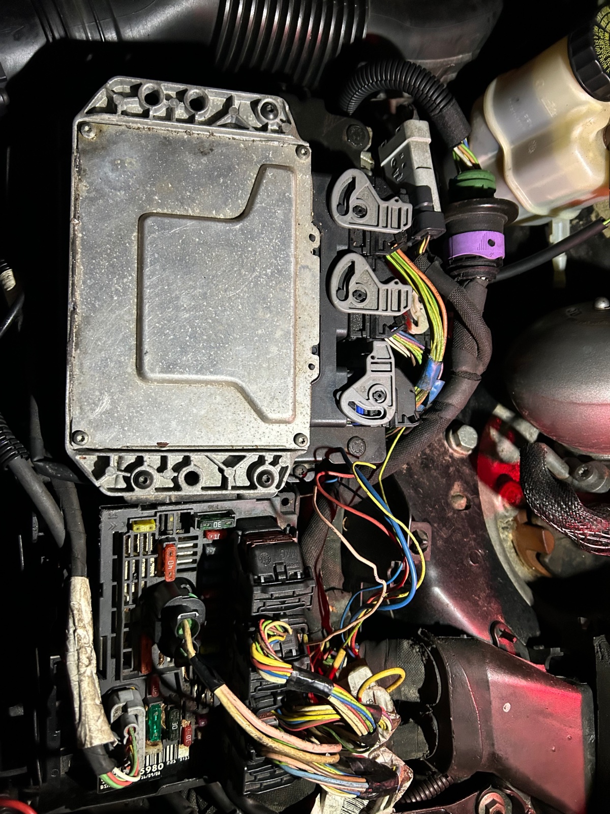

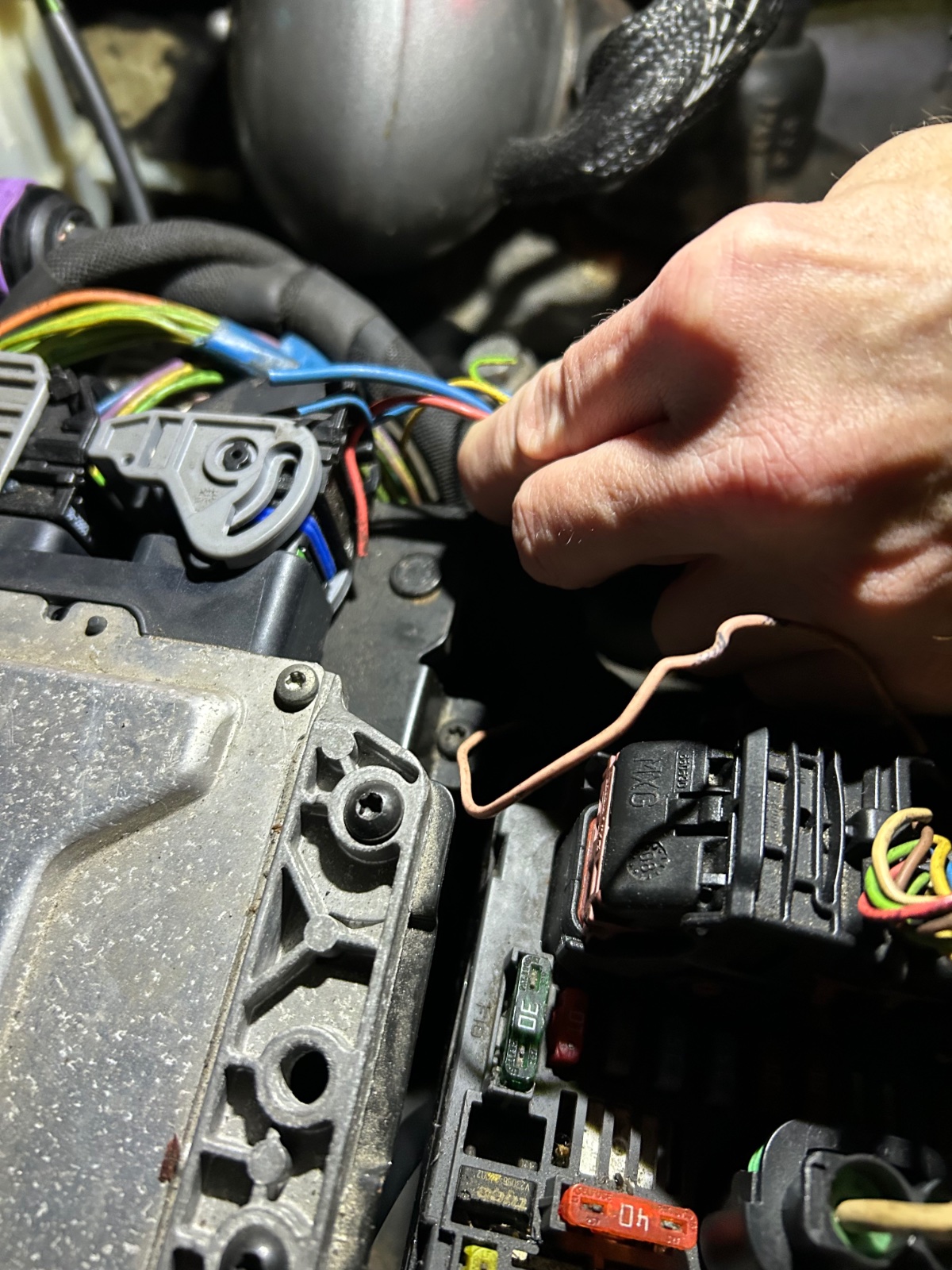

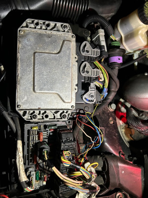

I just located some loose wires and an empty socket that I wonder if they are supposed to go together.
The pictures are from underneath the lid for the fuses on the drivers side under the bonnet.
I am not familiar with this car yet as I just bought it cheap for just the reason that the suspension is not working.
brgds
Andreas
brgds
Andreas

It might be because you are working on the connectors and wiring, but have you noticed 1 of the 3 connectors is not fully inserted? It’s grey locking lever is not pulling the connector in like the other 2 are.

Re: BHI replacement
This connector should be not be wired, this one is used with the C6 only.
Kees
- Posts: 571
- Joined: 16 Nov 2021, 16:16
- x 146
Re: BHI replacement
Try to find out, where these wires going to, i think, the thicker red and blue are power, and the other are sinal wires.

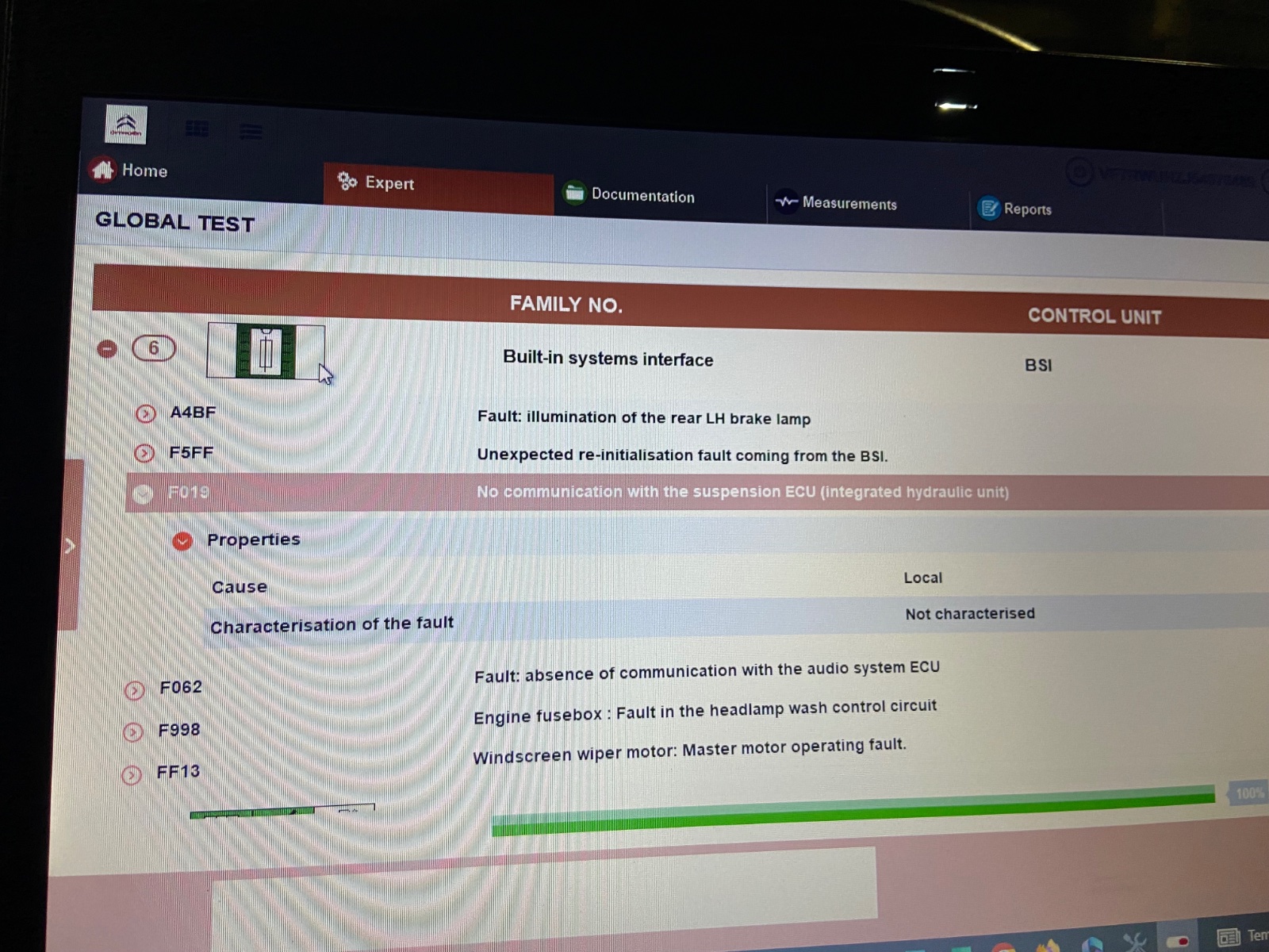

So the pump is working and I’ve got servo and no leakage so far.
Cittotraang
- Posts: 25
- Joined: 29 May 2024, 06:36
Re: BHI replacement

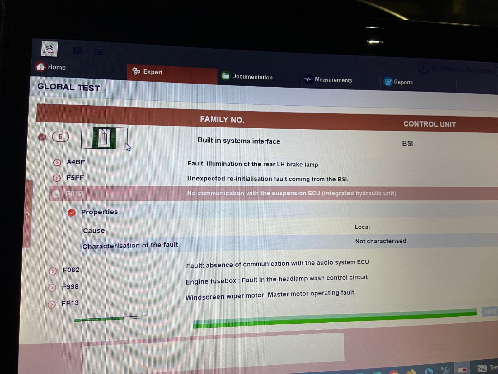

And I now get "Suspension faulty max 90km/h"
All related fuses are good.
All contacts sprayed and cleaned.

Possible to low pressure, check if the pomp is still running?
Check fuse F39 10A
Check connection with the high sensors and the stiffness regulators.

Any new error codes?
Cittotraang
- Posts: 25
Re: BHI replacement
No. Every good idea will be tried and reported back. The pump runs, all fuses good. Still F019 on the diagnos and suspension faulty max 90kmh.
