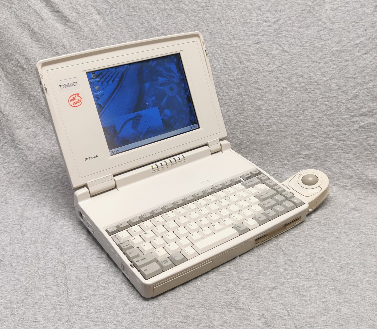

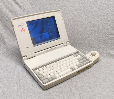

CitroJim wrote: 20 Dec 2024, 14:47
Zelandeth wrote: 20 Dec 2024, 13:38 I do have something of a soft spot for portable Toshibas. Though for some reason I can't seem to get the installer you're all talking about to run properly on the one I use most regularly. No idea why it won't work...
Maybe you need to update its USB drivers Zel ;) :)
I well remember those :cool: And just about all generations since...
One in that style I had would run Windows NT4 very adequately and it had the matching tracker-ball mounted on the side in lieu of a mouse...
One of that generation most likely if running NT4...
Which is about the newest one of theirs I think I own.
Also own an unreasonable number of their giant grey granite slabs of desktop-replacement machines too, but it's the little T1200 in my previous post which actually gets used the most.

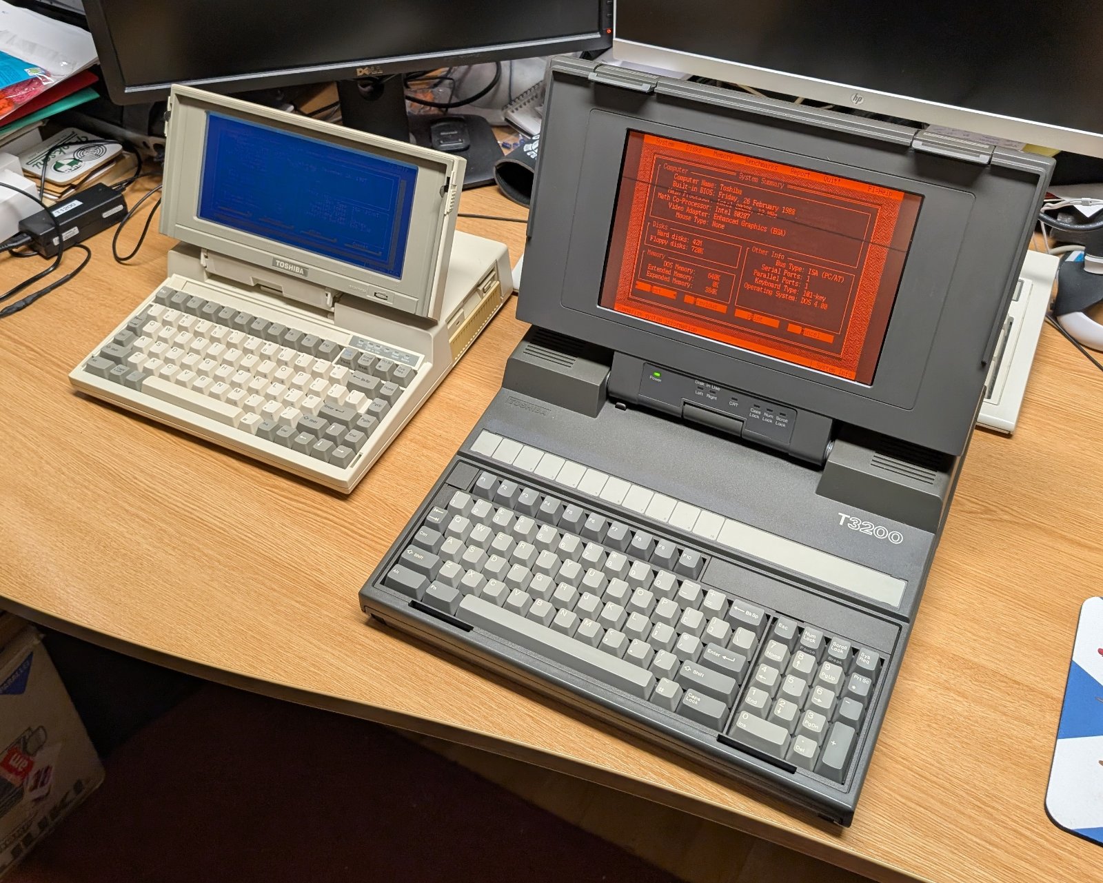

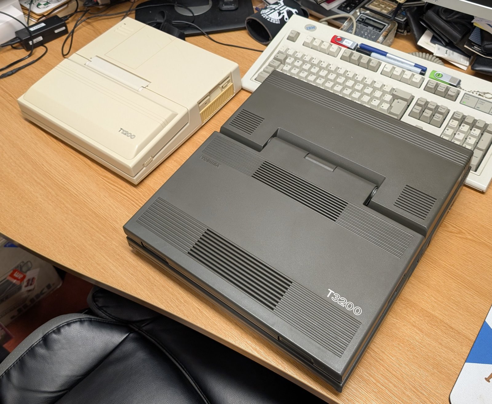

CitroJim wrote: 20 Dec 2024, 16:10 That's the one Zel :D
Couldn't resist an excuse to dig the T3200 out. Here were probably the best truly portable computer of 1987 in the T1200 alongside the most powerful all-in-one system you could pick up and take with you from 1988 in the T3200.
Granted you'd not want to carry it too far given it's even heavier than it looks.
I'll quit dragging this thread 30+ years off topic now...Even though it would be interesting to know if anyone has a piece of IT equipment that's anywhere near this old that they still regularly use for actually useful purposes.
Those both do actually have Windows on, albeit not really being there for any reason other than for demonstration purposes. All of the software I actually use just runs from DOS.

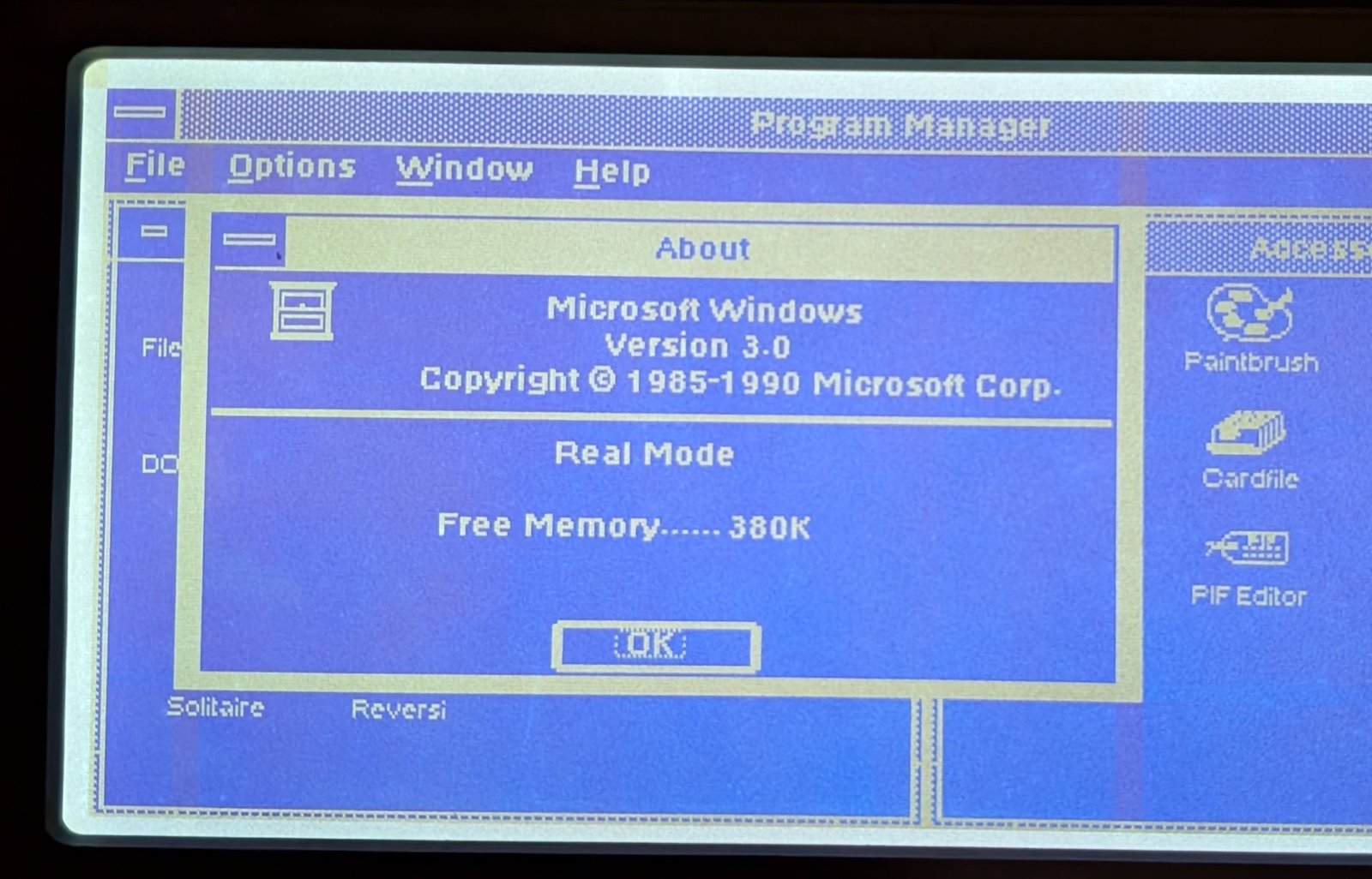

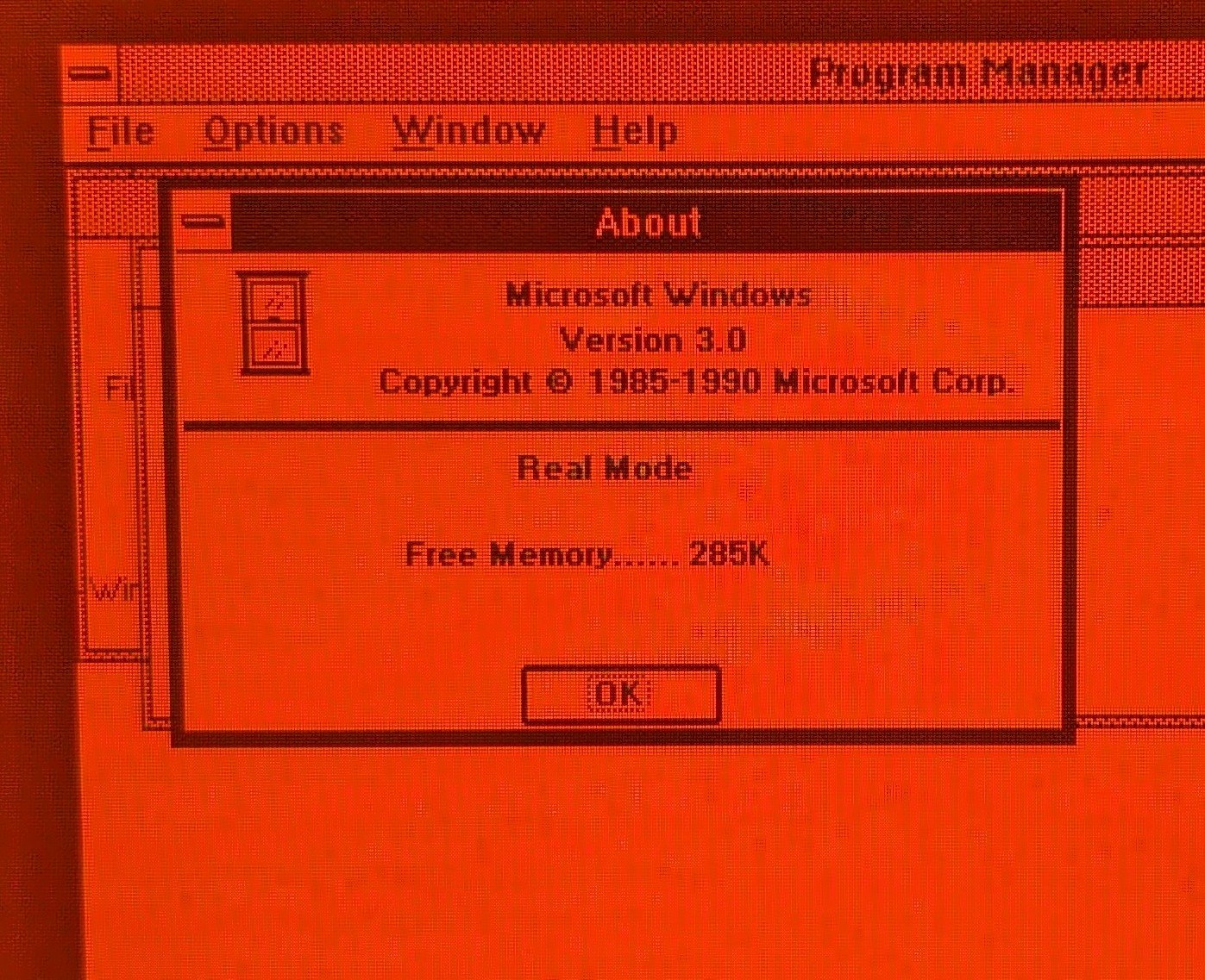

Zelandeth wrote: 20 Dec 2024, 17:47 Those both do actually have Windows on
What version? I'll take a guess at 3.0...
3.0, IIRC, had a minimum requirement of a 386 processor. 2.0 would run on an 8086 with 512k of RAM, but was not much use for anything, due to a lack of Windows applications.

xantia_v6 wrote: 20 Dec 2024, 18:57
CitroJim wrote: 20 Dec 2024, 18:21
3.0 was the last version which will run on an 8086, 3.1 required a 286 at minimum, or 386 for enhanced mode.
It's 3.0 I've got on both of these.
