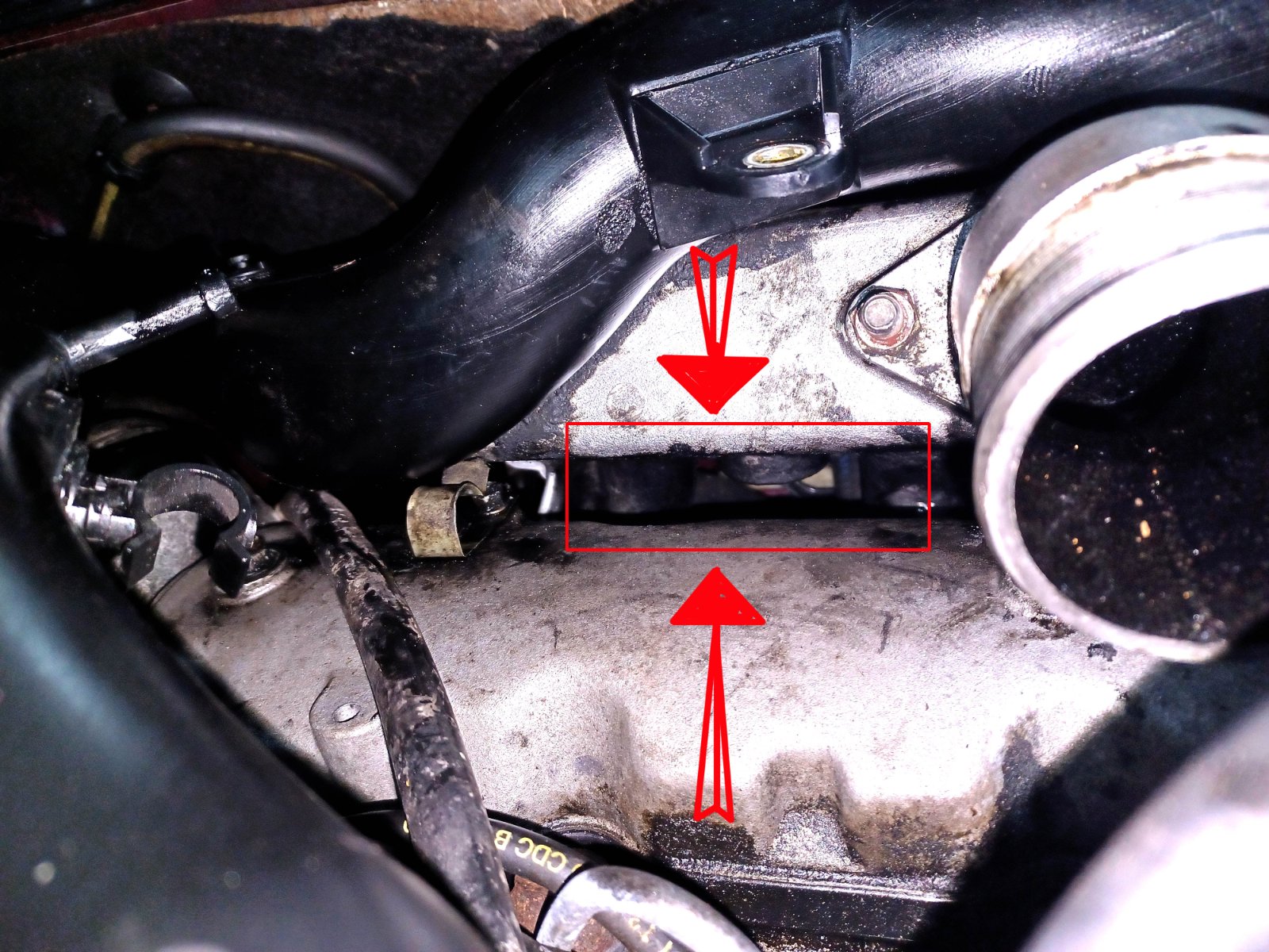

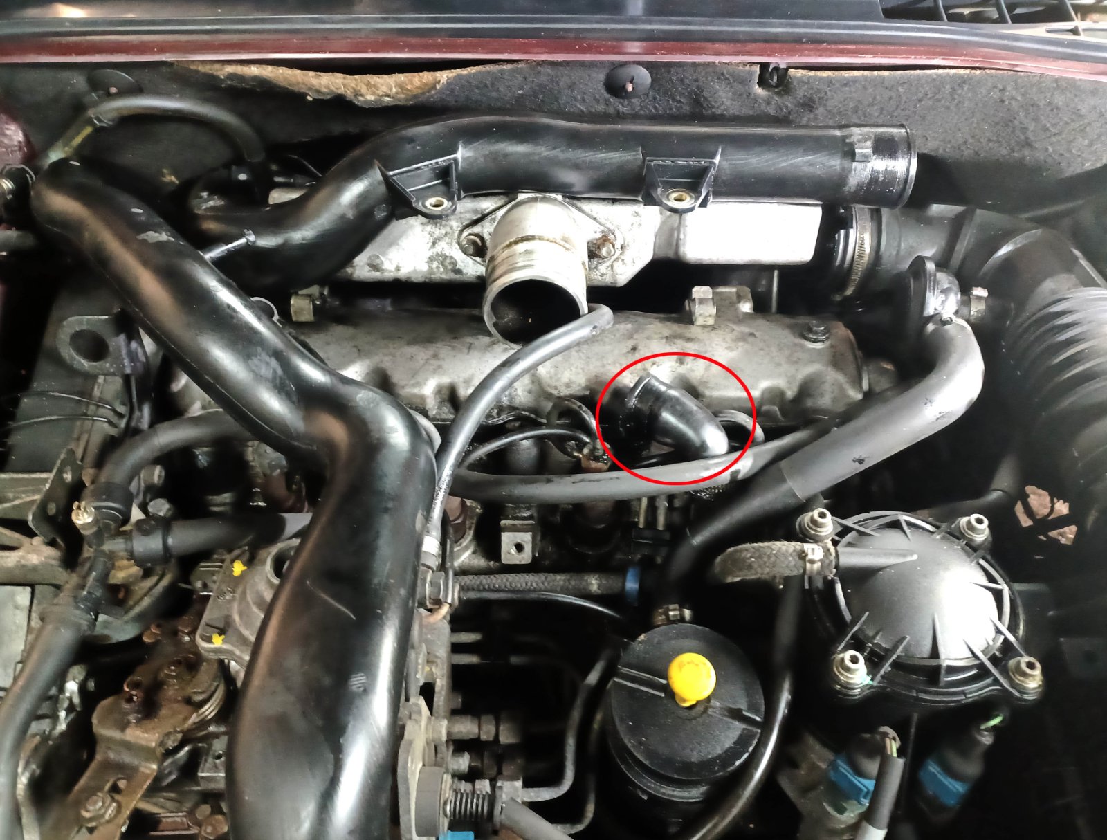

Well this seems like a pain in the harris to solve a very small oil leak..... ever wondered why you bother starting jobs !! ?
Looks like the whole intake manifold needs to be removed to take the rocker cover off....great !
Vac pipe crumbled...of course it did !....they all do that after 30 years Sir :).....and it may be that it was only the Vac pipe that was the source of the oil leak because.............
two of the rocker cover bolts were not even finger tight !..... which of course I found only AFTER the breather pipe crumbled
and..............Post count Posts: 11111...what is going on with this then ??

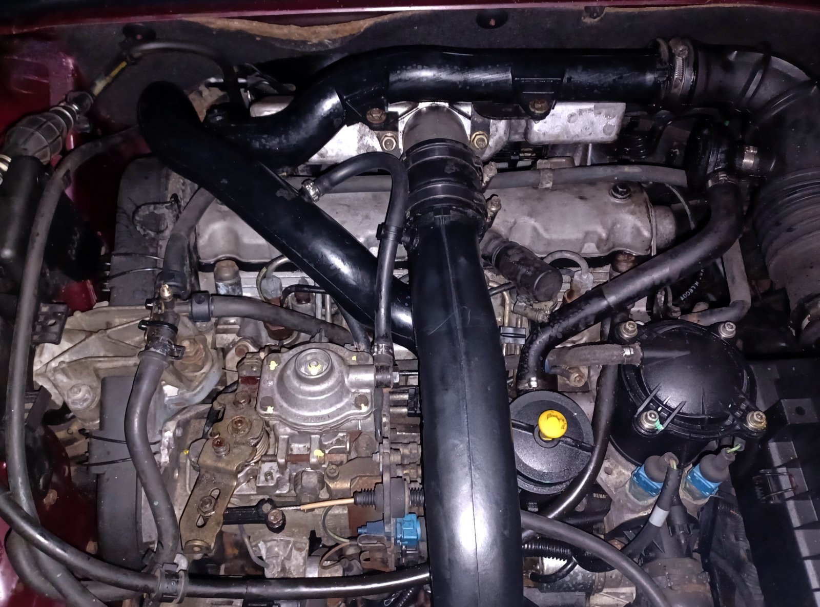

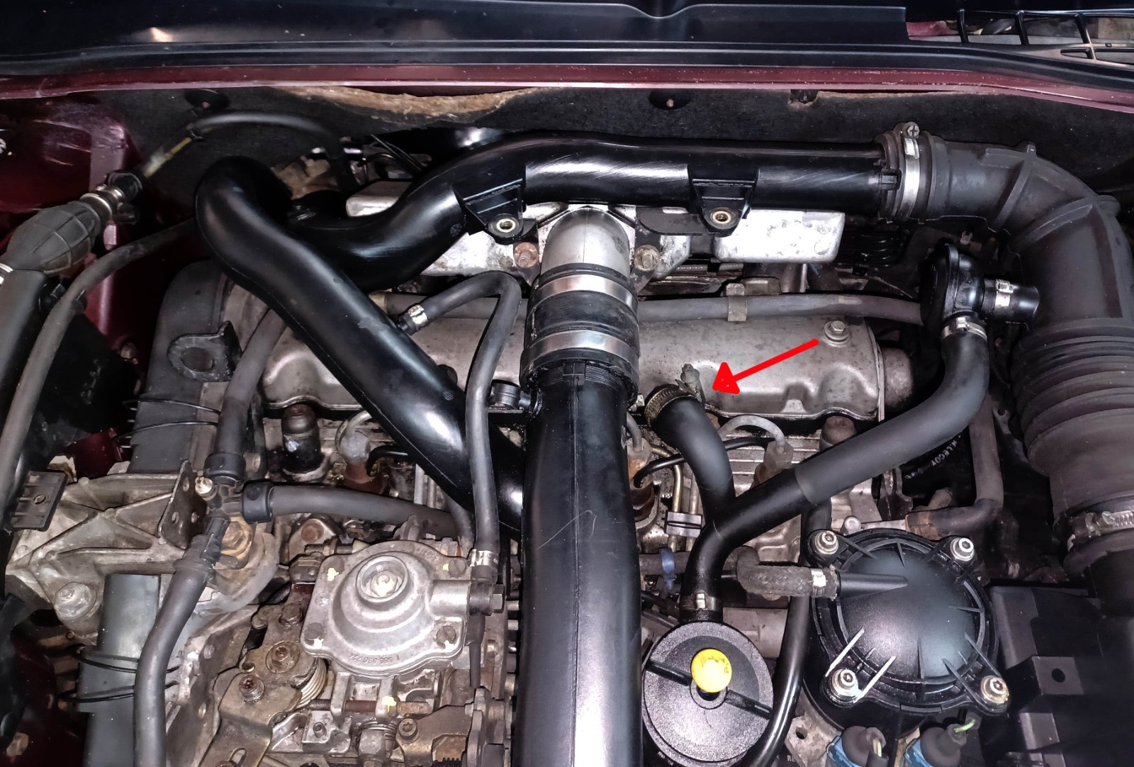

and all back together again........all I did is cut and insert a new pipe to fix the breather pipe leak/split pipe end. A few pipe runs needed to be corrected/spacing clips added to prevent chaffing as it had not been put back together properly at some point.
1. I decided NOT to remove the cam cover because with the two outer cap screws tightened correctly I hope that will solve the leaking oil.
2. Not much is leaking anyway, it does not "cook" and oil is cheaper than a new gasket :)
3. It is a real pain to remove the intake manifold etc just to save a "little oil"
4. Taking into account No2&3....I really cannot be arsed !
5. Any oil spray is a good rust preventative
6. An old diesel traditionally has a small leak
Logic care of my mate with a LandRover collection :)

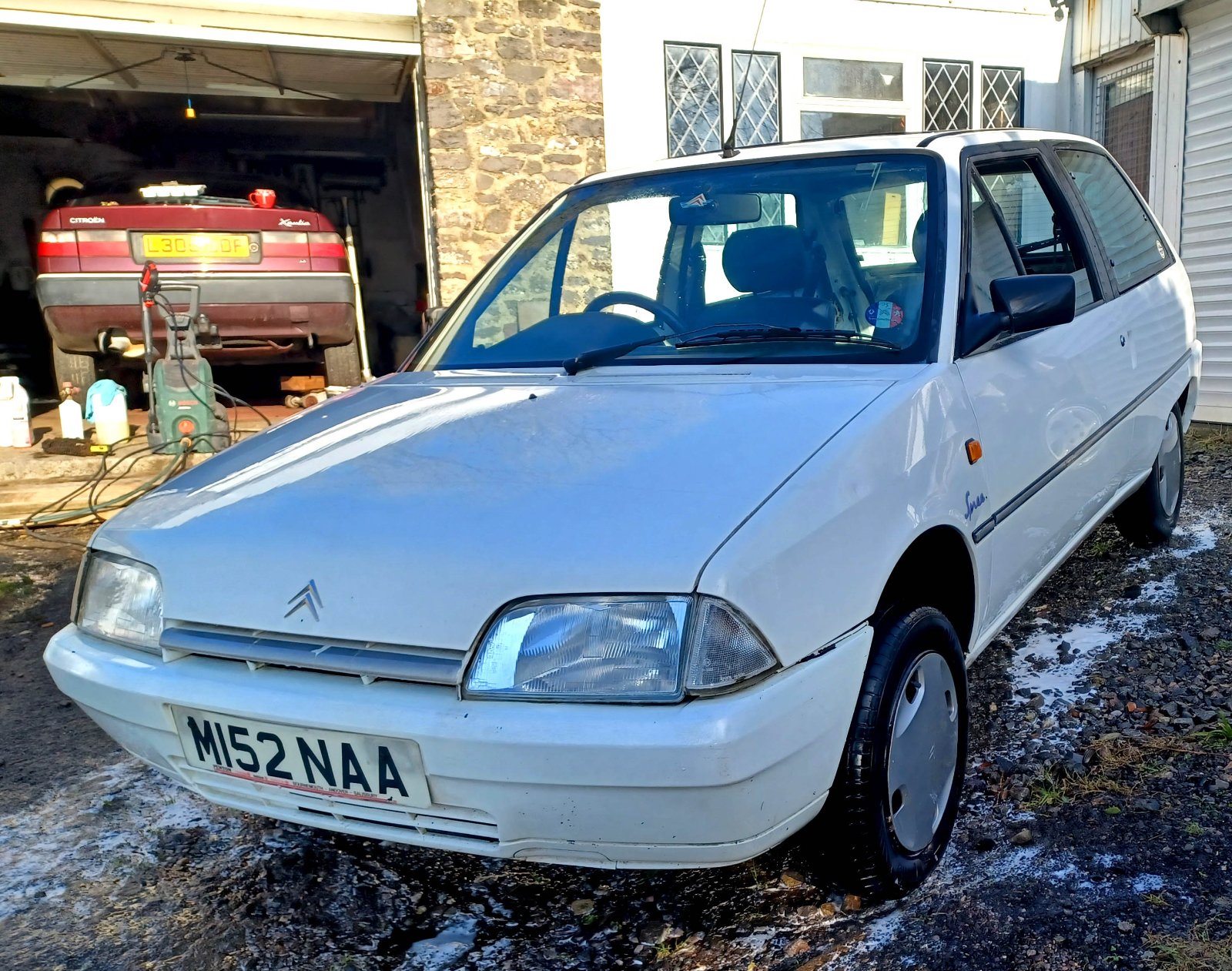

I good wash and brush up was much needed....MoT on Tuesday

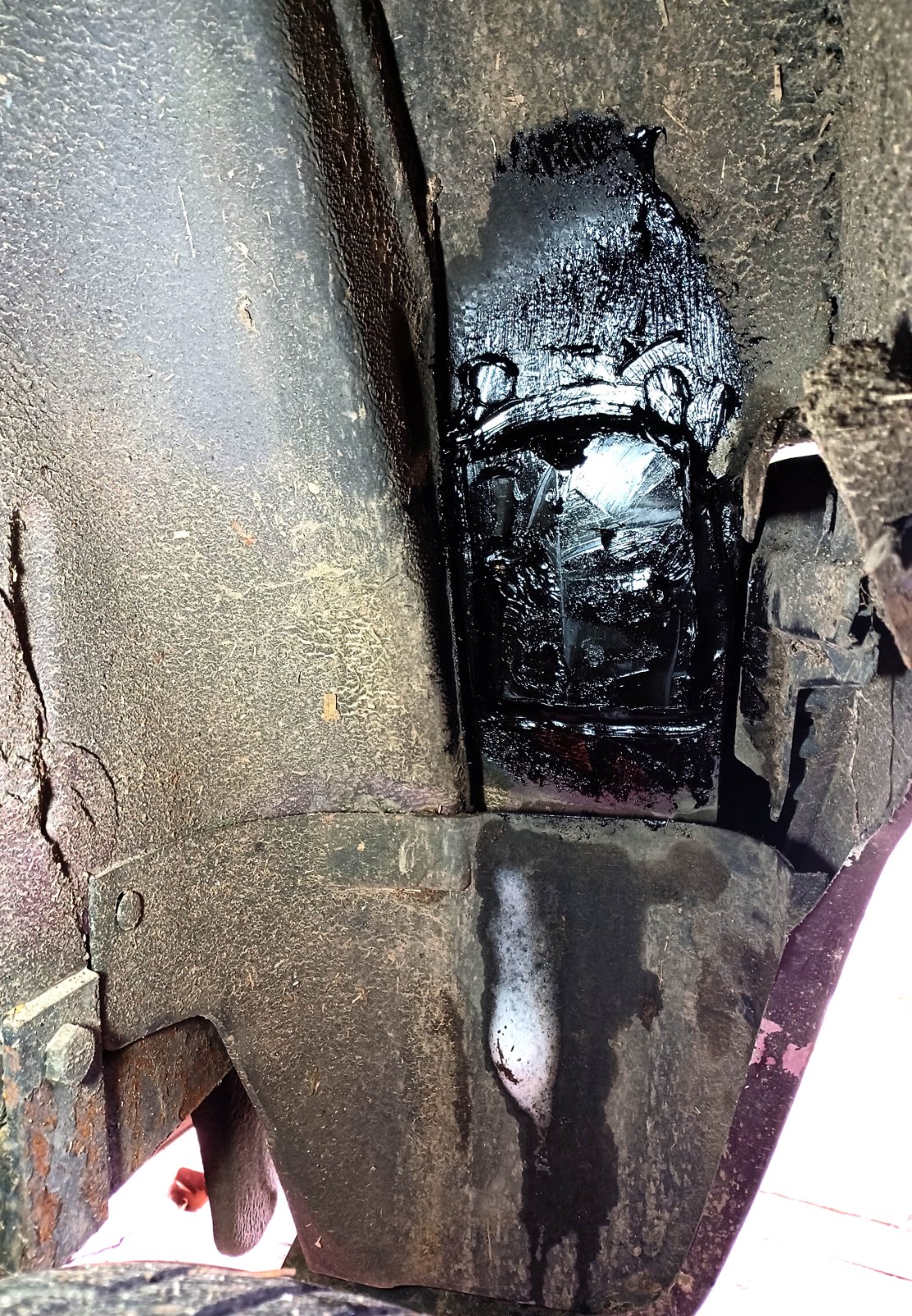

....... and the rear left wheel arch "hole of death" blocked up with a piece of spare under-tray plastic bonded in place & its edges sealed with Bilt&Hamber underseal
