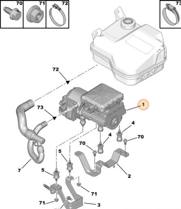

Hi guys would you be able to tell me the correct pn of my pump, as it is looking like I will need a replacement
- x 6957
Re: Depressurisation X7 C5
Just put all future part requests up in the parts thread please, so it is not missed:
Official Parts Thread
(1) High Pressure Pump:
OEM New (requires configuration), part: 5277K1, £2056.81
Standard Exchange Pump (requires configuration), part: 1680916480, £1318.30
