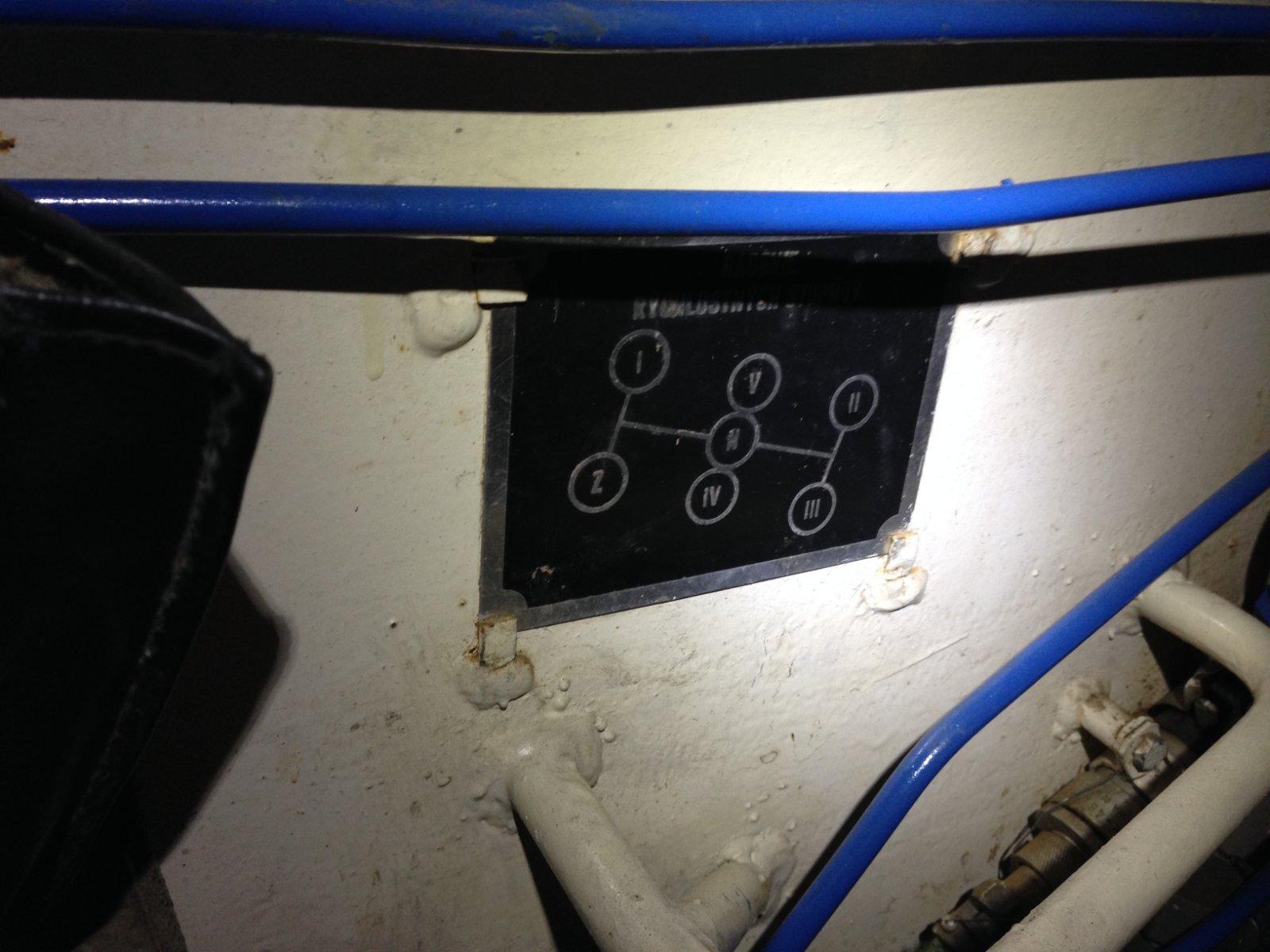

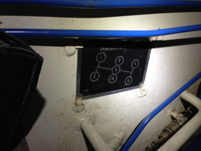

I had a go in an armoured tracked BMP 'tank' once. Yoke steering and manual gearbox. The gearbox gate looked like a drunk Russian had thrown some numbers at the hull, and where those numbers fell, that would be the gearbox layout. First gear was 'up there', second was 'somewhere over there', third gear had its own agenda, forth was only for the brave, and so it went on. 'twas good fun though :)
Edit:
I hadn't remembered I'd got these photos, but here's one of the gearbox gate - 1 through 5, with reverse down left. The gear linkages were joined with specially worn out pivots and pins #-o
BMP gearbox layout - own work

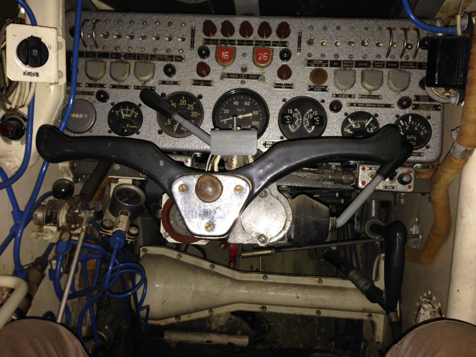

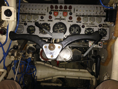

And here's one of the dashboard with yoke steering...
BMP dashboard - own work
Sorry for hijacking your thread, Matt 8-[

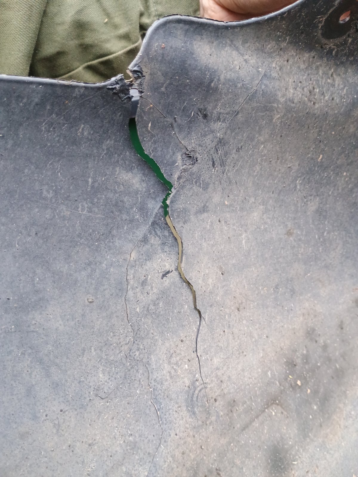

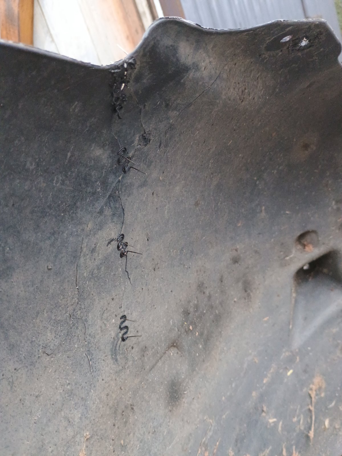

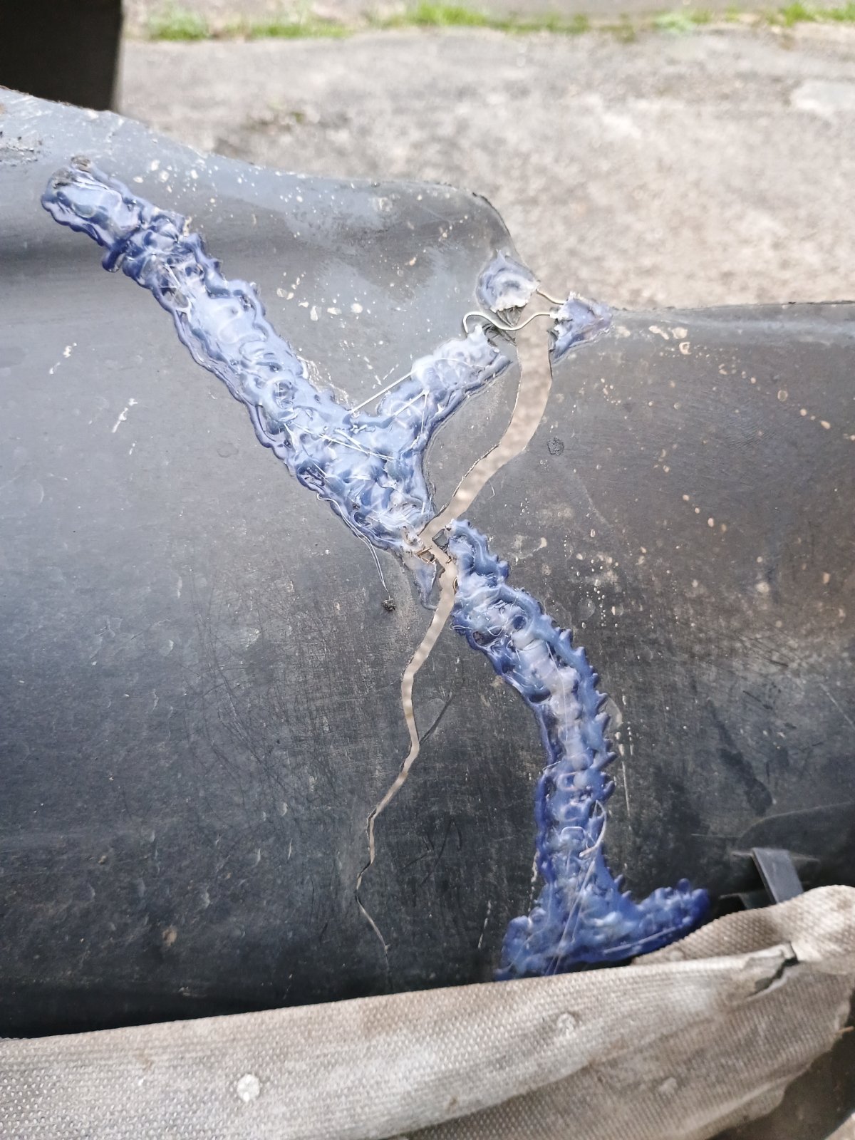

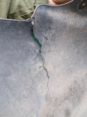

First failure of a previously hot stable repaired component:
308 SW front left wheel arch liner big cracks.
However good news it's failed in a complete the different direction to the previous repair!!

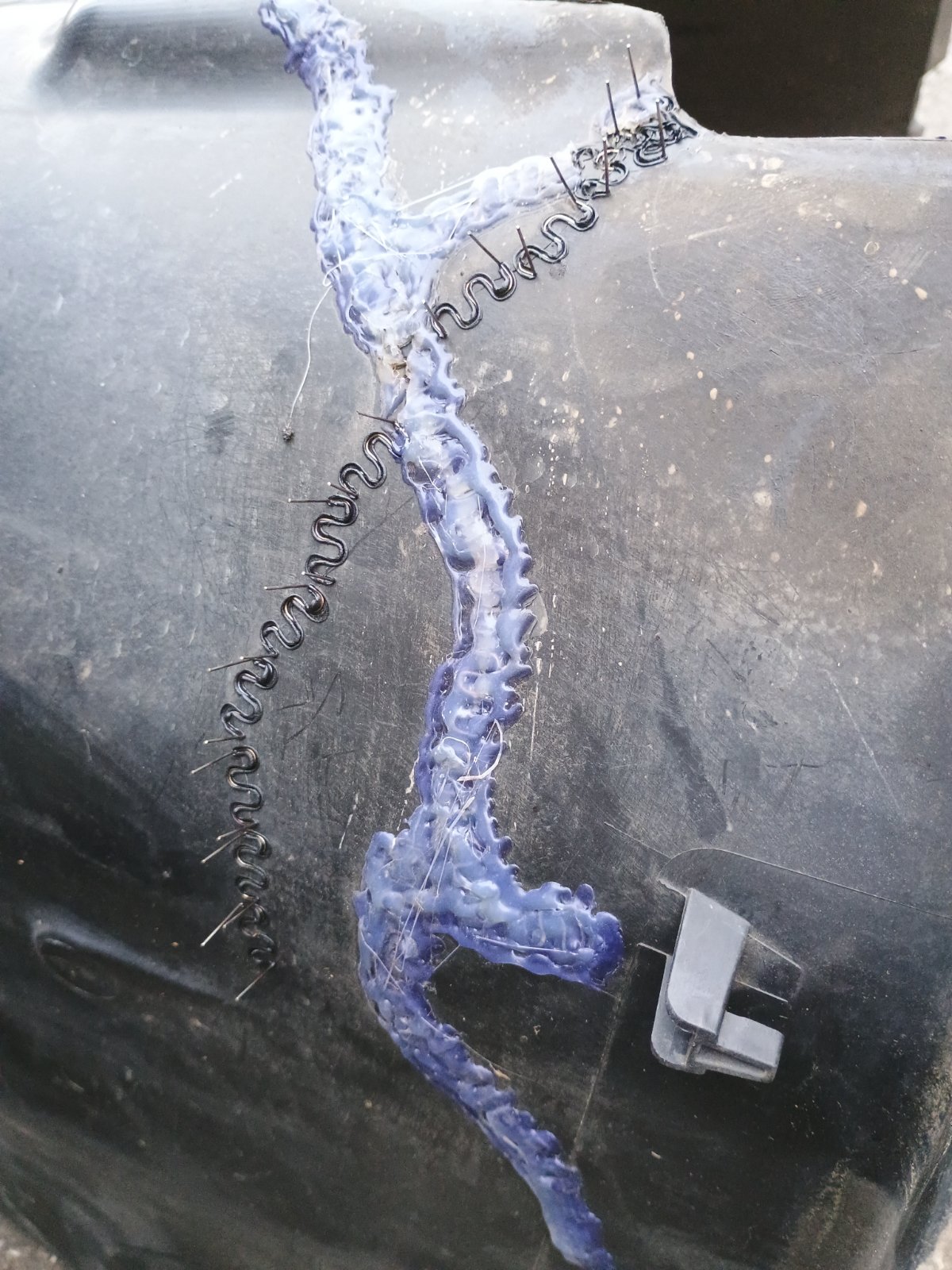

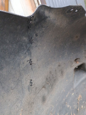

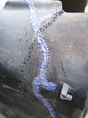

Round two!
Just a few added from the other side as well for good measure

Unread post by Huskyxantia »
Good fix there Matt.
:-D
Posts: 5364
Joined: 25 Apr 2022, 09:03
x 2367
Unread post by MattBLancs »

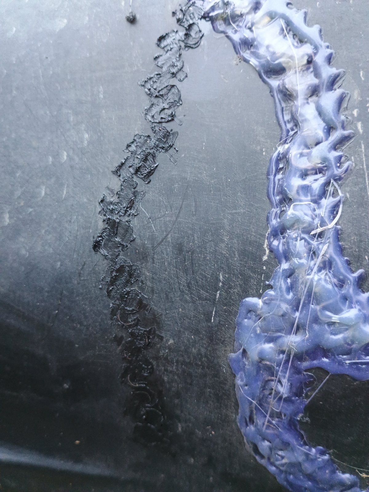

Huskyxantia wrote: 12 Dec 2024, 13:56 Good fix there Matt.
Hope so! :-D
I thought the Staples would benefit from being fully encapsulated. Last time I did this with the hot glue gun (the light colour stuff splodged everywhere on the previous repair) but this time I just smoothed over the black liner plastic with the soldering iron
Posts: 21358
x 8161
You'll find black cable ties make a perfect filler for that type of 'plastic soldering' Matt. I use them all the time where melted plastic is a requirement!! :-D

Yes, don't think I've thrown a cable tie offcut away recently!

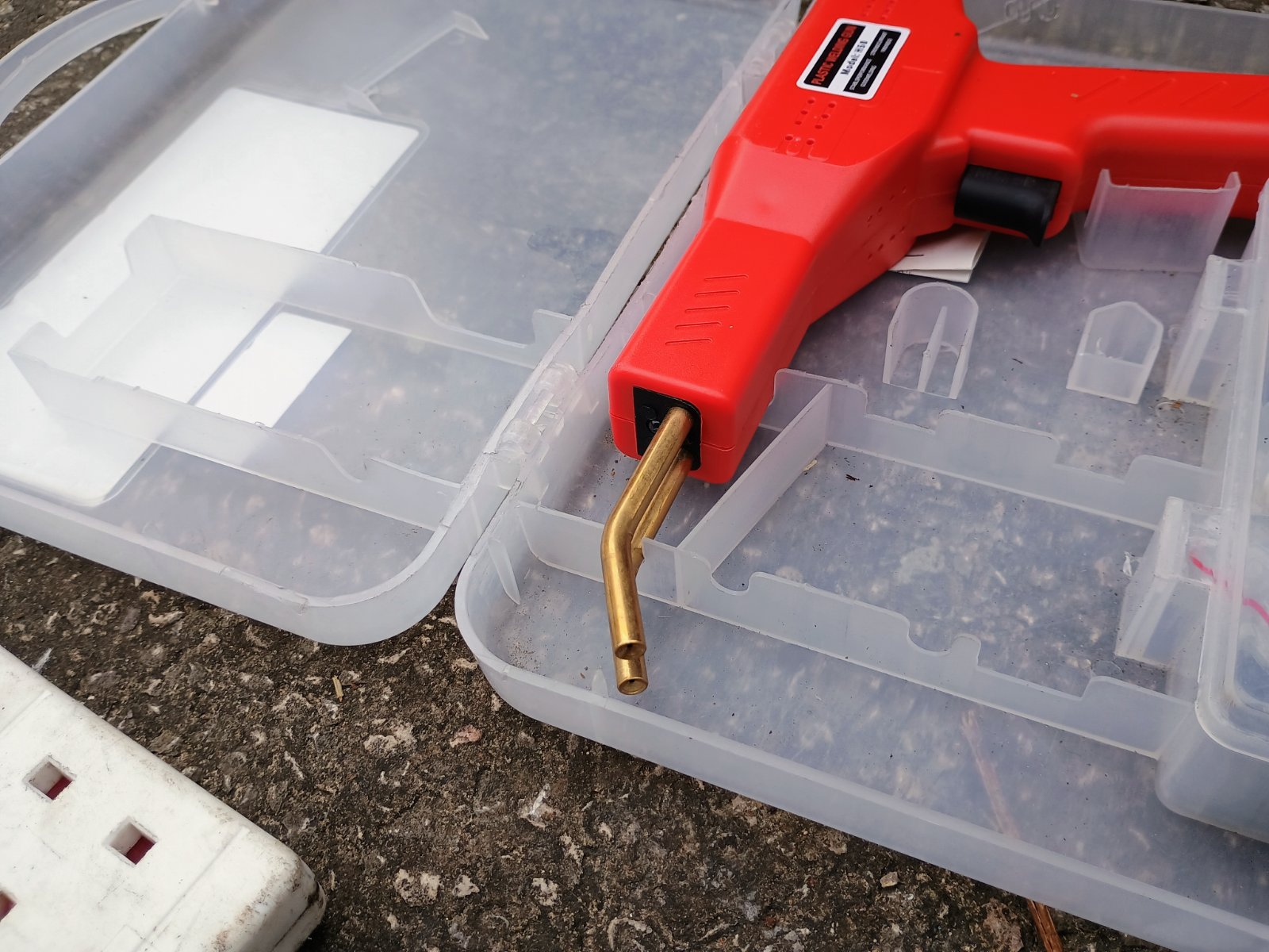

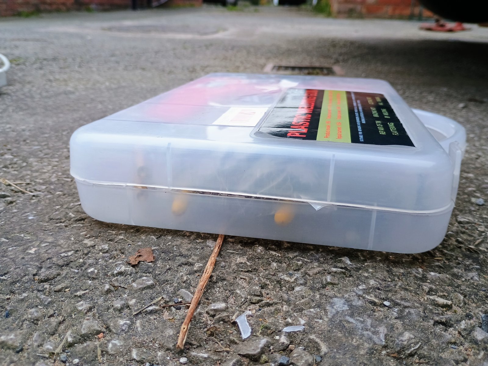

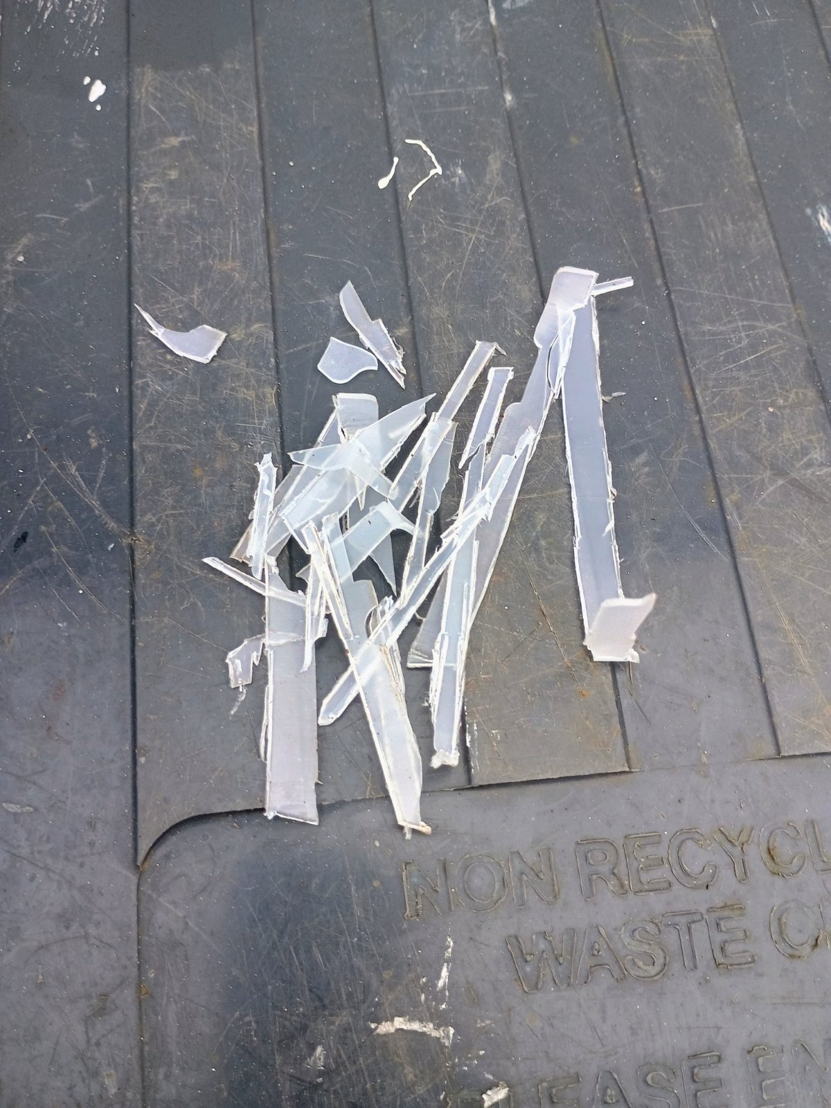

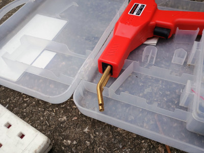

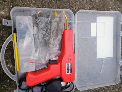

Just doing a very quick crude mod to the hit staple tool's box
Posts: 5364
x 2367
MattBLancs wrote: 12 Dec 2024, 14:24 Just doing a very quick crude mod to the hot stapler tool's box

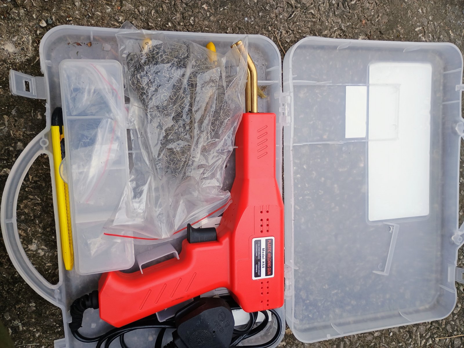

Since buying a thousand extra staples, I've had the problem of where to store... a thousand staples! Annoyingly the hot stapler machine has only 4 tiny boxes for staple storage.
Before
Before
So, attacked with a pair of end snips, cut out the features intended to hold the (rubber!) side cutters and snap off knife supplied with the kit.
First time that lid has closed properly in months!
Posts: 21358
x 8161
Aah!! You have a different kit to me Matt, my 1000 extra staples fit inside the box as it is still in their supplied zip bag!! :-D
Posts: 5364
x 2367
mickthemaverick wrote: 12 Dec 2024, 17:40 Aah!! You have a different kit to me Matt, my 1000 extra staples fit inside the box as it is still in their supplied zip bag!! :-D
Yes I went to the trouble of taking pictures to then realise I was potentially offering a solution to a problem you didn't necessarily have! :-D
