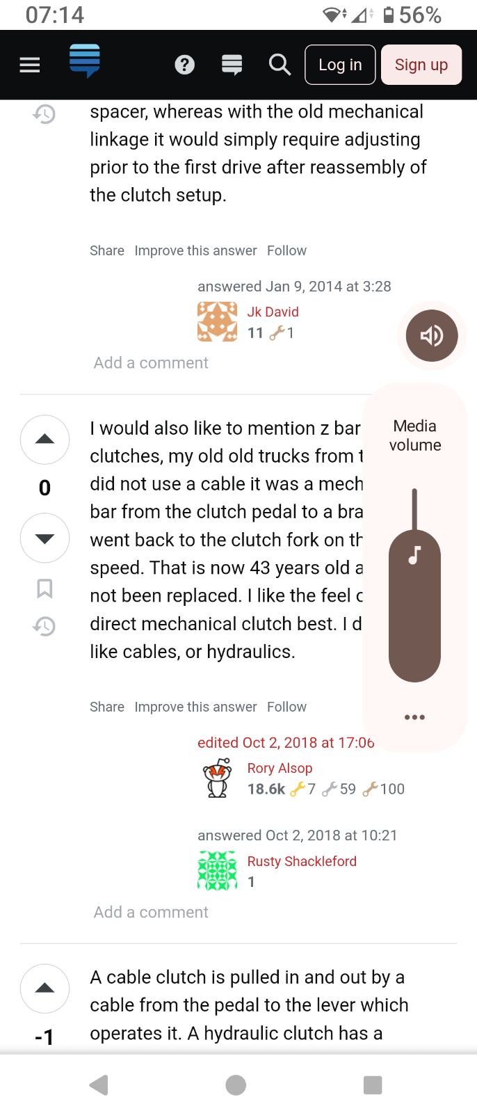

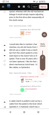

It would appear that solid rod clutches have been used in the past as evidenced by this answer on a technical clutch forum:
Screenshot
Screenshot
I am still investigating! :-D

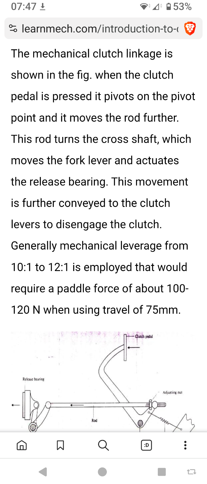

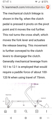

The only vehicle I have found with the 'mechanical' clutch is the early Mk1 Ford Transit but I did come across this description which has satisfied my curiosity: :-D
Screenshot
Screenshot

Very simple and clever use of levers and from the numbers not a very stiff clutch either why was this not continued I wonder.
Darren
x 3565
Presumably you'd get small amounts of unwanted movement in the mechanism as the powertrain moves in relation to the body under acceleration and braking. :-k
Posts: 21199
x 8126
Yes I think that is highly likely bobins, which would mean some sort of shock absorbing in the linkage which would introduce extra movement to 'close it down' when operating the pedal. So some form of physical isolation between the gearbox and the pedal, how about dispensing with the solid rod and using a flexible cable to link them? :-D

I was thinking there might be kick back from it. Just to be clear I have no issues with hydraulic slave as it is the best way to deliver smooth movement. its just the fact that they now stick it inside the bell housing which means you have to remove the gearbox to replace it

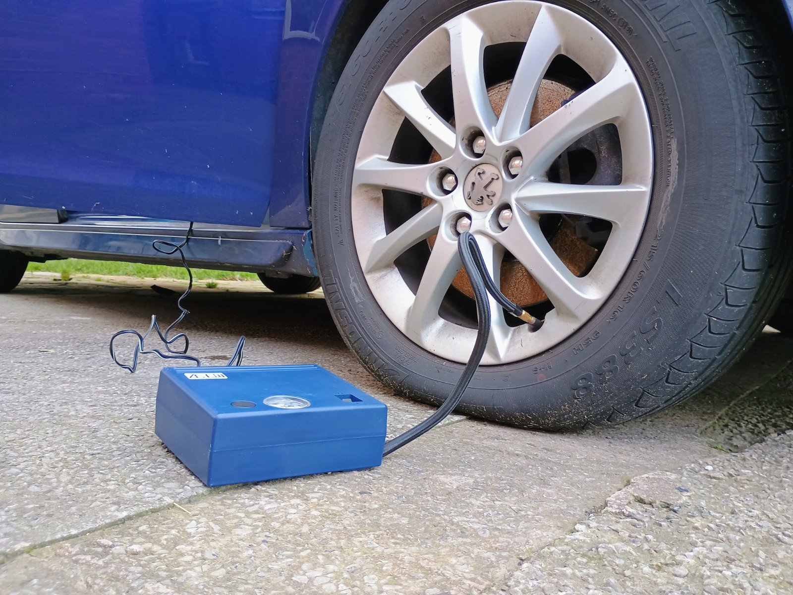

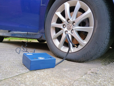

I've finally got fed up with the slow puncture. Tipping point was pumped up to 2.7 bar on Sunday and tyre pressure warning half way to work on Tuesday morning! :evil:
So, Landsails will be jettisoned and a pair of new Yokoyama on instead.
All four with match in terms of brand and tyre size.
If anyone wants a part worn Landsail (i.e the one without the slow puncture) in 215/60R16 you've till 13:00 to let me know.

Last time for this, I hope!
