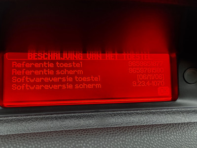

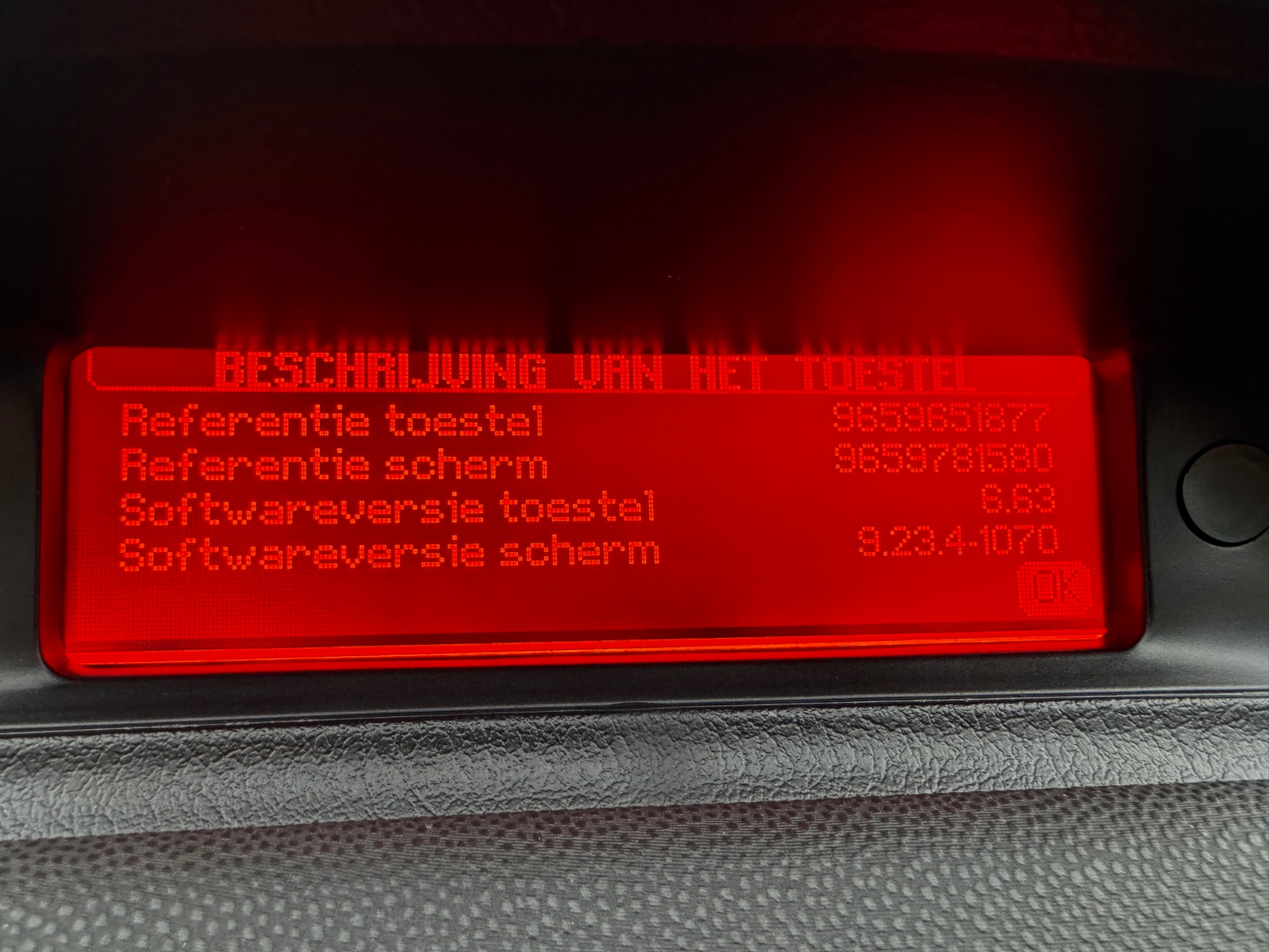

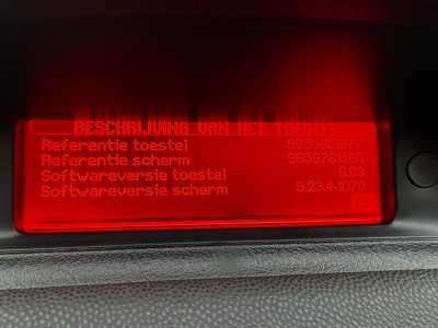

We need to see what system you have: VAN or CAN version as the software is not interchangeable.
See previous posts for the screens that show the current software version you have, as that will determine which version you need to change the language.

Re: Change language RT3
You'll need to provide a screenshot of the current system firmware or advise me of what the version you have is, as these are different depending on the electrical architecture of the vehicle.

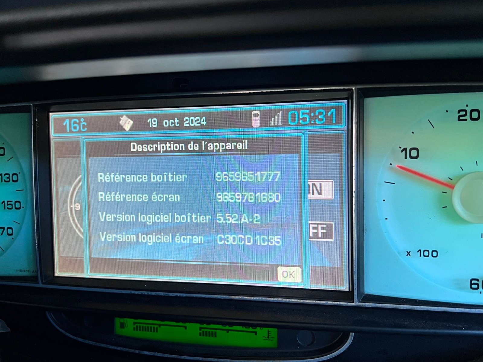

Hello again heres a screen shot
x 6955
@Sandking: Very important, as you have a VAN version of the system and this requires a specific firmware, so link below:
RT3 552-773.rar
You will need to use 7-Zip (make sure you have the latest version) or other utility to extracr the RAR file and create an ISO file that needs burning to a CD-R and finalising before you can use it.
1) Do not burn at more than 4X Burn Speed as this can cause file corruption.
2) Be aware that Windows may not burn the image properly - suggest using Daemon Tools, Nero or another utility.
3) Use a CD-R and finalise the Disc afterwards.
Once you have the CD, when changing the language it will ask you to insert the CD you have just made.

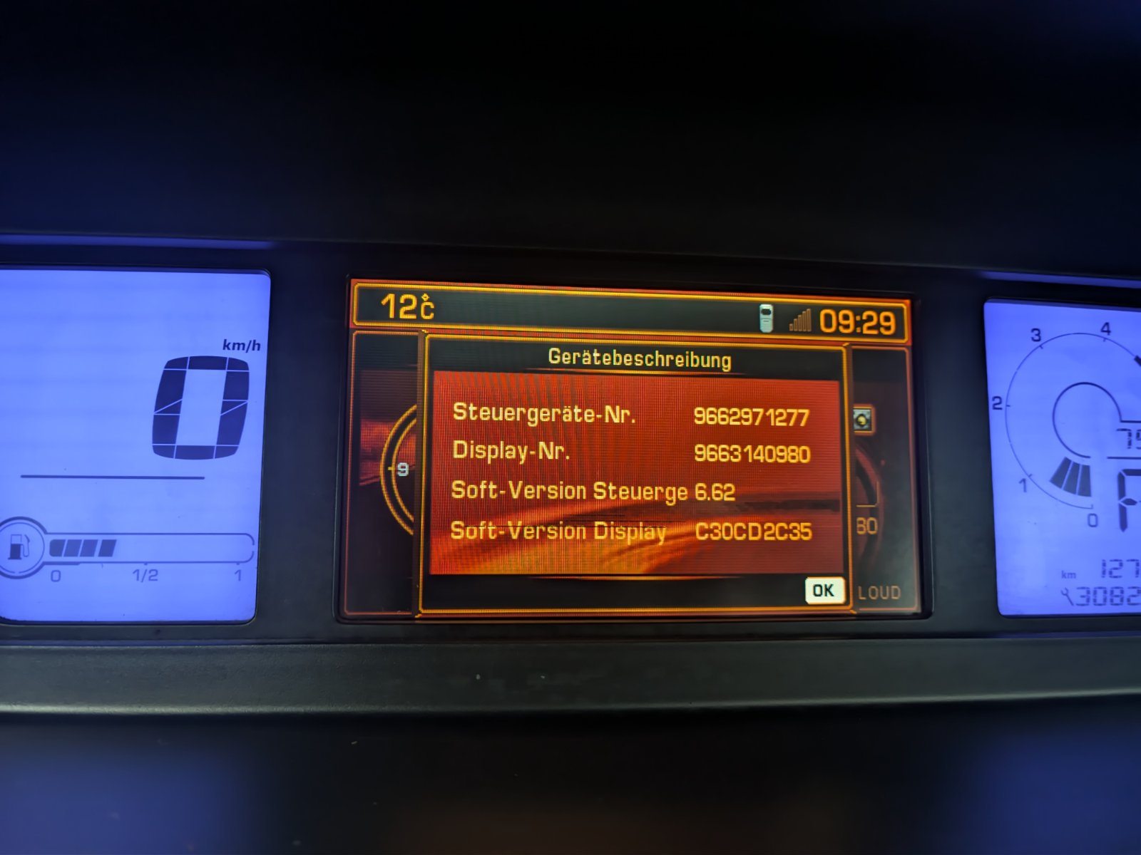

Hello. I would like to change the language to English in Citroen C5.
