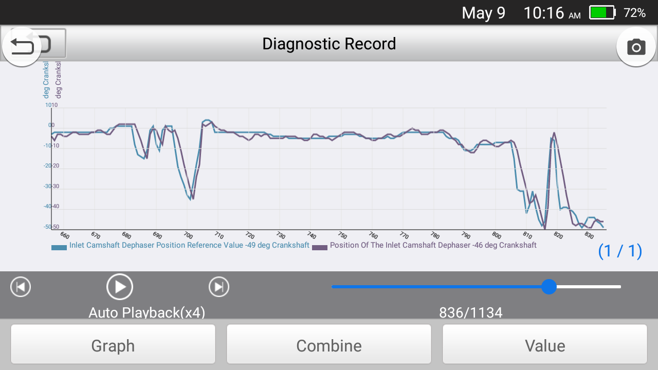

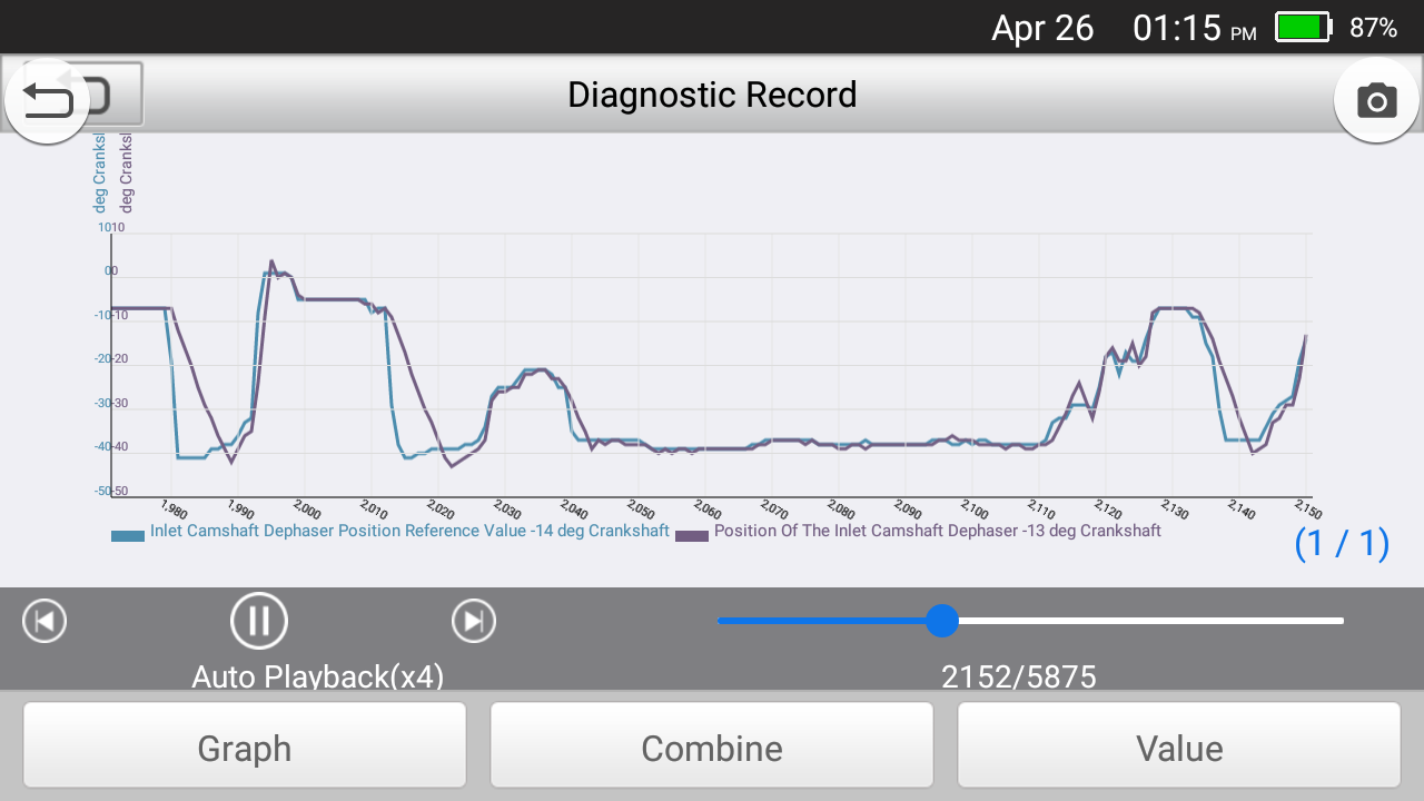

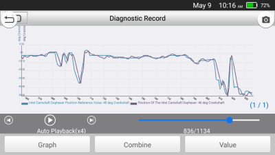

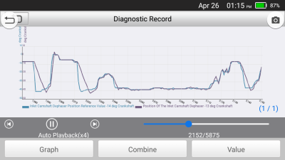

Re: ..was showing a P0016 code, suggesting a timing chain issue.
I found this note on the web: P0016 sets when the ECM detects 8 of the last 10 cam pulses occur during the incorrect crankshaft position.
I had this code with a THP200 engine and it turned out to be a clogged timing control solenoid. The usual methods of cleaning the screens etc did not work, but when I subjected them to severe cleaning in an ultrasonic cleaning bath they have worked fine ever since. Replacing them would have also been a solution.
The way to diagnose this problem is to collect live data comparing the actual valve timing with the reference value dictated by the ECU.
