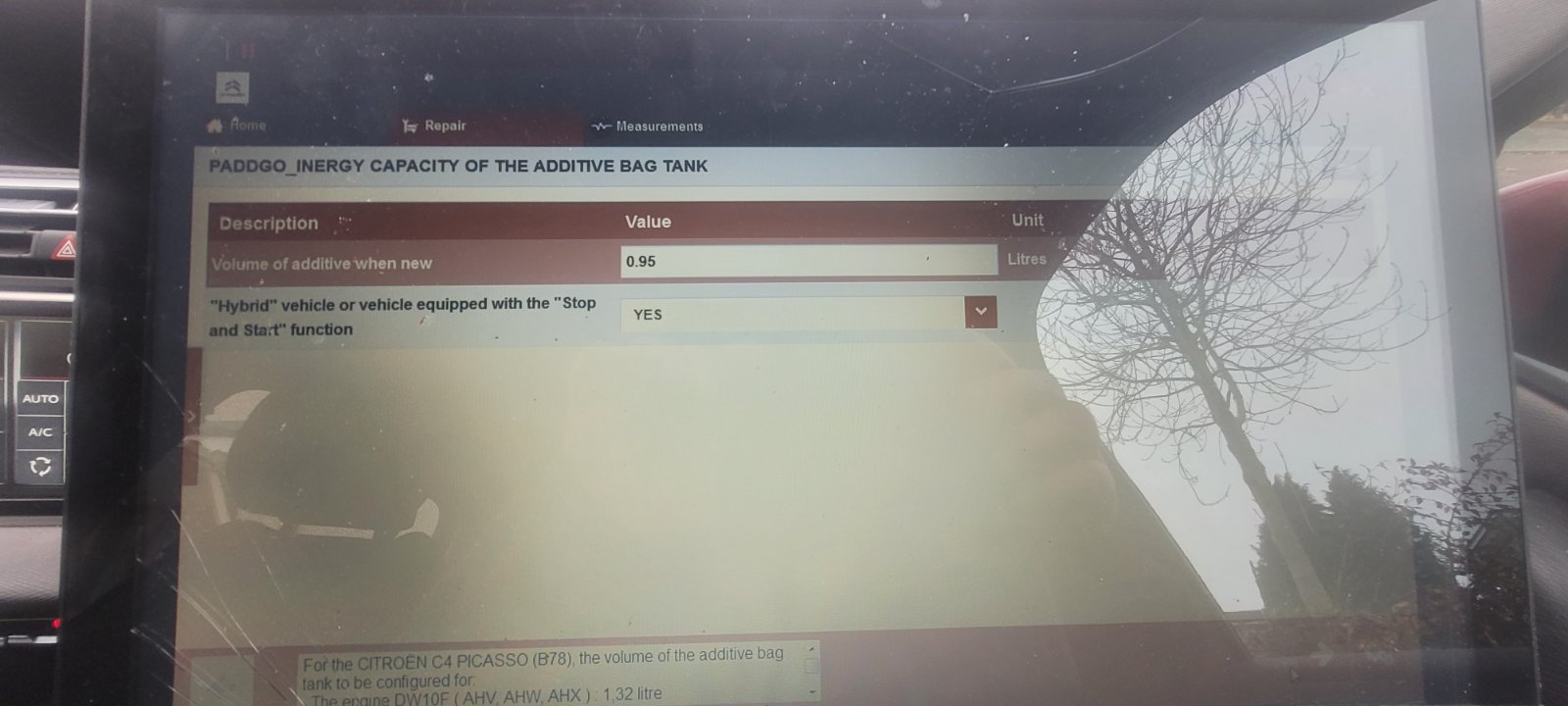

Yeah, I think I went into the wrong menu and told it to configure a new pipe, pump, or tank. It keeps coming up configuration failure.
This is the section I'm talking about. I haven't found anything that is an additive counter other than amounts for the tank capacity.

Don't know if it helps, but in my case (508 Bluehdi) i used 9.186 Diagbox Vmware because i had problems using 9.68 ver. especially when resetting gearbox wear counter.In 9.186 things seems much better when i did a reset in additive tank under ECU menu- emissions control units i think, where i just reset the quantity after fill it with 1 lt. additive fluid.Also i prime the circuit of additive pump aftewards which took about 5 min. All these choices were under ECU menu and "work in emission system" or "work on fuel system" if i remember well.
