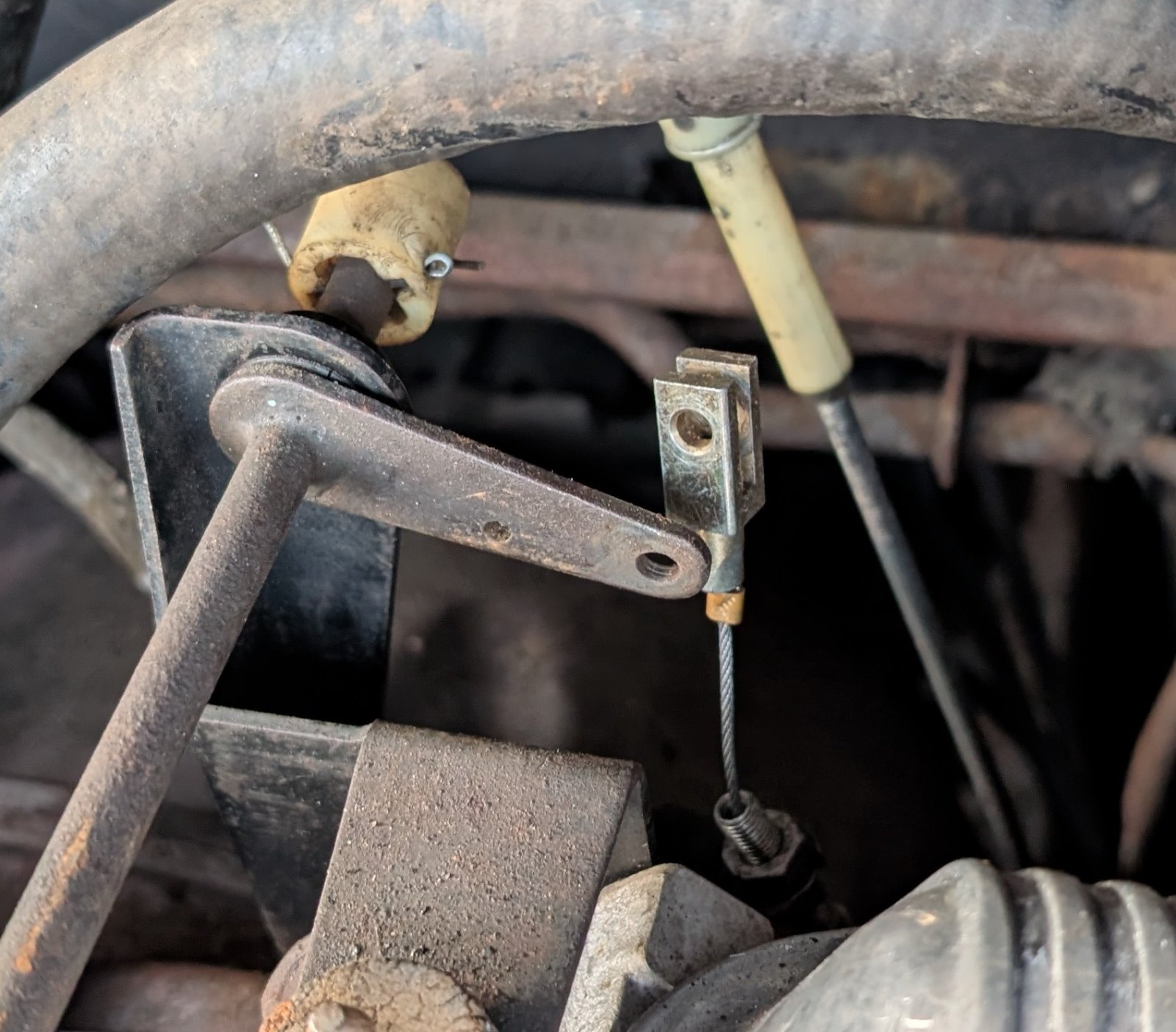

Had another poke around at the kickdown cable on the Rover. I think I've figured out the reason it's been a bit erratic. Someone at some point in the past has kinked the inner cable so it doesn't always return properly when the tension is released - which is going to be why it seems to sometimes hold first gear when you've pulled out of a junction on a light throttle. You could tell something was amiss with the cable as often when you looked at the cable it would be bundled up outside the top of the ferrule. I've done what I can to flatten out the kink and lubricate the cable and it seems to be behaving a lot better now though I've not had a chance to do a test run yet. I've also replaced the random bolt I was holding it on with before as even with a locknut on I'd already lost the bolt twice.
I honestly don't know what type of fastener should be in here as it was totally missing when I got the car, but for now we've gone with "comedically oversized R clip."
It looks ridiculous, but it's not going anywhere nor does it catch on anything, so it will be fine until I find what should actually be in there.
I'm not actually sure which of the two holes in that arm the kickdown cable should be attached to - I went with the outer one as that is the one which had witness marks on to suggest it had been used before. Though it doesn't pull the cable straight. However the other hole in the arm also pulls the cable at an angle in the other direction, so neither looks to be perfect.

Kinky Bowden cables can cause all sorts of problems Zel :twisted:
The thing you need to replace the big 'R' Clip is a Clevis Pin.
Something like this...
Then a little 'R' Clip or more traditionally, a split-pin through the hole to secure it...

The kickdown cable should have a clevis pin with a small split pin. It is probably the same size as commonly used on handbrake cables of the period.
Typically with those transmissions the cable is adjusted so that under very light acceleration the transmission changes up to 3rd gear just below 30MPH.
Using the inner hole would reduce the kickdown effect at high throttle and make things a bit more sedate, which may have suited a typical Rover driver.

Thanks. It was one of those cases where I knew the thing I needed but my brain was utterly determined that I would be able to name every type of connector you could use in situations like this *except* the correct one. It was bugging me all evening yesterday.
Pretty sure I've got the cable connected in the right place, the hole that's further to the offside of the car is far smaller and would need a different type of connection I'd think. I wonder if that might be used as an actuation point for a cruise control assembly? I think it was a rare option but was something you could specify from the factory.
Most likely I'm a long way off the mark and it's just meant to have a return spring there or something like that. The throttle mechanism on this car is absurdly complex, and the number of pivots and couplings involved means there's about an inch of free play at the pedal before anything actually moves at the throttle plates on the carbs. Why they couldn't have used used a cable I don't know!

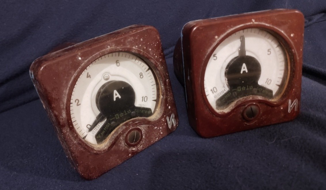

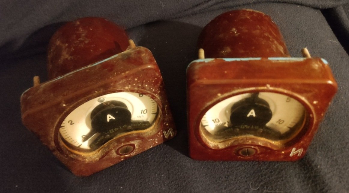

Here's a couple of 'leccy meters of slightly unusual origin. They came from the power room of a Soviet nuclear weapons store :shock: They are probably, quite literally, bomb proof :lol:
Sov electricity meter - own work
Chunky Sov electricity meters - own work
