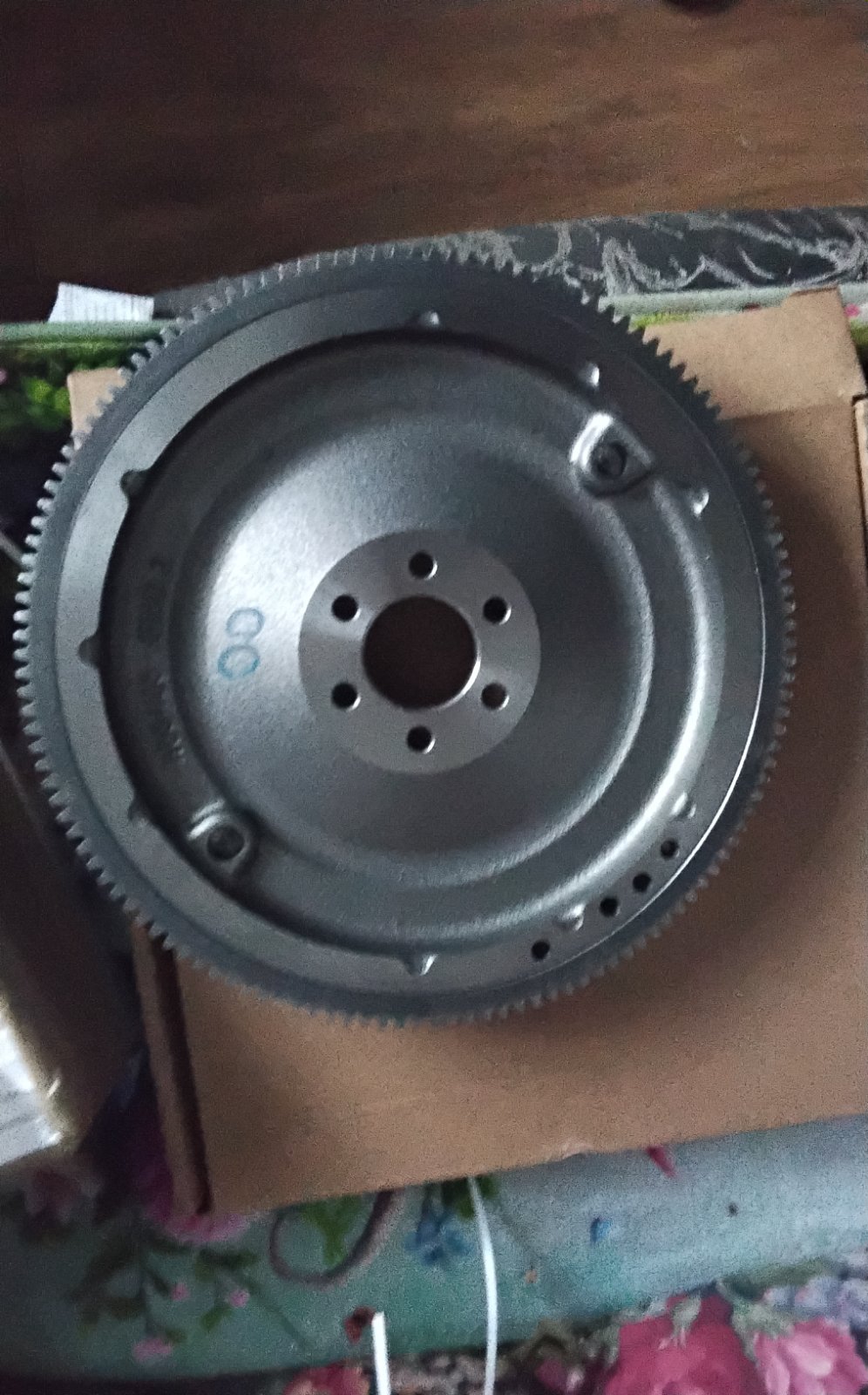

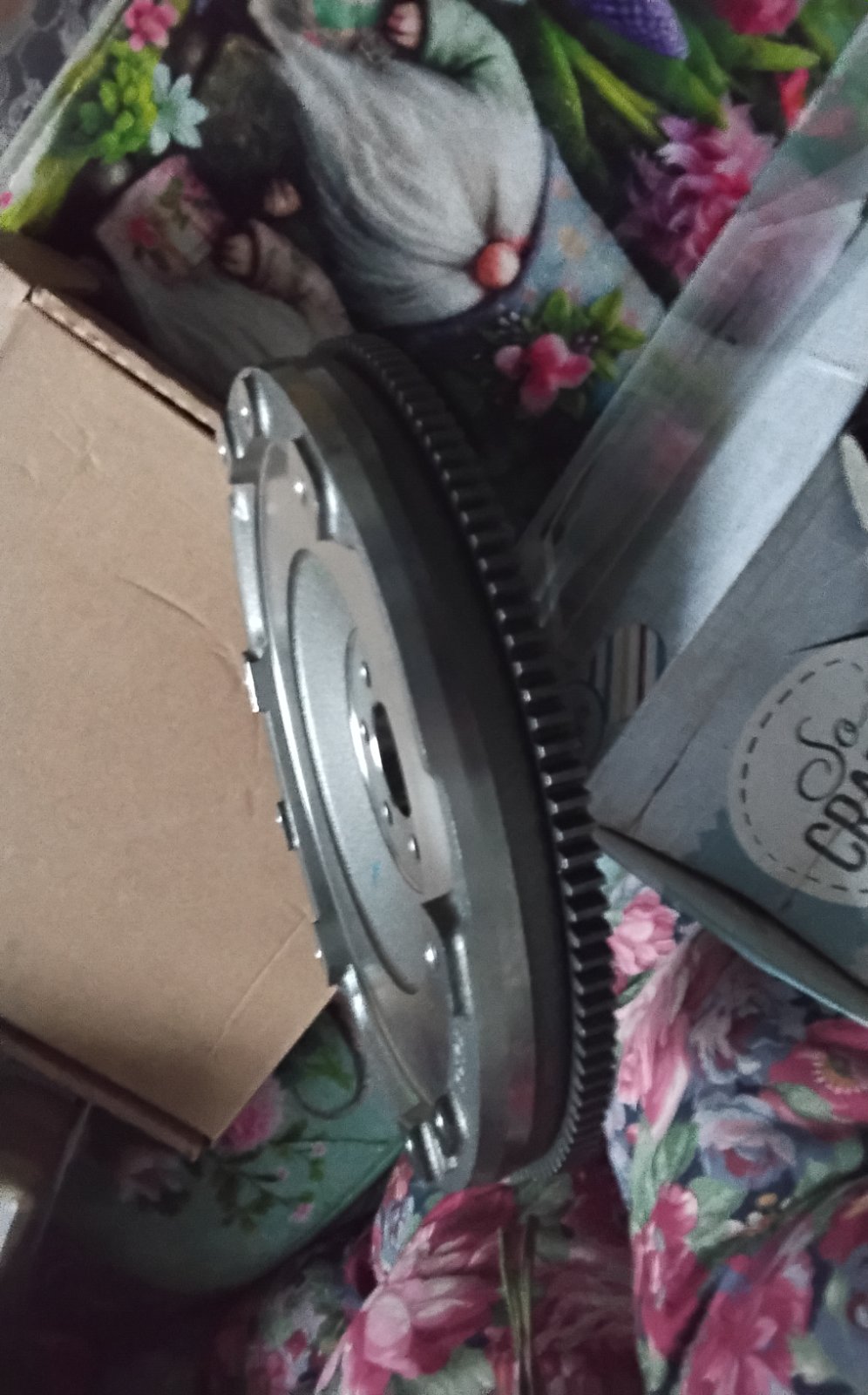

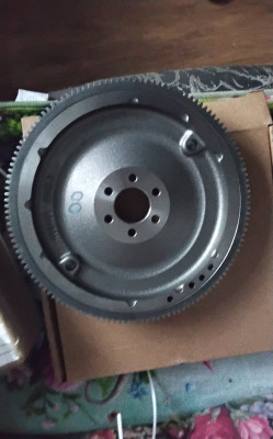

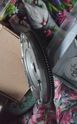

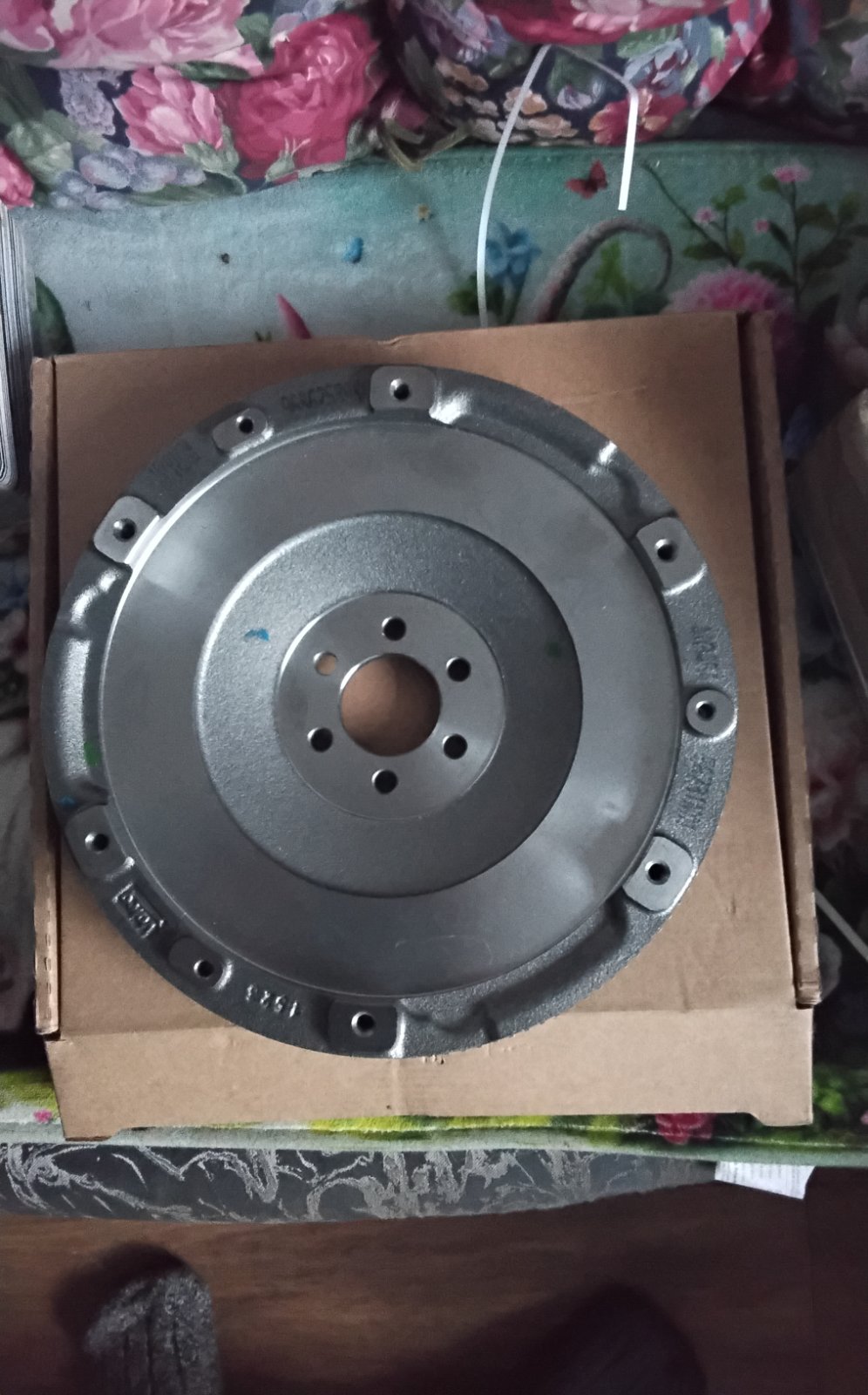

Ok so the flywheel took 16 hours to arrive its an OEM part & was confirmed by the company that make them for GSA. As you can see its single.
There is a post online somewhere i found that said by an owner of same car as mime that 1.6hdi 90 is single (solid) flywheel, this part had the number 532T2.
More to follow, the wheels of repair slowly turn

A thing of beauty Husky :D

Yes my socks are ok lol, no the work that goes into making these flywheels is amazing .
