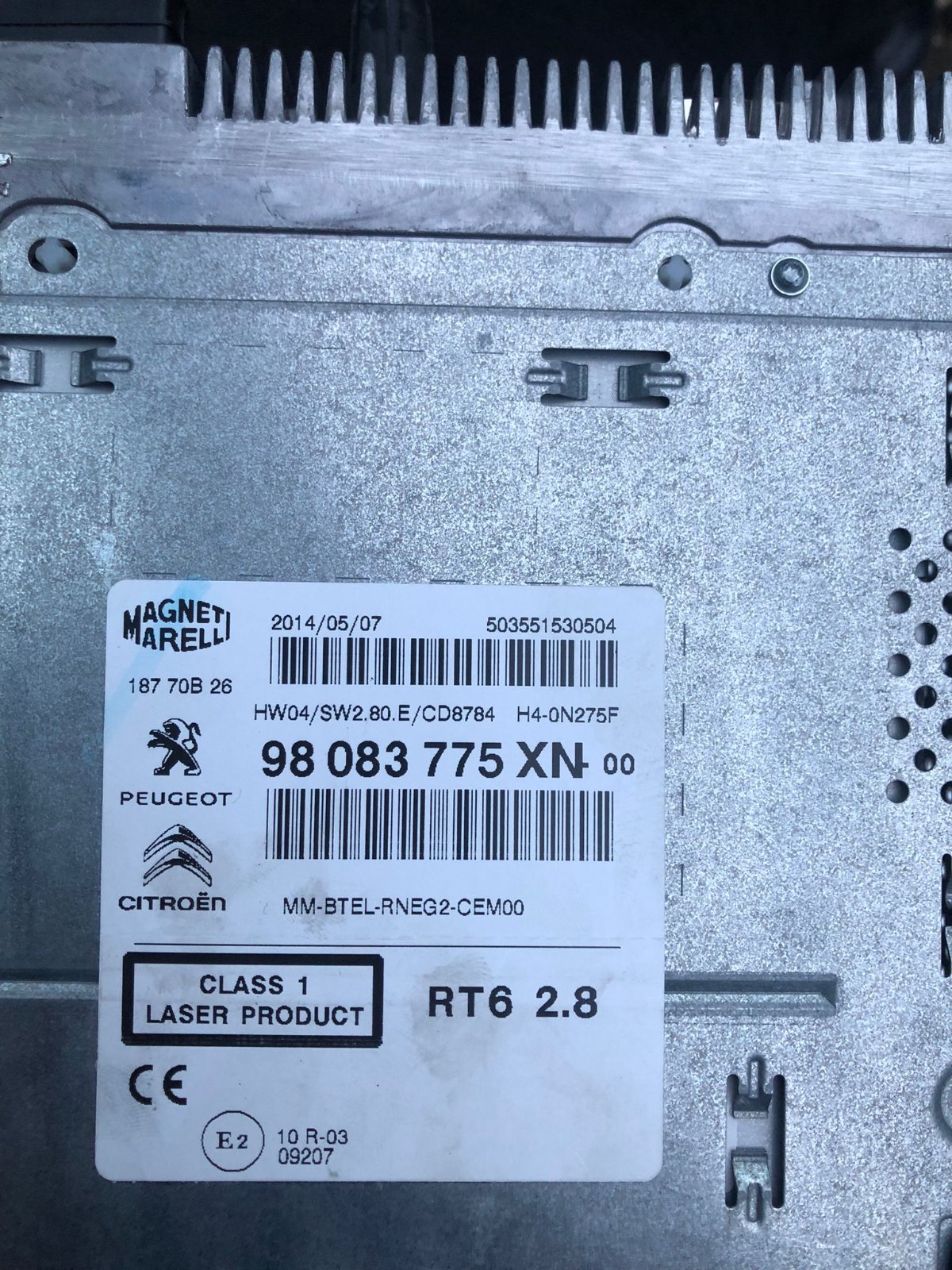

Long story short, i found this forum as the screen in my RCZ went blank and i lost the radio as well. A few mechanics couldn't find any faults but eventually I found a very savvy one that told me the SD card could have failed.
My plan of action was to use data recovery and clone/ write a dsk image of the SD and copy it to a new one and just install it back into the radio. I examined the original SD file on the computer as it seems to be working fine?
Context, my problems started after getting a new battery install at Halfords. The problem with the screen and radio started after this. Also my MPH display is now in KMH. I have tested all the fuses in the car, the motherboard of the radio, everything is working fine so my last option was the SD card. Now, I have no idea how to code or anything so I have a few questions please.
Has my act of checking out the card on the laptop rendered it useless? Will I be able to install a new blank sd card into the car and use the USB to install new firmware despite having no display? Also where can I find the firmware, it was 2.80 as stated on the radio. Google isnt being my friend on the matter.
Thank you for your help, this experience has been quite frustrating to say the least.
Edit: added pic of radio and read through this mammoth thread. I still have a glimmer of hope but wow I think am f#@&ed

HiKaledonian wrote: 12 Nov 2024, 23:16 Hello board
Once you insert the MicroSD card into a windows PC it will write hidden / system files to the card - not a good idea. The Head units use a special variation of UNIX-based automotive software. Further, if you attempt to clone the MocroSD card, and it has issues with file corruption, you will just be cloning the problem to the new card....
First, avoid Halfords for anything - they most likely don't have the training on how to work on modern electrical systems and specifically the routines required when disconnecting and reconnecting the battery.
Have you already attempted to install firmware yourself? This sound like somebody has already attempted a firmware upgrade and this has reset the RT6 to factory defaults - i.e. unconfigured.
You can try a BSI Reset / Battery Disconnect / Reconnect Procedure first, which won't cost anything except time and patience.
Failing that there's little you can do without a display, as you can't update the firmware without replying to options. Also you won't be able to back up your user data / configuration at this point without a functioning screen using the Part A Mirascripts in my guide.
I'm not sure where you go with this now as your options are extremely limited without a display. Did this happen immediately after you had the car back from Halfords or since? If the screen was blank after picking it up, I would be blaming something they have done or not done.... Too much of a coincidence.
I would suggest a Diagnostic with Diagbox to see what that says about any faults or comms issues with the head unit or display.
