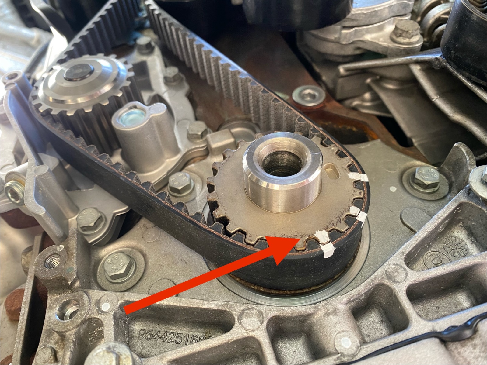

Here below are marks on crankshaft sprocket and belt:
Once new belt installed all marks on sprocket and new belt were matching with the old one. After these 4 rotations required, my marks on new belt and sprockets are not matching. New belt has the same number of teeth like the old belt, I don’t remember if it’s 116 or 117 teeth.

Camshaft was secured as in your 1st attached photo. Crankshaft was secured with safety pin on flywheel side. Photo below shows camshaft sprocket marks and marks on belt:
