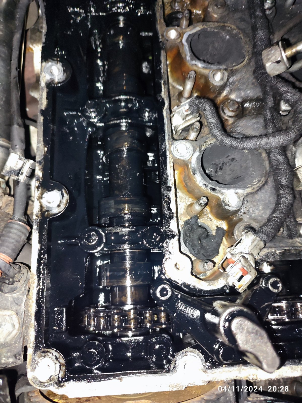

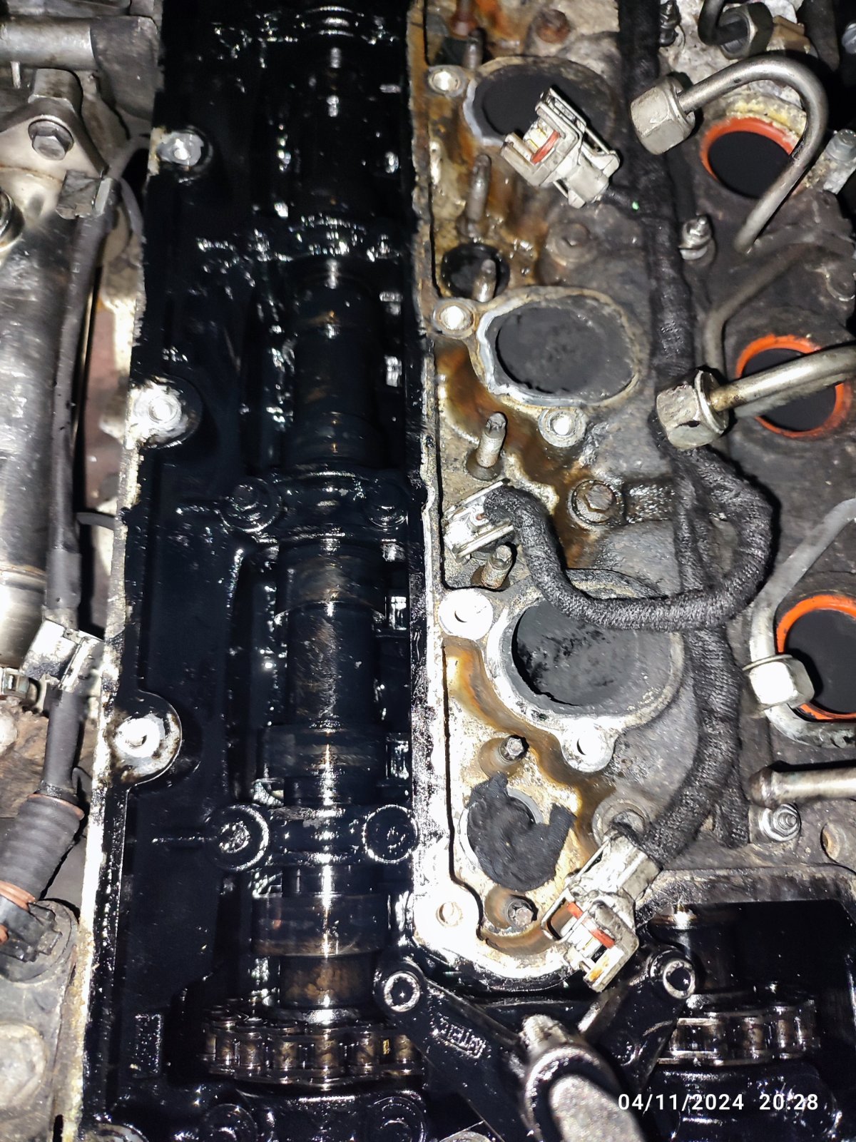

I had to pull the intake plenum off the replacement engine to put in the injectors loom and discovered this I think it is just the beginning of sludge and from the engine just sitting for what I think might be years but I am not sure any opinions.

Doesn't look "freshly serviced" but I guess most scrapyard engines are similar. I'd probably wipe off what I could get at (even if just placebo effect, it'd definitely make me feel better doing so!) whilst you've got access.
Beyond that I'd not worry too much and perhaps treat it to fairly short interval oil changes once up and running

Hi Matt, my thoughts exactly, I'm not pulling the valve cover anyway. I had put the intake plenum back on but now I've just discovered it has the wrong fuel rail so will have to swap it across as well. Which means removing the loom and intake plenum again. 2 steps forward and 10 steps back. Well better now than after I fit the engine.

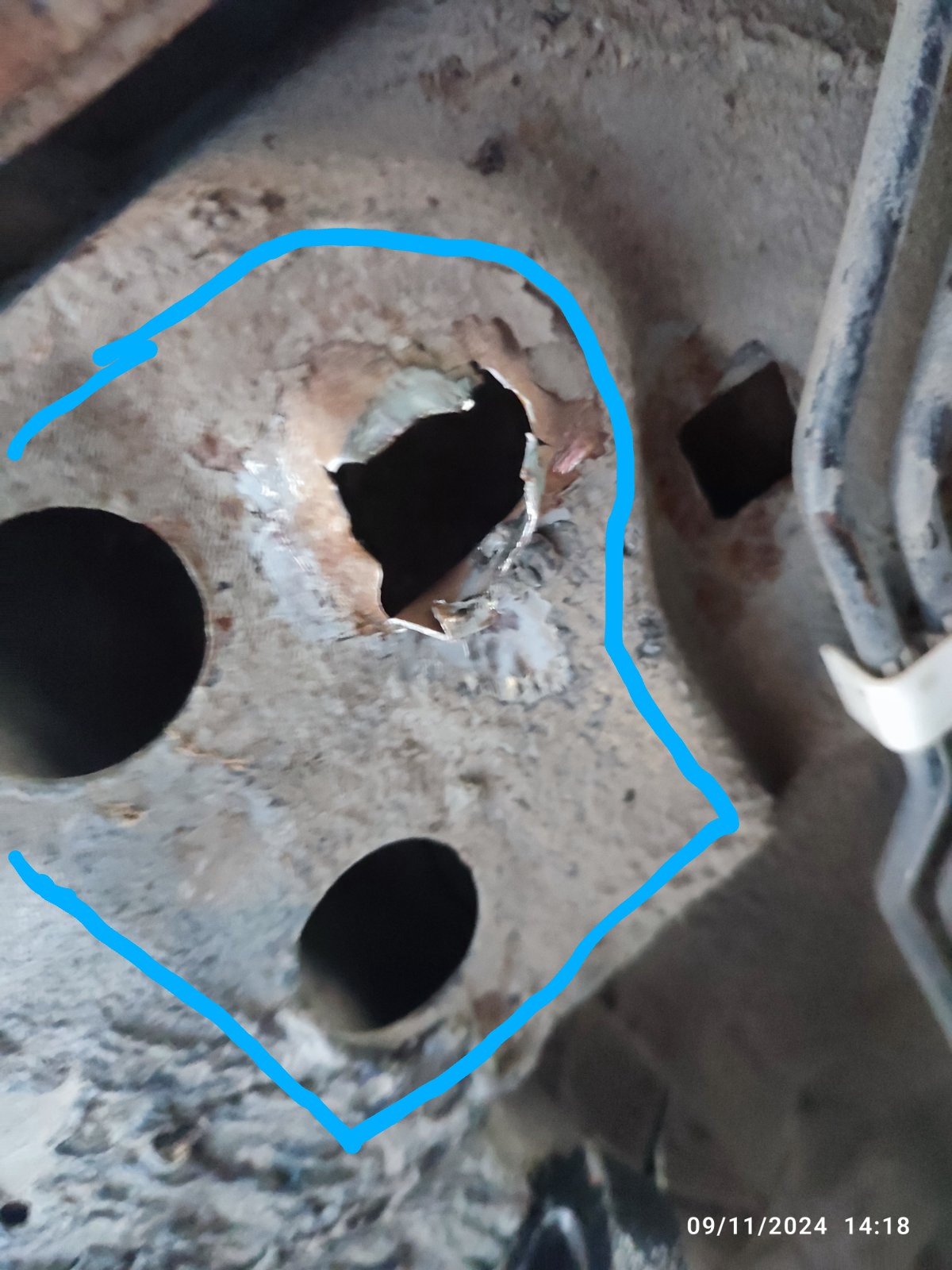

I was supposed to do the rearmost front subframe bushes on the wife's old tiida and one of the bolts ripped a lump of steel from the body when I went to remove it. Seized solid. Horrible day with cars. I need to get some suitable sheet steel and fabricate a new section. I want to sell it on. It doesn't support the weight of the car at that position it's more of a locating bolt for the subframe locating bracket.. I want to inspect it further to make sure it is safe to repair.Hopefully, I think the area will be ok once it's replaced any opinions..

Tilda - the steel looks very thin! I would think you could hammer it flat then weld on a simple plate - guess with a captive nut welded on the top surface?? - be tempted to make the plate nice and big, plenty of weld length to take the strain. Suppose second question is around if it's worth your time? I don't know the going rate for Tildas but if you are planning to get rid anyway - worth weighing up what it's worth fixed Vs off to the scrap man. I'm too sentimental about cars - don't be daft like me!

Big plate, something like this:
A bit of "CAD" (cardboard aided design) would sort that silly round bit's shape

It's worth about a grand here or 150 to the scrapper. I was thinking the same little plate should do the trick. The steel is very light on them, surprisingly light in fact. Bloody awful rubbish in them. The problem is it has fuel lines running beside it plastic ones at that.So I have to figure out how I am going to shield them as well.I was supposed to be driving it for a while until the C5 is back up and running and because of this the Primera is back out of retirement. It's great to have such a reliable yolk to fall back on. I had actually planned to scrap it but I can't now. I get seriously attached to cars I think all on here have this problem.

Love the CAD analogyMattBLancs wrote: 11 Nov 2024, 07:29 Big plate, something like this:
I think egg shells are thicker.
