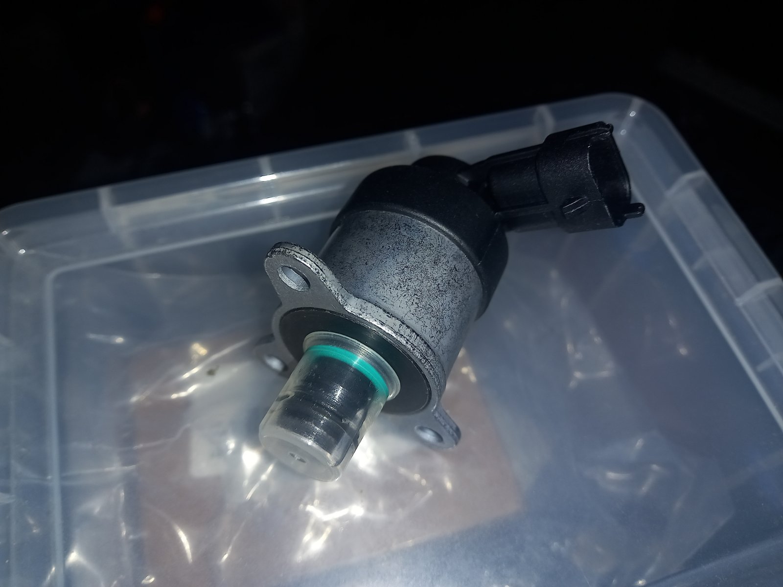

I'm suspecting I have a faulty fuel pressure regulator (DV6TED4 HZ engine)
The actuator test in Diagbox says to touch the regulator and feel it vibrate.
Mine does nothing but I can hear (but not feel) a click on an off while the actuator test is running.
Is this correct or have I actually found the smoking gun?
Fuel pressure regulator 1.6 HDi

Re: Fuel pressure regulator 1.6 HDi
Update: just run the same test on my partner's DV6D HP engine and I can't hear the vibrate either (I don't actually know where the regulator is on this one). But... it doesn't click...
https://www.ebay.co.uk/itm/254429177549
It looks like this and is located on the high pressure pump.

freddyokel
- Posts: 84
- Joined: 29 Dec 2023, 17:51
- x 6
Yeah, I've got a spare.
Just wondered if it was actually supposed to vibrate when you ran the test in Diagbox.
If it wasn't such an utter <insert word here> to access I'd have just swapped it out.
