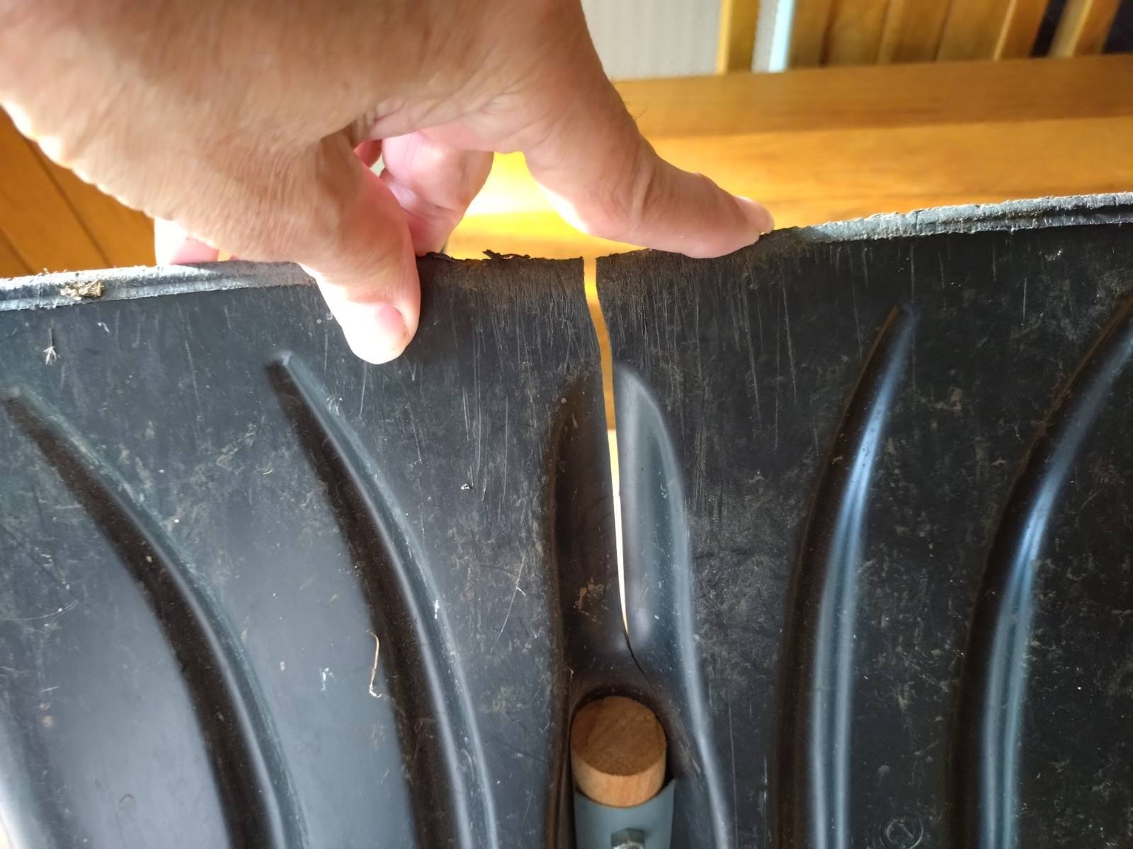

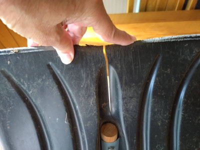

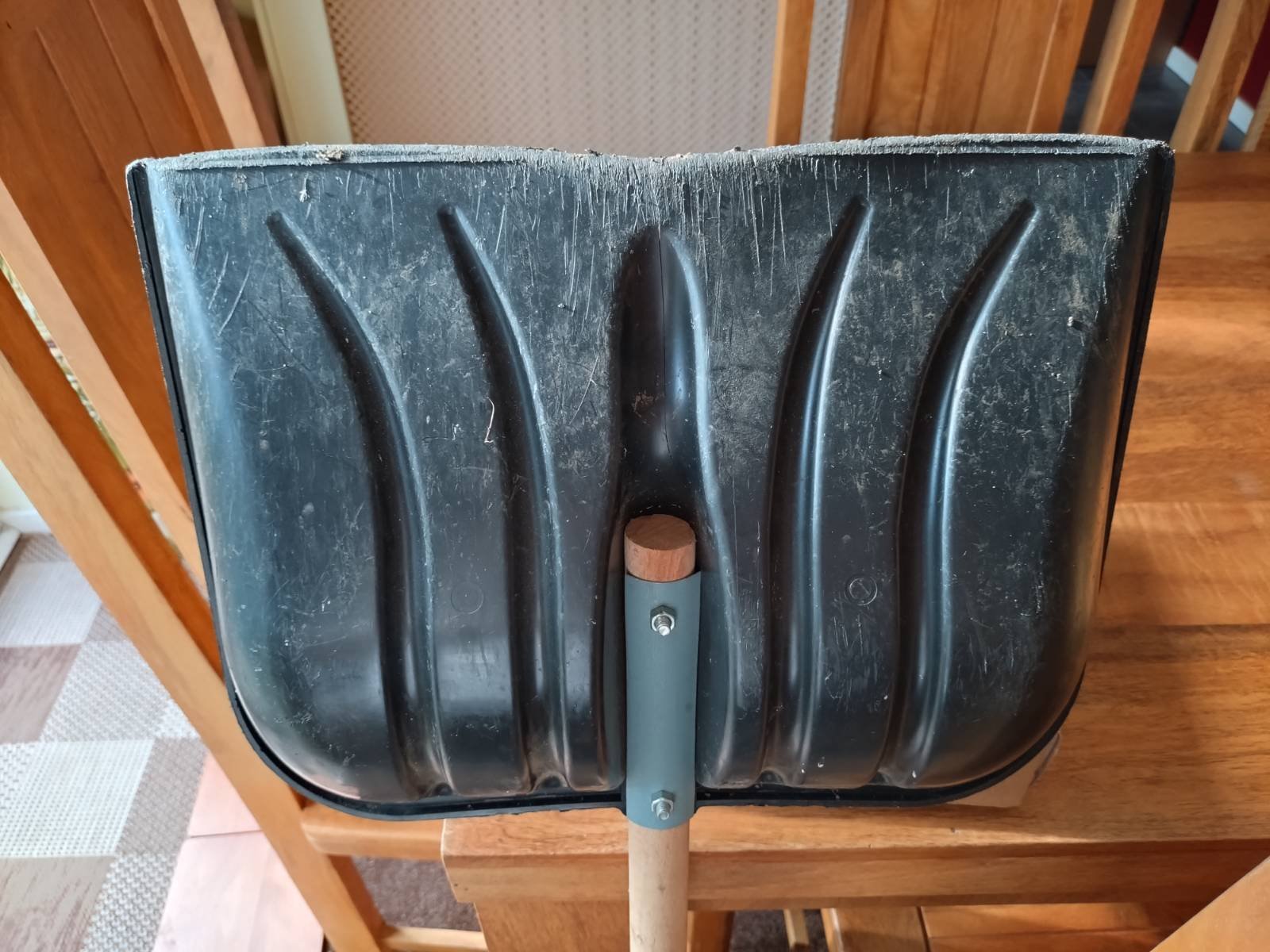

Another little job came on the radar when I swept up the first big downfall of leaves in the garden yesterday. I use the snow shovel to get them into the bin so I noticed it seemed a bit 'floppy' when I was using it:
Close examination revealed a crack:

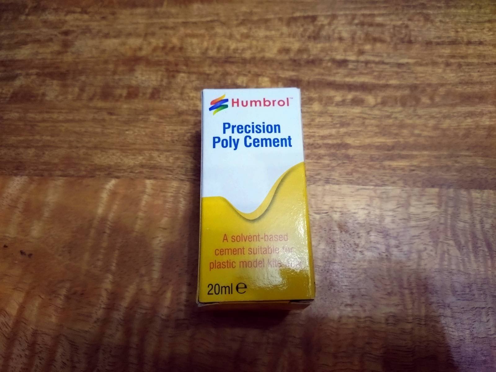

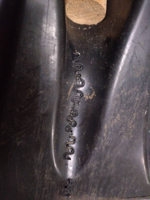

Aha I thought a job for my newly acquired polystyrene cement:

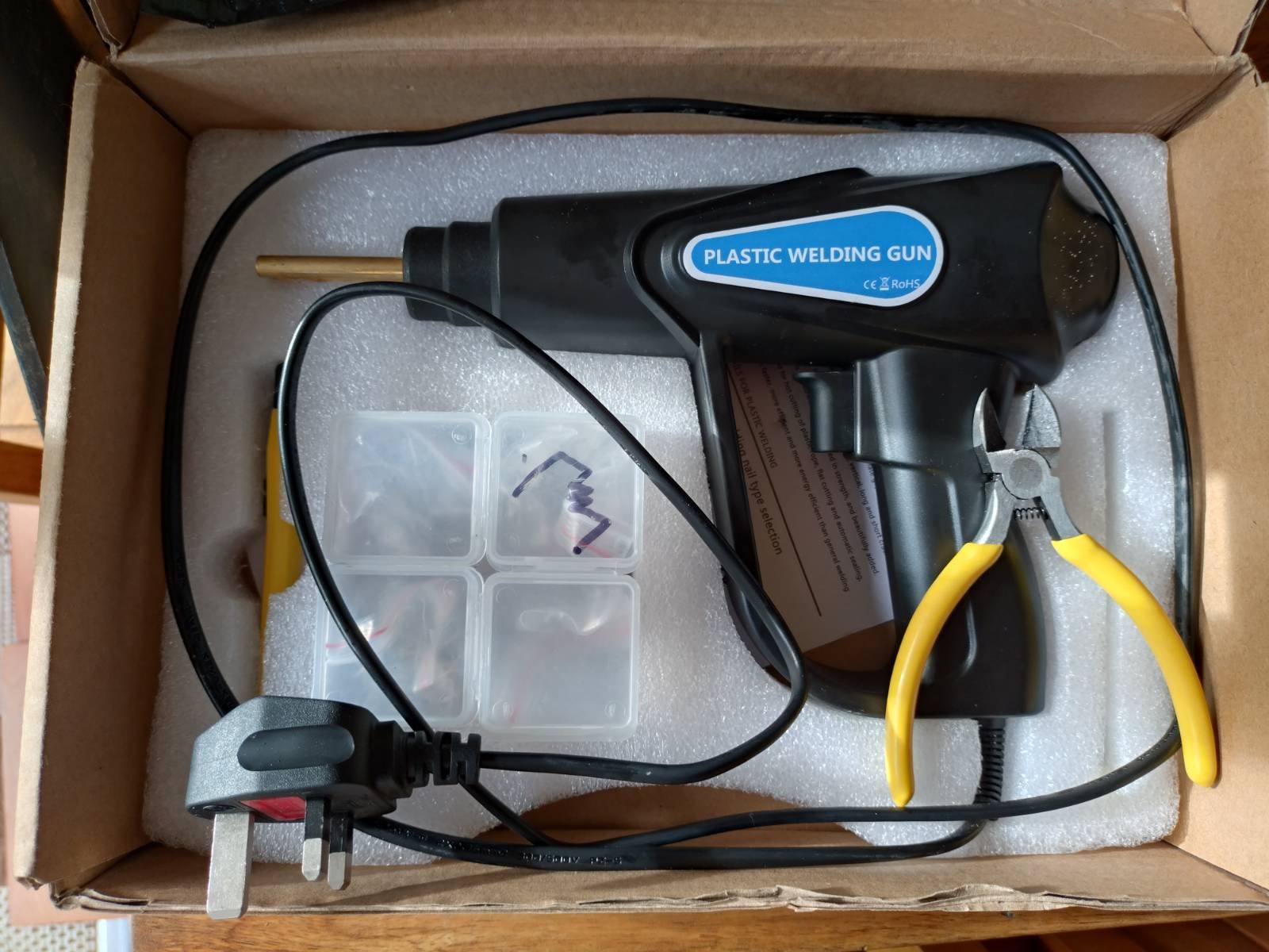

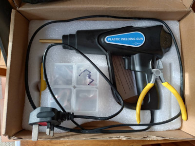

Then I decided that my other recent acquisition may well be useful too:

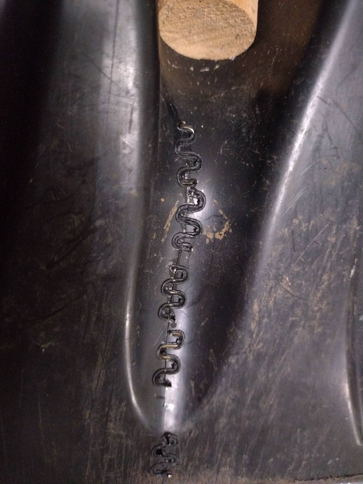

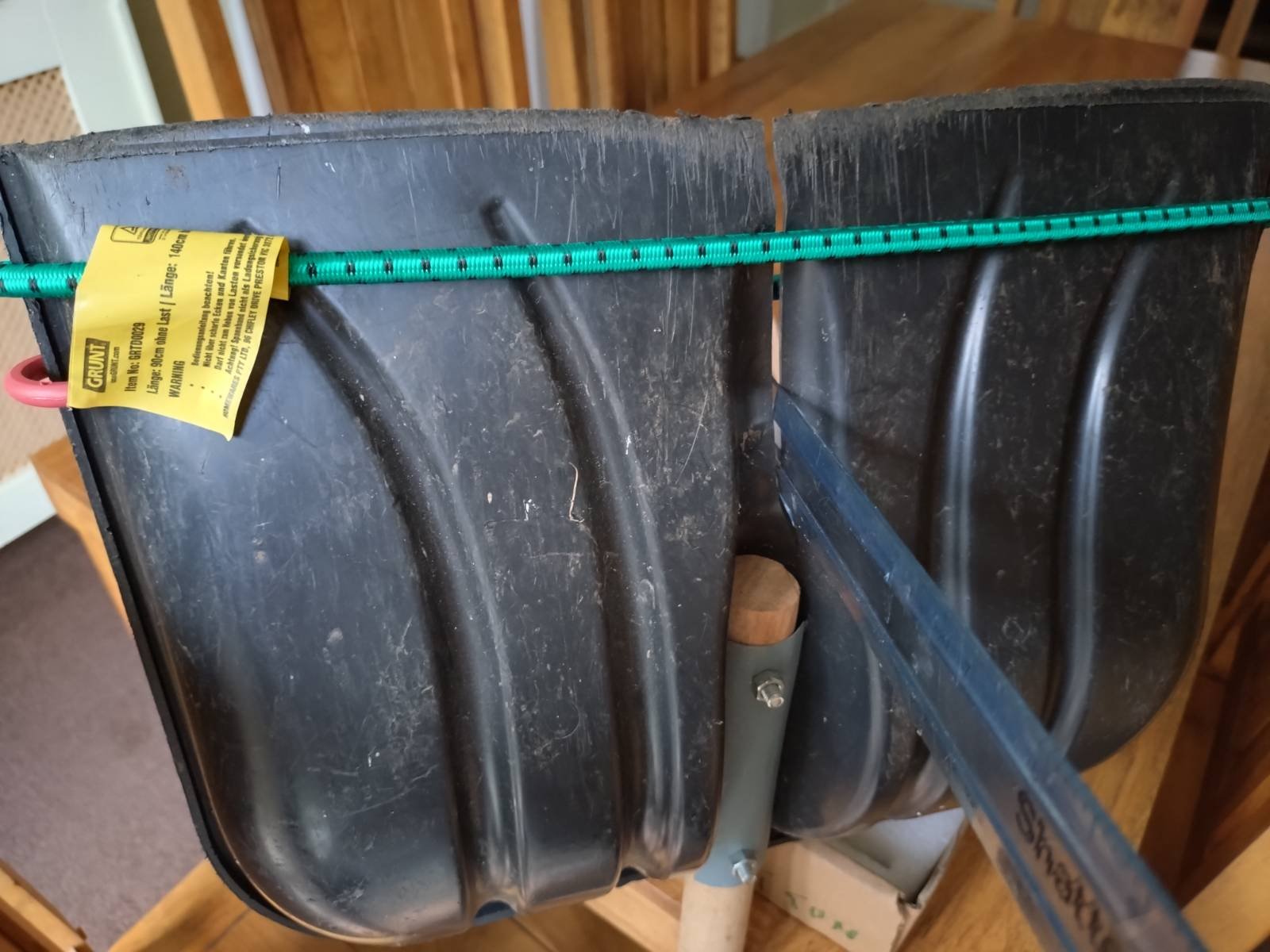

So I opened the crack to allow me to smear the cement along one side and then be held together by the bungee while I inserted the staples:
Finally I clipped off the ends and the job's a goodun'!!

I used to be an avid model builder and I refuse to use humbrol poly cement, it's bliming useless imo. Plastic Weld is way better, dries super quick.

That's interesting Ryan, I am the exact opposite, I prefer Humbrol cos I find it gives more time to adjust the joint before it starts setting!!

If I needed to use any poly glue then I used Revell, wasn't as 'stringy' and dried in 15mins if not over used. But plastic Weld is the one for me as it melts the plastic into each other. But being in a shed maybe the fumes got to me

And there lies its problem.....it can skin over deep joints and keep melting the plastic "internally", this gives the deep joints that then need filling to get a good finish....or worse still a big sink that will need a large correction (if you are a muppet.......I was with one kitRp0thejester wrote: 22 Oct 2024, 21:49 If I needed to use any poly glue then I used Revell, wasn't as 'stringy' and dried in 15mins if not over used. But plastic Weld is the one for me as it melts the plastic into each other. But being in a shed maybe the fumes got to me![]()
I tend to use the TAMIYA Extra Liquid Glue.

I would never use plastic Weld on an wide gap, as a seam joiner it works perfectly, personally I use it to 'tack' the 2 parts together, if not correct then plastic Weld on the first tacks release it from each other. I like that adaptability. If everything is okay then use on the seam. I have found it really useful on things that have a huge gap by filling it with poly card, weld each side and file down. (Major off topic) I'm not a fan of Tamiya or Hasegawa, shake and bakes imo

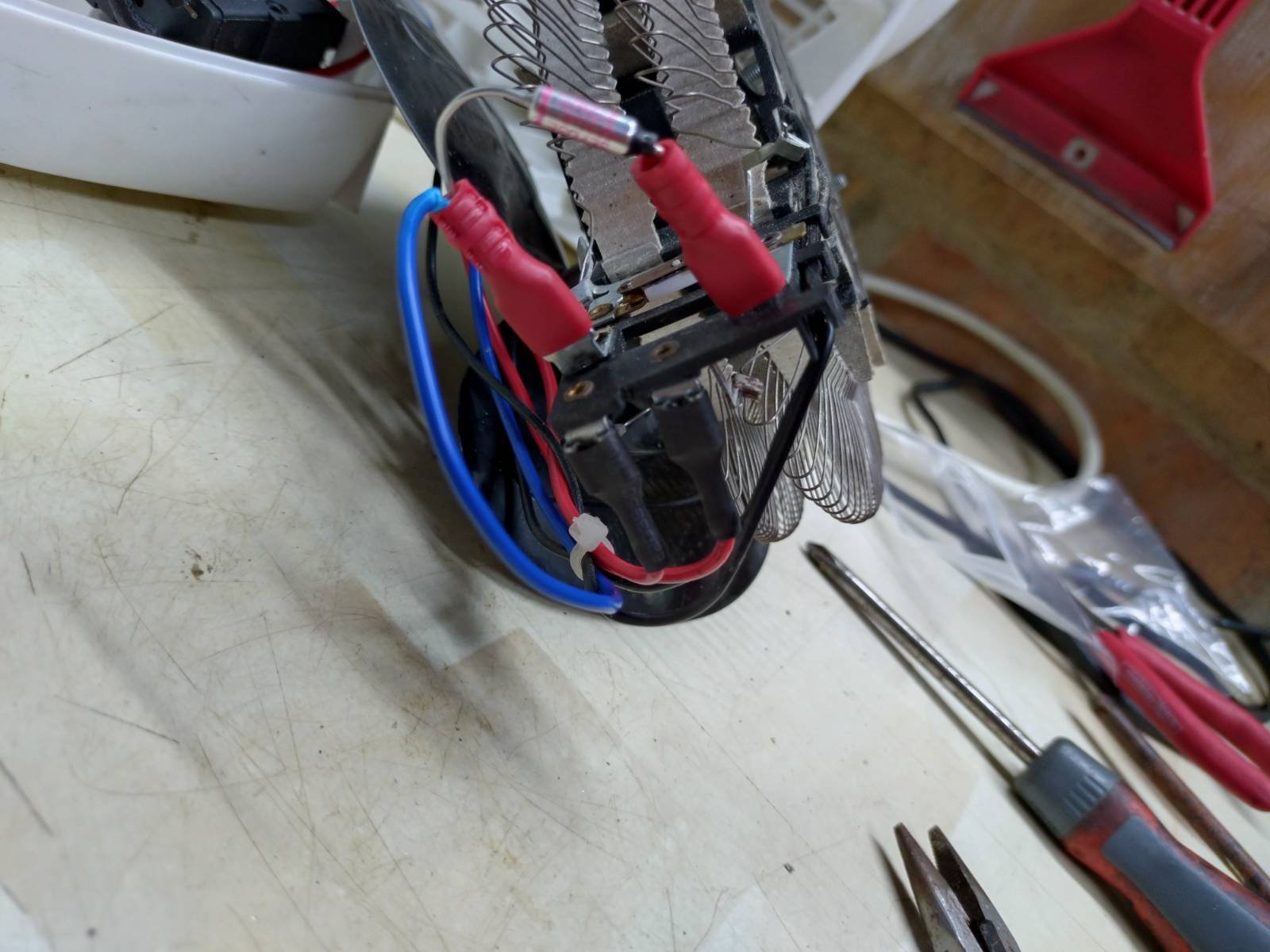

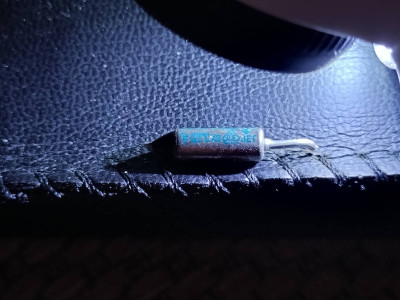

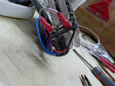

I went into the garage last week during the afternoon 'ventilation hour' which is the hour that my fan heater and extractor fans run to maintain the dry roof from the condensation issue. Unfortunately I realised that the fan heater had fallen onto its back and was blowing cold air so I decided to investigate. After stripping it down I discovered the thermal fuse had blown, presumably as a result of the intake being blocked when it fell over, and thus prevented a nasty burning possibility.

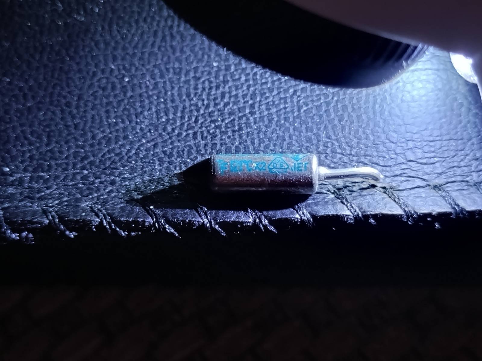

I ordered a new fuse and this morning set about installing it. Obviously you cannot solder it into place as it is calibrated at 121ºC as you can see here on the old one if you zoom in:

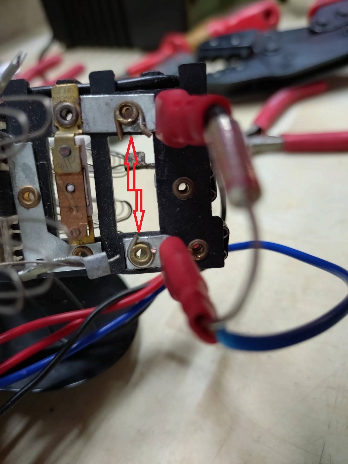

It did get me thinking as the original fuse had been riveted in place as shown here by the red arrows:
I did not want to drill out and re rivet as the elements are very close and it would probably have ended in disaster!!
So I settled for this work around and it is working fine!! (I also fitted a higher rated fuse as it was all that I could get but still well below 451ºF
Back in situ now with a strap to stop it happening again!!
